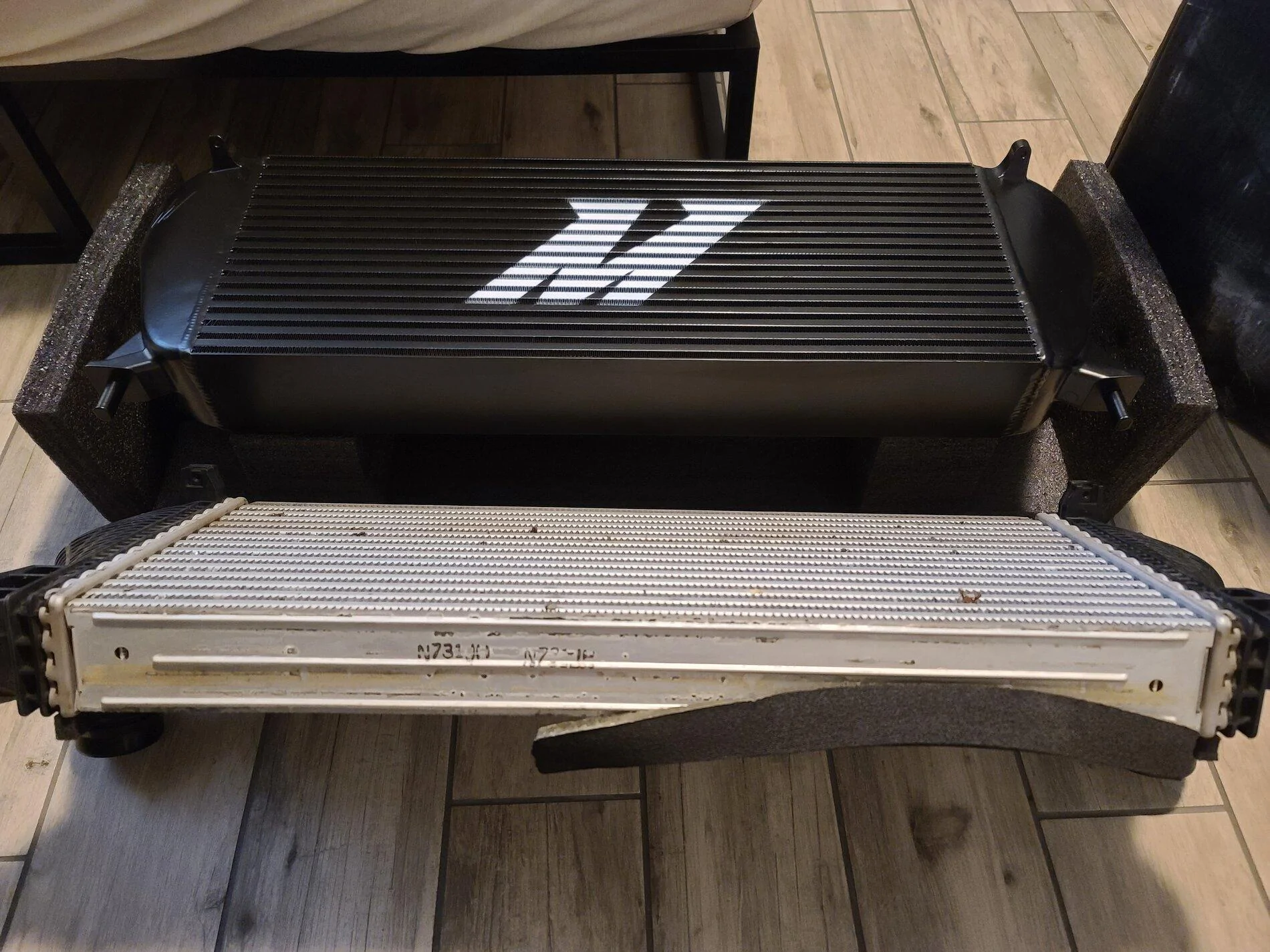

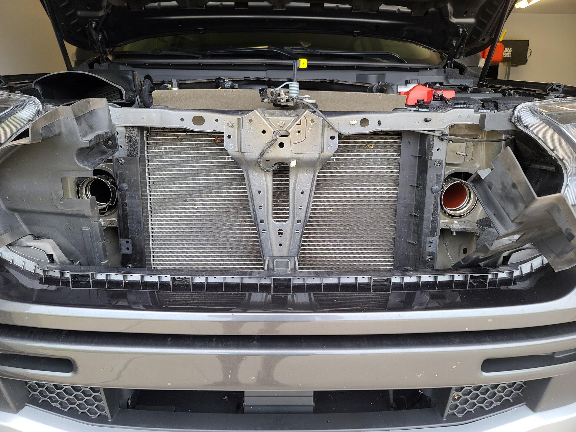

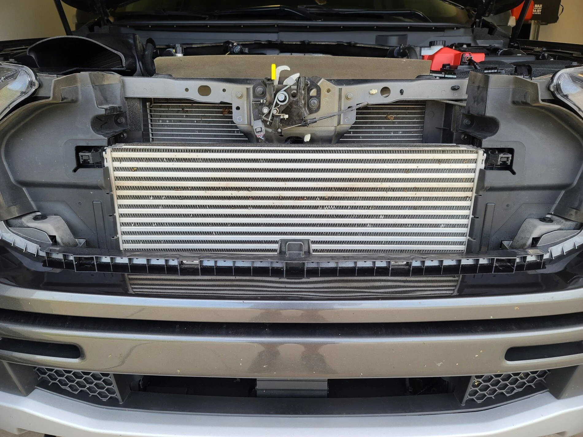

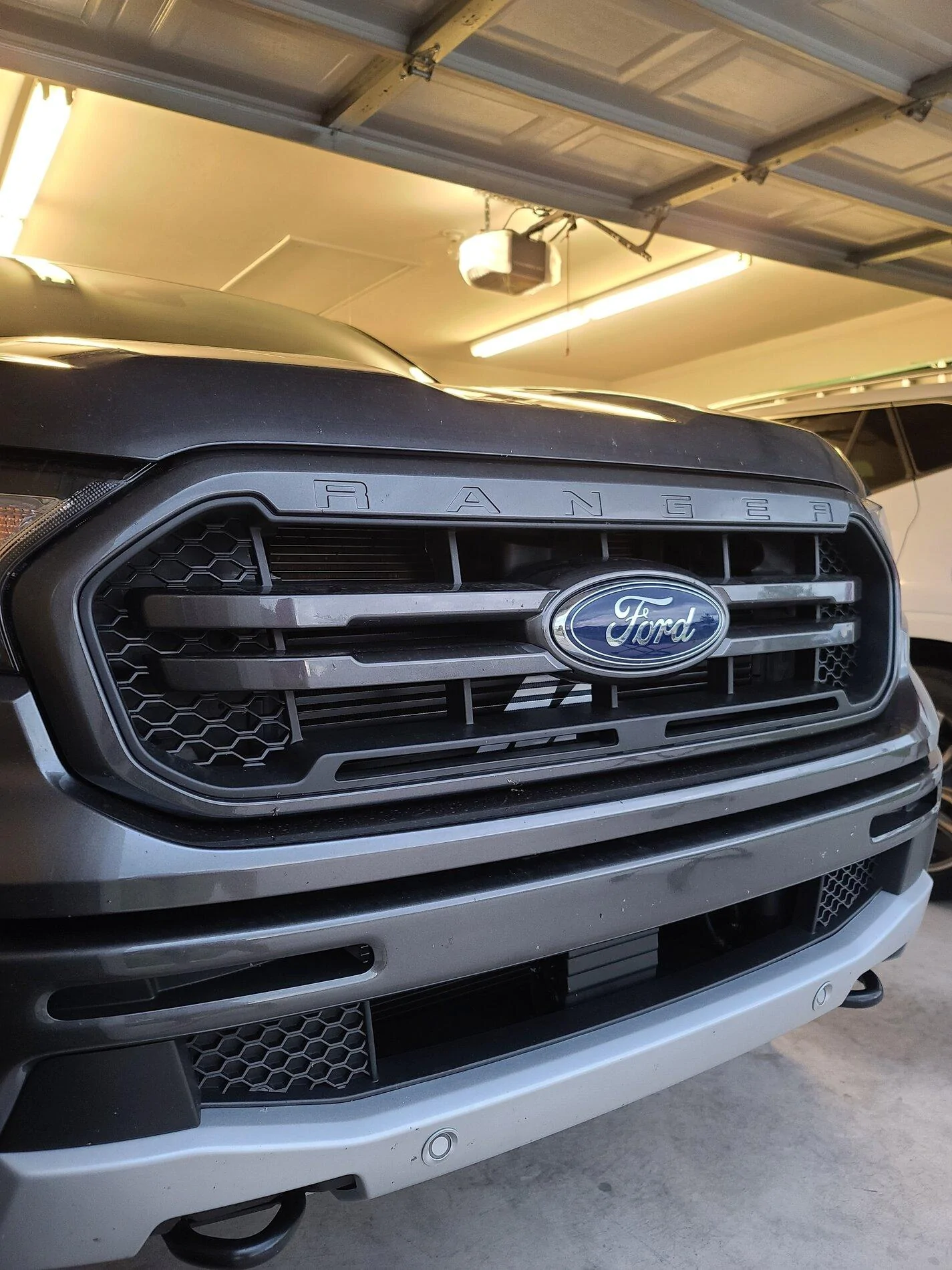

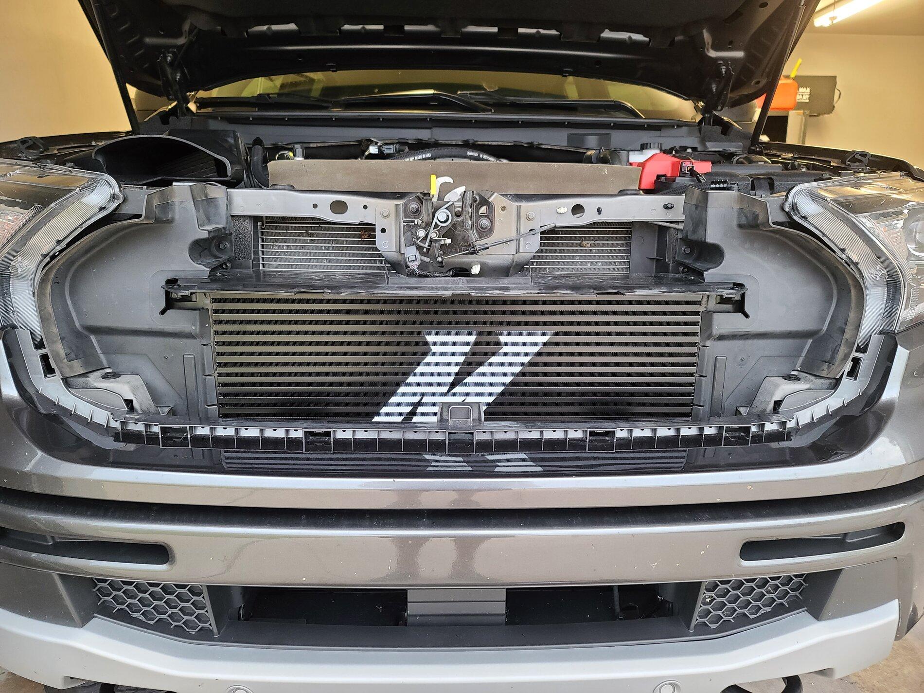

Got the intercooler installed over the weekend, which took a few hours including the intercooler pipes, and I was able to leave the upper bumper cover on. The Mishimoto intercooler definitely fills the available real-estate and has alot more heft to it when compared to the stock intercooler.
I now have Mishimoto's full intake system minus the catch can. The UPR dual valve kept my intercooler and throttle body bone dry and I'm very pleased to see that after 23k miles. I sent a data log to Adam at ZFG to see if my tune needs any revisions. The initial driving impression is nothing remarkable but I imagine the truck will see the biggest difference while towing our boat in the summer heat.

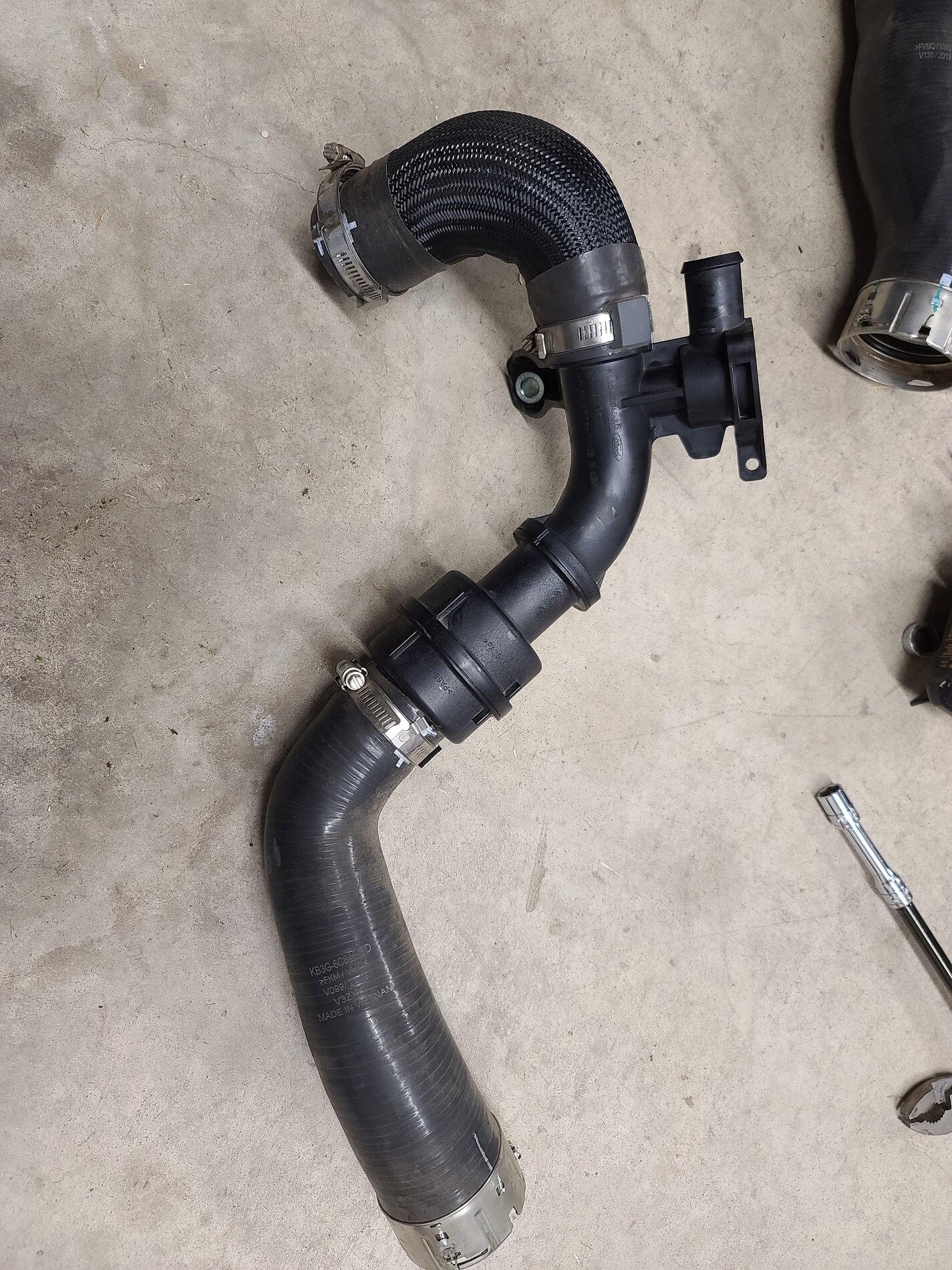

P.S. I'm overjoyed to be rid of that tiny hot side pipe!

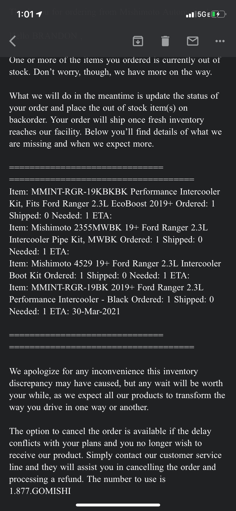

Hmm. Wonder when they will get it out, seems they are missing some pipes. Still affected by covid restrictions by chance?

Great suggestion, I would like to wait for a response from Mishimoto since it’s the full kit with hard and silicon pipes. Don’t want to order two separate ones. But, if no response for a week or so I’ll have to cancel order. Just wondering what an ETA is like.

Hey Guys,
Sorry for the delayed response, but I just wanted to bump this up with an ETA on our next restock. Right now we will have these intercoolers back in stock approximately around late August or early September
We apologize for the inconvenience and the delay! We're doing everything we can to get these out to you guys ASAP!
Let me know if you have any question in the meantime!

Installed
I am trying to do the install like you did without removing the front facia. I got the old one out ok but can not get the new one to drop in. What kind of angle did you take to get it to drop in?
theanswer3
Apr 19, 2020
366
431
Tampa, FL
2020 Ranger XL
im here for this info also....can you go through the info of taking the old one out without taking the fascia off.
FinalNotice
Matt
Jul 7, 2020
71
118
Ohio
2019 ford ranger
It's a tight fit and you have to take your time and move a little at a time on each side. It will fight you like it doesn't want to go in then it will drop right into place.
deton8r
Jan 27, 2020
107
138
Snohomish, WA
2019 Ranger Lariat FX4, 2008 F150 Foose Edition, 2006 Pontiac GTO, 2004 Buell XB12S, 1995 Yamaha TW200
I finally got mine installed today without removing the facia. I also had some issues getting the right angle to get it to fit in. I ended up using a hammer along the top flange on the oval cutouts and it dropped right in. The metal on those cutouts isn't very thick and is easy to massage with a hammer or even vice grips. I would have saved myself 45 minutes of aggravation if I did this from the get go.
IMHO, the grill removal was the most difficult part.
