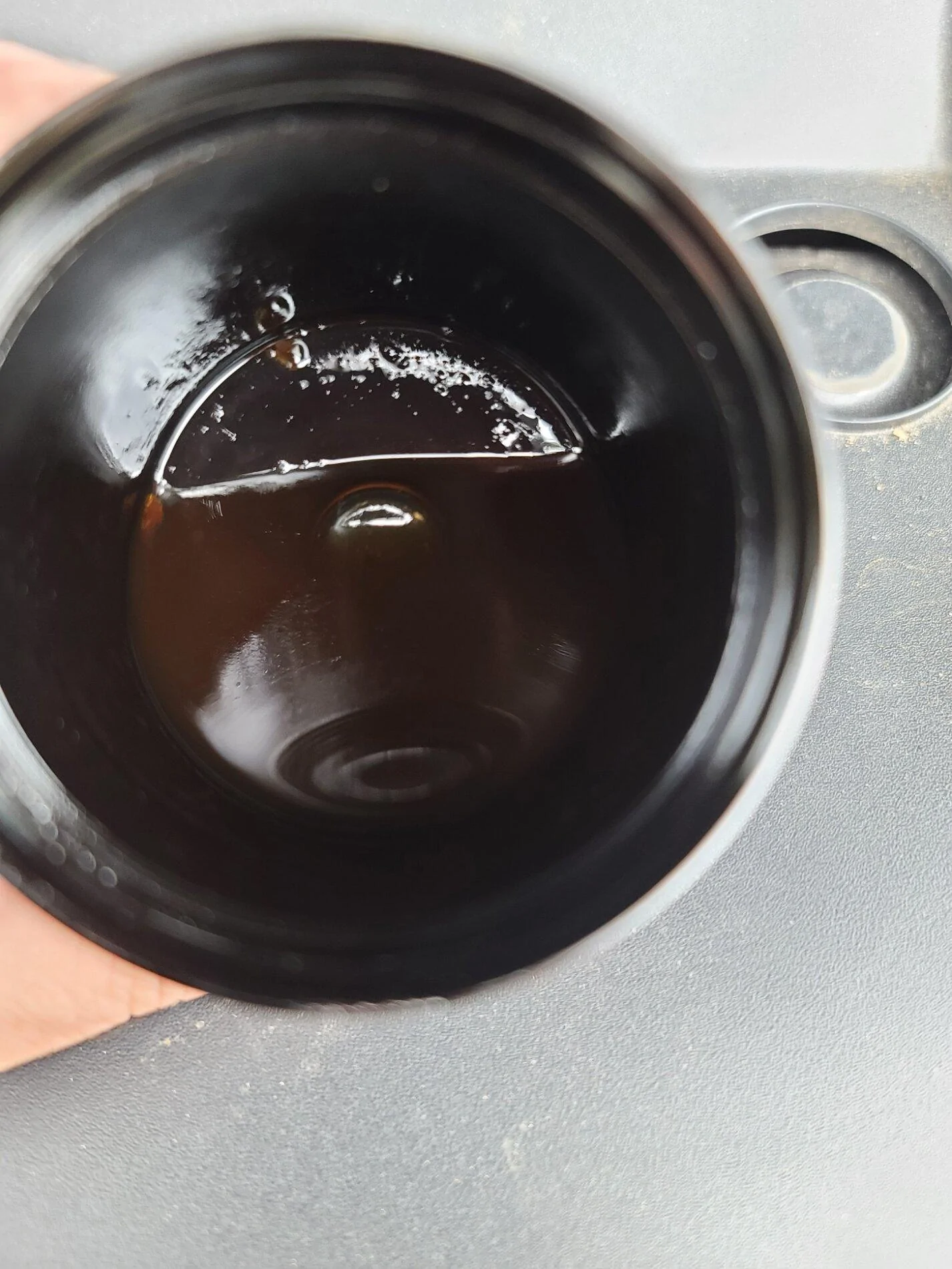

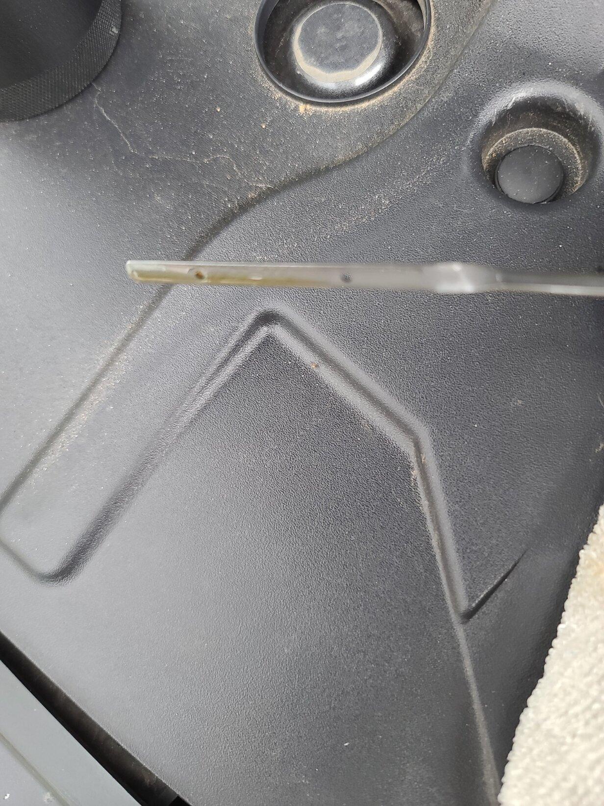

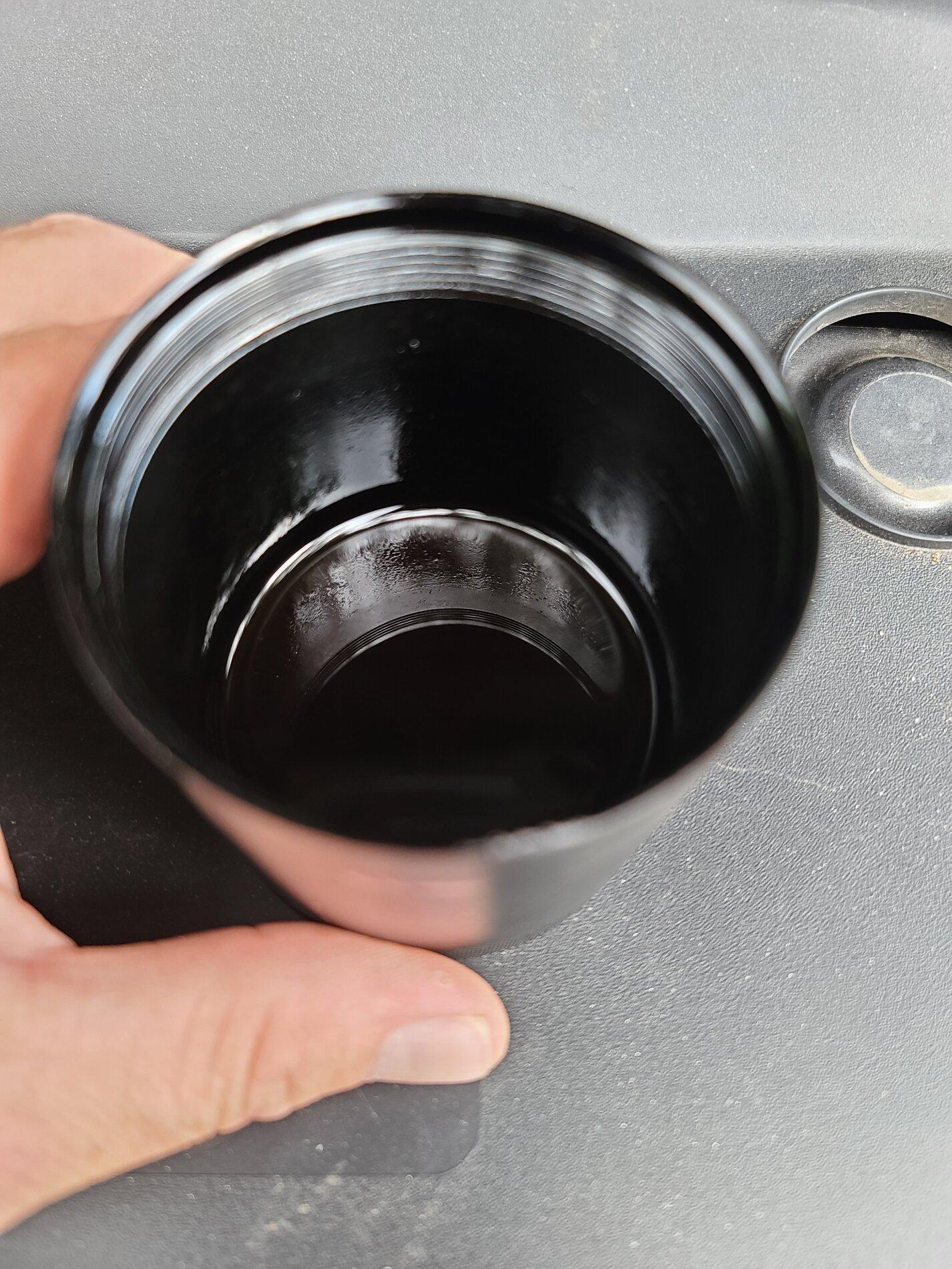

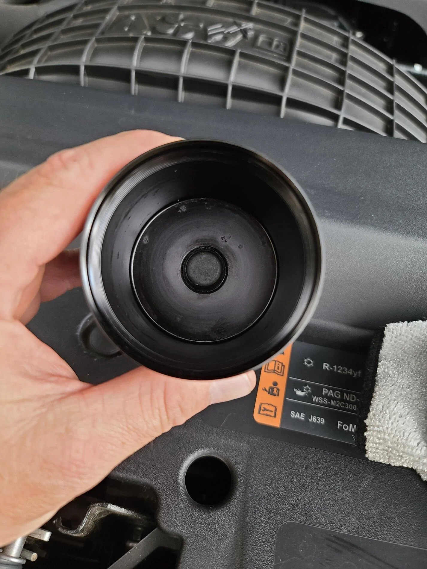

Just checked mine today. 1500 mines after my last dump and oil change. It was a lot easier to remove today than it has been in the past with the exception of me turning it the wrong way at first. But here are a few pics; as soon I removed it, a tilted one, after dumping and wiping it out, and the dip stick.
It looks like the pics got out of order while copying them over.

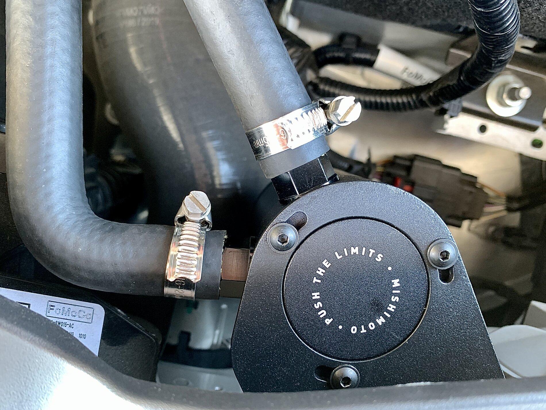

installed the MISHIMOTO catch can the other day. Not to difficult but as others have mentioned man there’s not much room in there lol.
I’ve got about 100miles since install and cracked it open just to test it out. Light coat of film so far , interested to see what it catches.

I trying to install mine and am having an awful time. I removed the factory hose just fine but I’m having a terrible time getting the mishimoto hose to lock in on the “red” connector. Now the red connector feels loose. Two questions; any tips on getting in there a little easier? Is the red connector supposed to be loose?
Did you remove the wheel? I don't recall my connectors being loose. Once I removed the wheel I was able to get my arm in far enough to push it on for a solid connection.

I installed the kit on my truck a few days ago. Agree, just remove the tire before you start. I had a hard time with the hose on the red connector but just keep at it and you’ll eventually get it. My hands took a beating. The whole install took me about 4 hours. I plan to add a drain valve also.

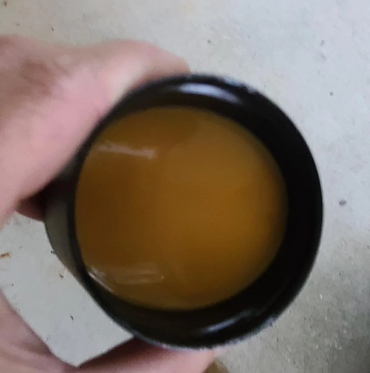

That's a different color than the last few dumps.
