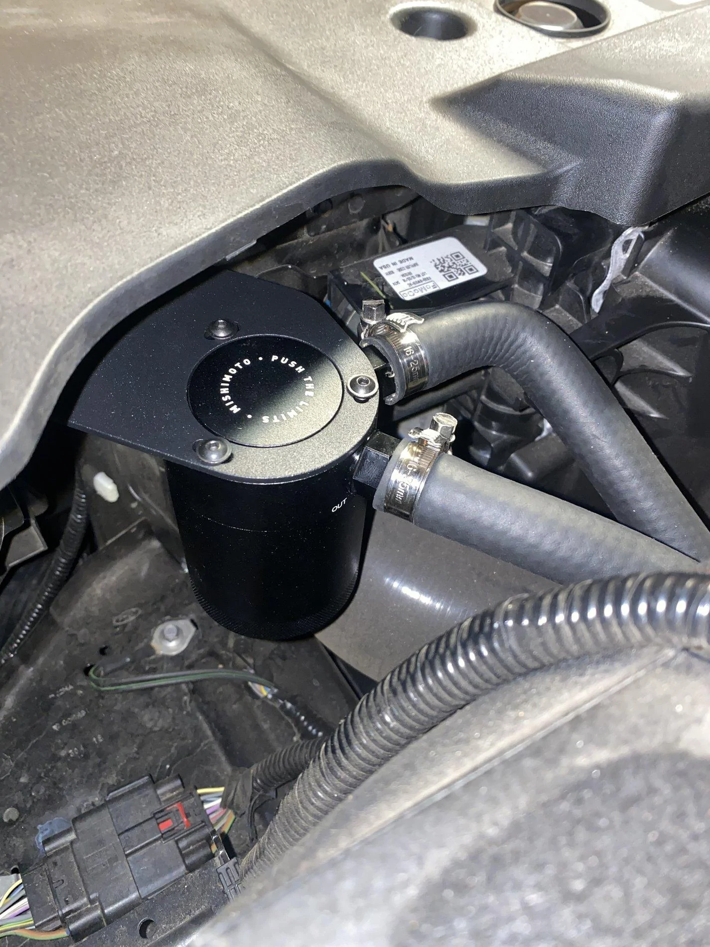

The catch can came in this afternoon and I installed it without any issue after dinner tonight. Installation took a little over an hour taking my time and comparing what was in front of me with the install video and installation instructions.
My kit did not include paper instructions, but you can get the installation instructions here:
https://cdn.mishimoto.com/media/productpdf/MMBCC-RGR-19_INSTALLATIONGUIDE.pdf
Build quality is great and I'm very satisfied with the Mishimoto kit. :like:

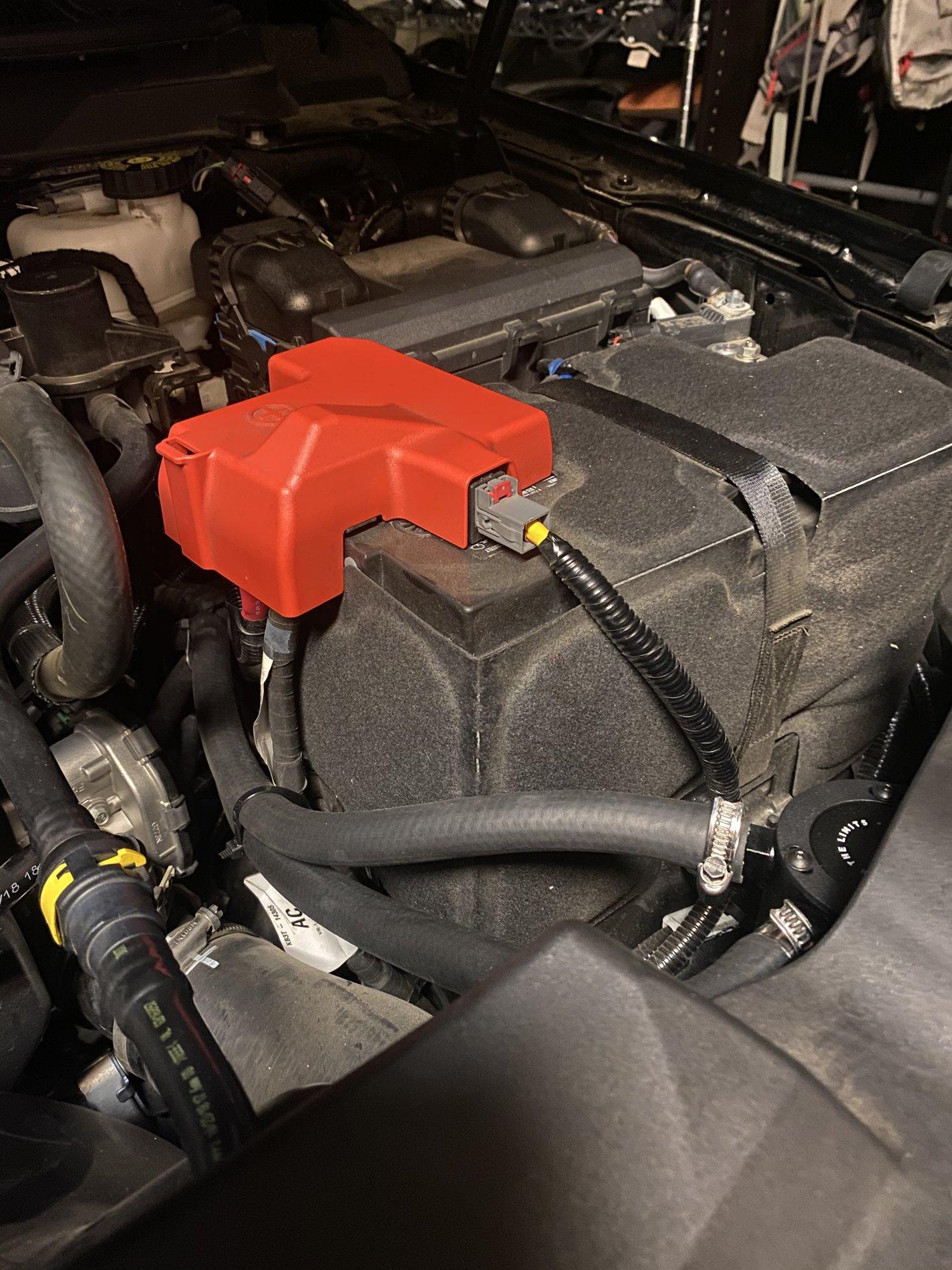

Finally got a break to install this. What color connector (red or yellow) goes to the intake?
TIA

The yellow port on the engine is the intake and should be connected to the "out" port on the catch can. The red port is the engine side and should be connected to the "in" port on the catch can.

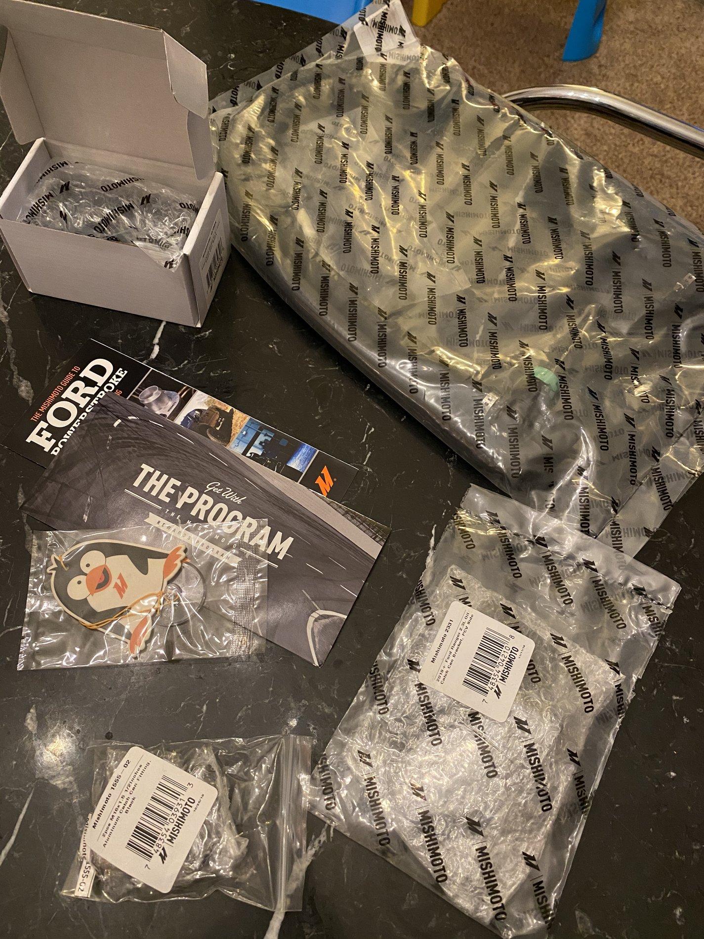

Just finished installing this kit. It sat on a shelf for a couple month as I was waiting for an oil change to come due.

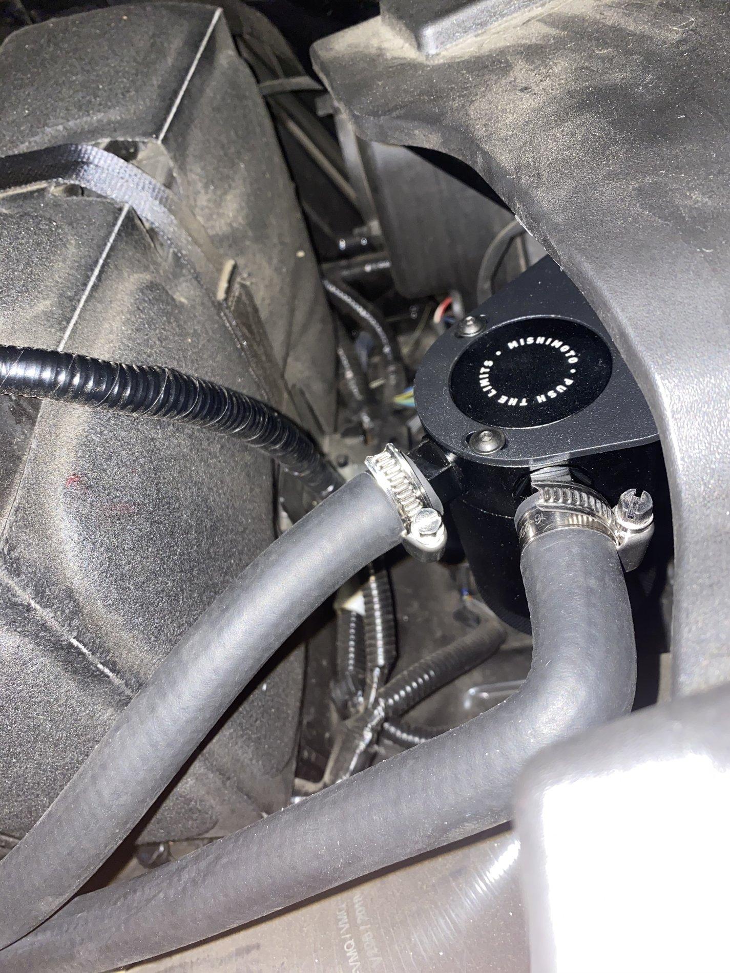

First of all, DAMN! That’s a tight space to get into. The video instructions are great but they don’t capture the true difficulty of this install. After you’ve taken off the driver’s side wheel and the engine splash guard, you’re in for some really hand/arm contorting and maneuvering to get the old PCV line out and the two new and bigger Mishimoto lines into the same space. The new lines (female ends) have to be pressed onto the nipples and then you have to find a way to press the clip down to lock them into place. Sound simple? It’s not. You have to give yourself several good looks at your target and go in blind with one hand because you won’t have space for both hands (i.e. this is not novice work nor is it an 1.5hr job). I’m definitely an advanced level wrencher and this was a PITA. Give yourself a lot of extra time and as much lighting as possible.
Onto the good comments:
The kit is top notch, excellent components that will surely last the life of the truck. Everything you need to install the system is included in the kit, nothing missing. The one additional thing I used was some blue thread locker on the small screws that hold the catch can to the mounting bracket.
To those looking to install this soon. Good luck. Feel free to reach out if you hit any road blocks during your install.

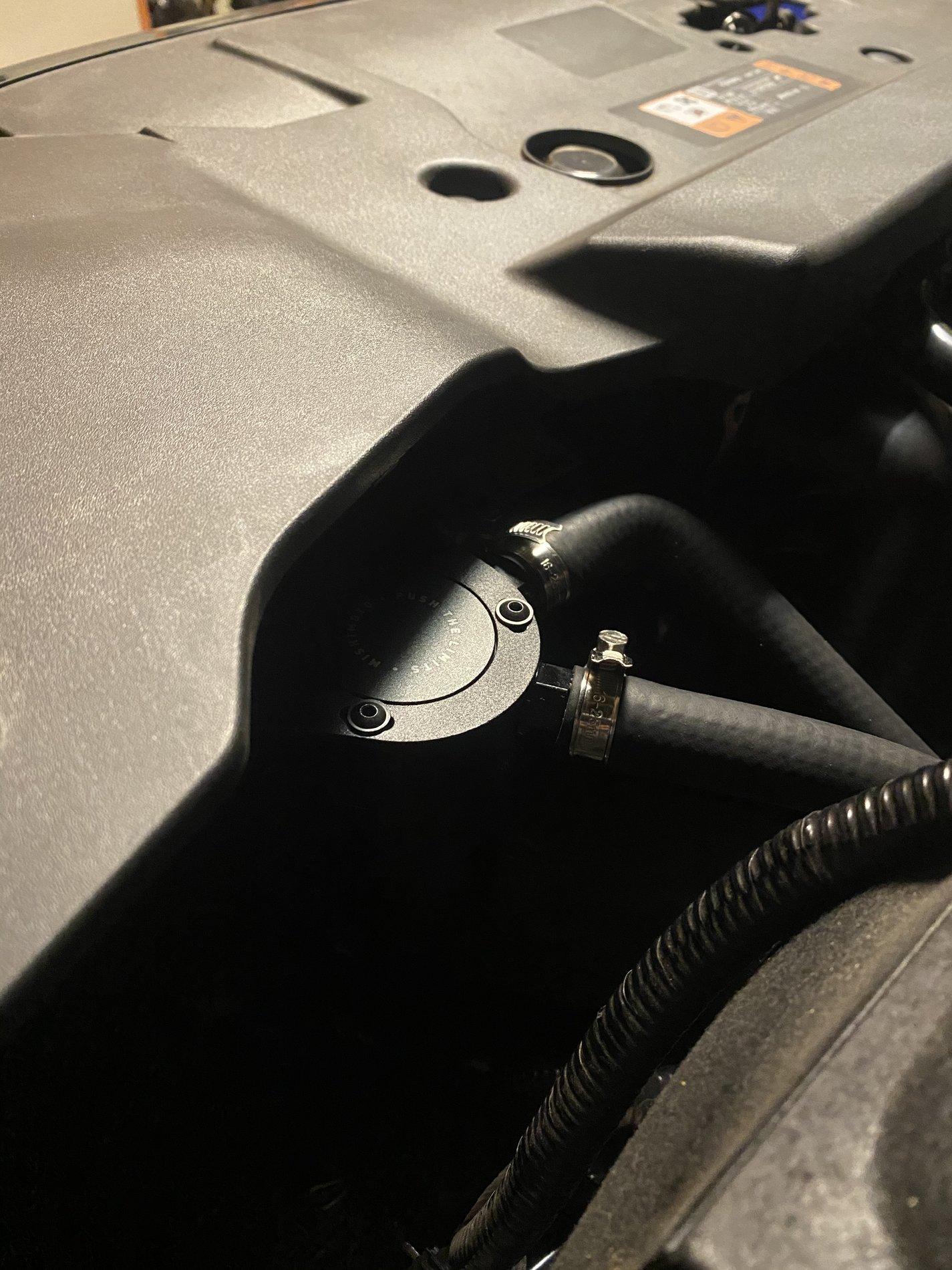

I have this catch can and installed it a couple months ago. For anyone else who gets it, make sure to remove the driver side tire. I could have saved myself a lot of fighting if I would have done that to begin with. Other than that the only issue I have had so far is that it is a real pain to remove the can to dump it. I don't tighten it anymore than hand tight, but can't get it loose most of the time without removing it from the mount so that I can get a better grip on it.
