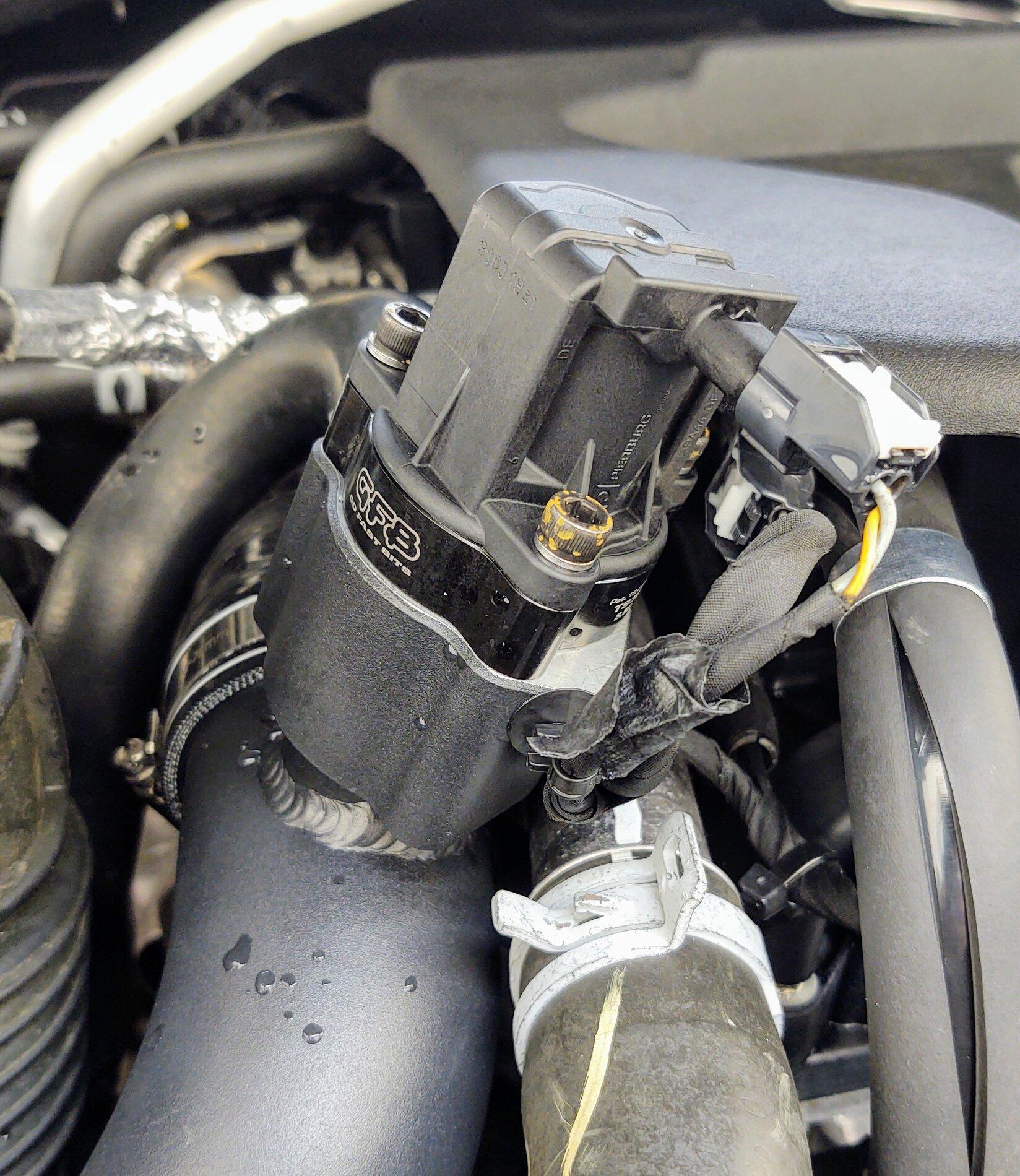

Here's the GFB and stock blowoff on the install: not sure if it's my imagination but it looks like Mishimoto tilted the blowoff mount a hair - if so, that was damn clever (clearance).

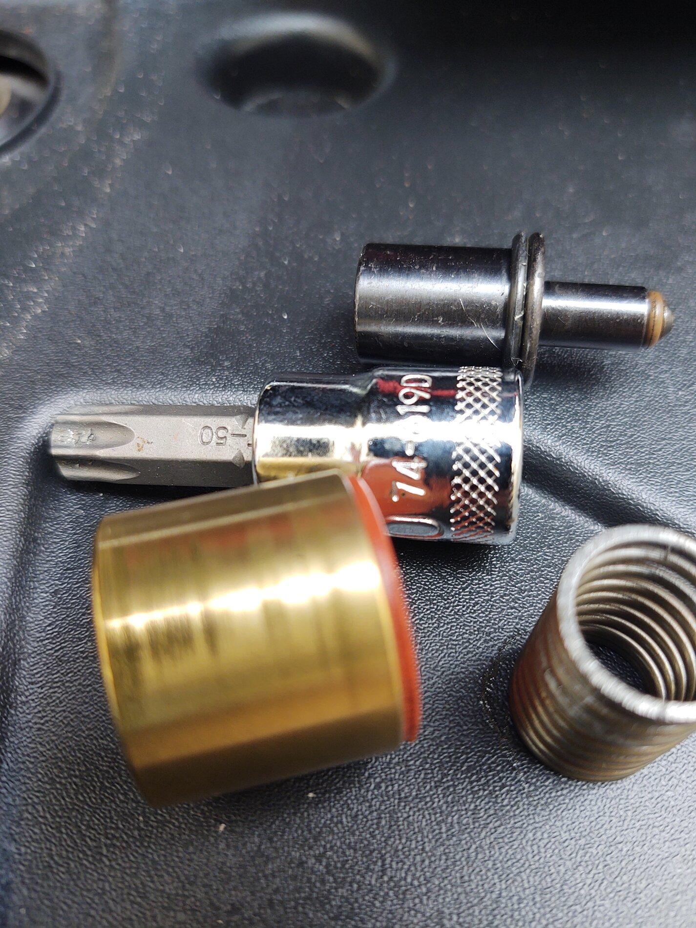

First time I've disassembled the GFB, here's some wear on the piston:

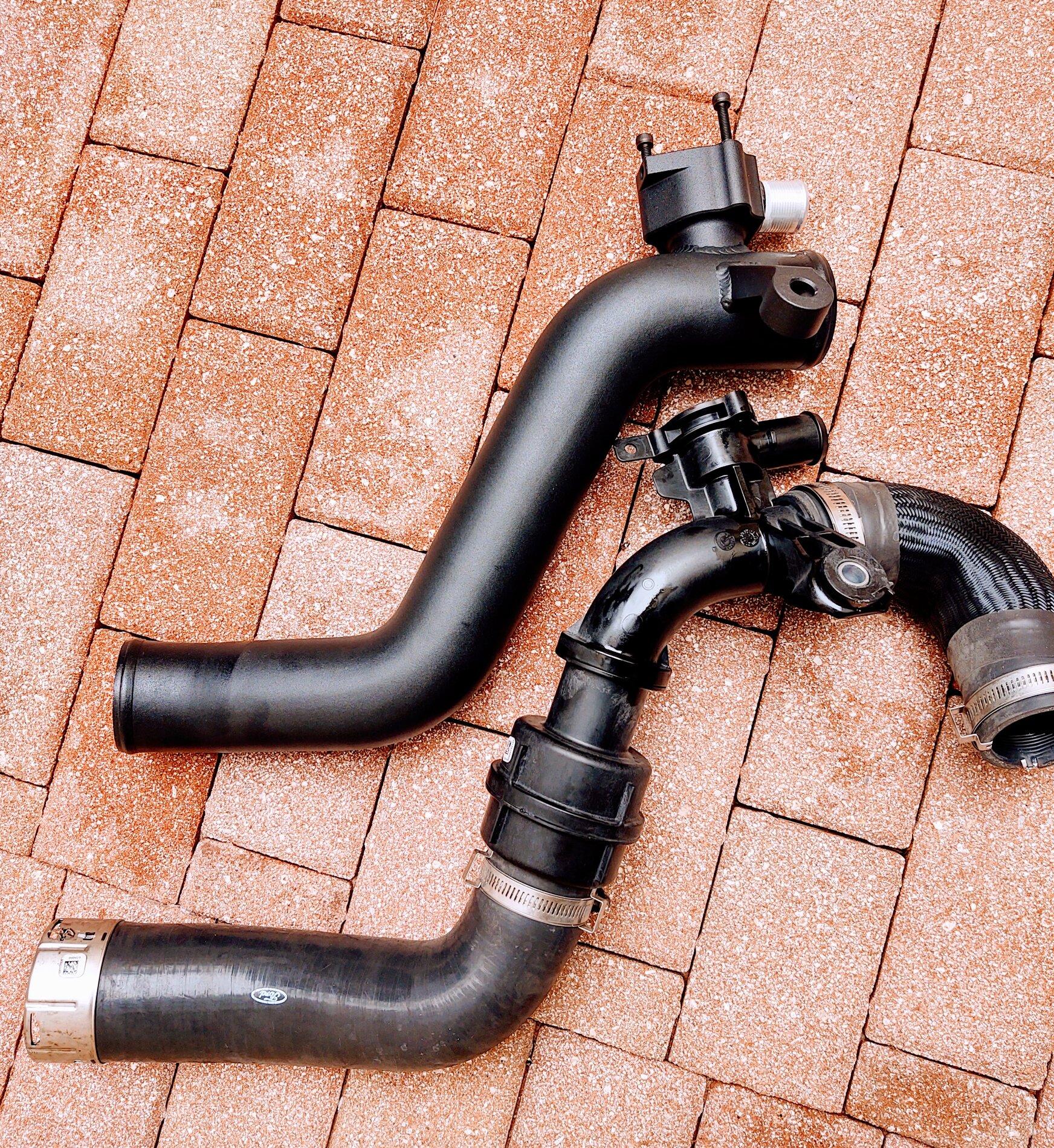

Comparing the stock hot pipe to the aftermarket you can see where the constriction is/was - I suppose the 'chamber' that bumps out after the blowoff is for noise control - the whole thing visually is lower restriction and less turbulence.

How many miles on your GFB? That looks like normal wear to be honest. Not bad.
At least 12,000 miles. I installed it eleven months ago.
