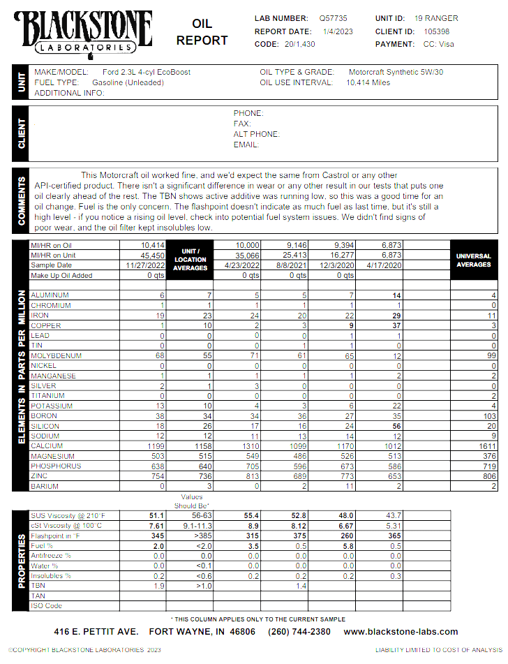

Here's my Blackstone. 10k OCI looks to be in the clear... with plain old Motorcraft 5w30. I've done full and blend synthetic versions here in the shown history. The BITOG people have heartburn in the loss of viscosity down to a 5w20 equivalent, but it bothers me none.
BTW, I have the Ford Performance engine tune and K&N air filter that comes with it.
