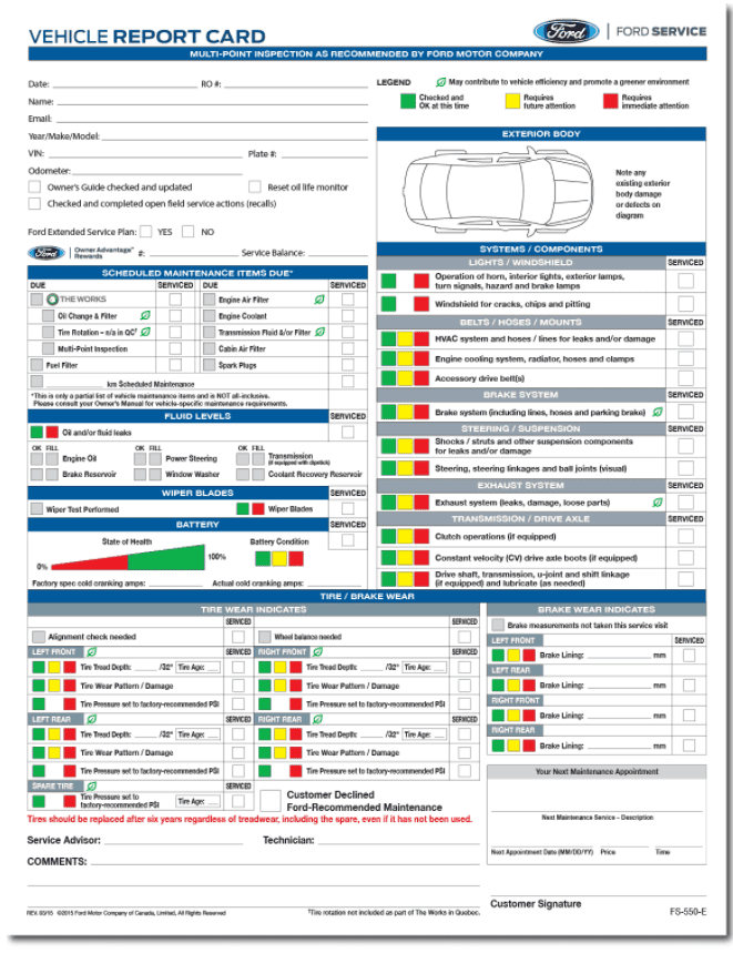

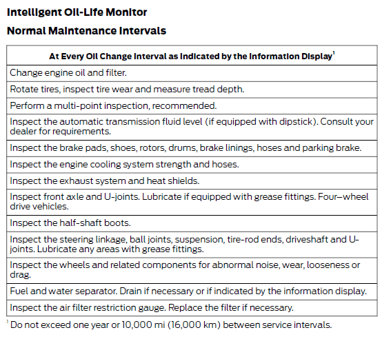

well this is the 10000mile list from the owners manual, and the works package list, it pretty much looks at every item on that list. compare the two.
Pretty much looks identical, thank you!
