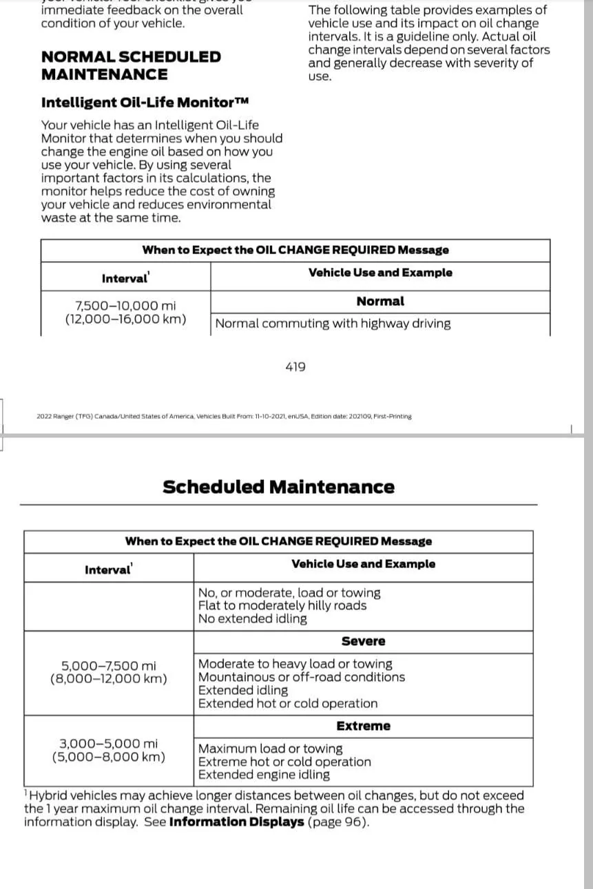

The book is pretty helpful on the intervals based on your driving habits and truck use (i.e. heavy idle time, towing, etc).
Not only does it outline this - it explains how our Oil Life Monitor is Intelligent and is actively monitoring for these circumstances. It will adjust your interval based on your use - so it is actually not hard coded for 10,000 miles. Under normal use it is variable from 7,500-10,000.

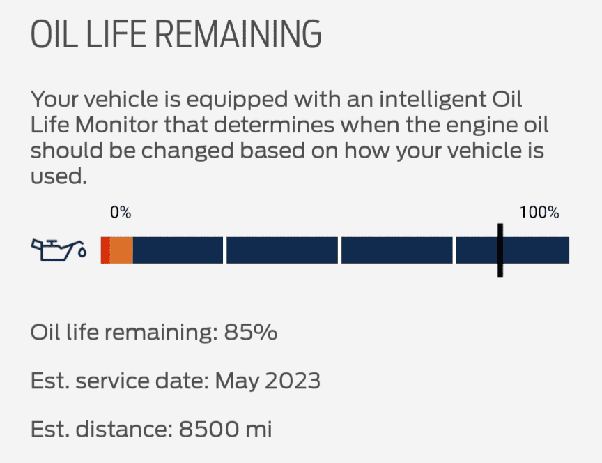

Not sure about your truck and what you're seeing; but I can say already for my vehicle this is not true. When I look at my OLM on Ford Pass it is already saying I will not make it to 10000.
My Odometer currently reads 1760 miles.
Perhaps my math is off.
But you have 1700 miles on your truck. OLM says 85% of life left. Meaning it's telling you right now that it needs an oil change at "roughly" 10k miles.
Seems like you've proved my point for me.
As far as the May estimate that's either the time factor or the truck extrapolating out the miles you drive per day.
Also, while your experience backs up my point completely. You're basing your point off of 1700 miles and zero oil changes.
I'm basing mine off of 35000 miles of driving truly varied conditions and 7 oil changes.

Not trying to prove you wrong. But I suppose if I'm making a point it's that it says my estimated distance is 8500 miles, not 10,000.
Estimated distance from now 8500 miles. Plus the 1700 you currently have makes 10,200 right?
Or did math change again?

No I think you may be mis-reading the meter though. It is saying that my estimated oil change will be at 8500 miles. Not in 8500 miles. The estimated distance is on the oil total milage, not estimated distance remaining - like how the fuel gauge works.
You most certainly are misreading your app.

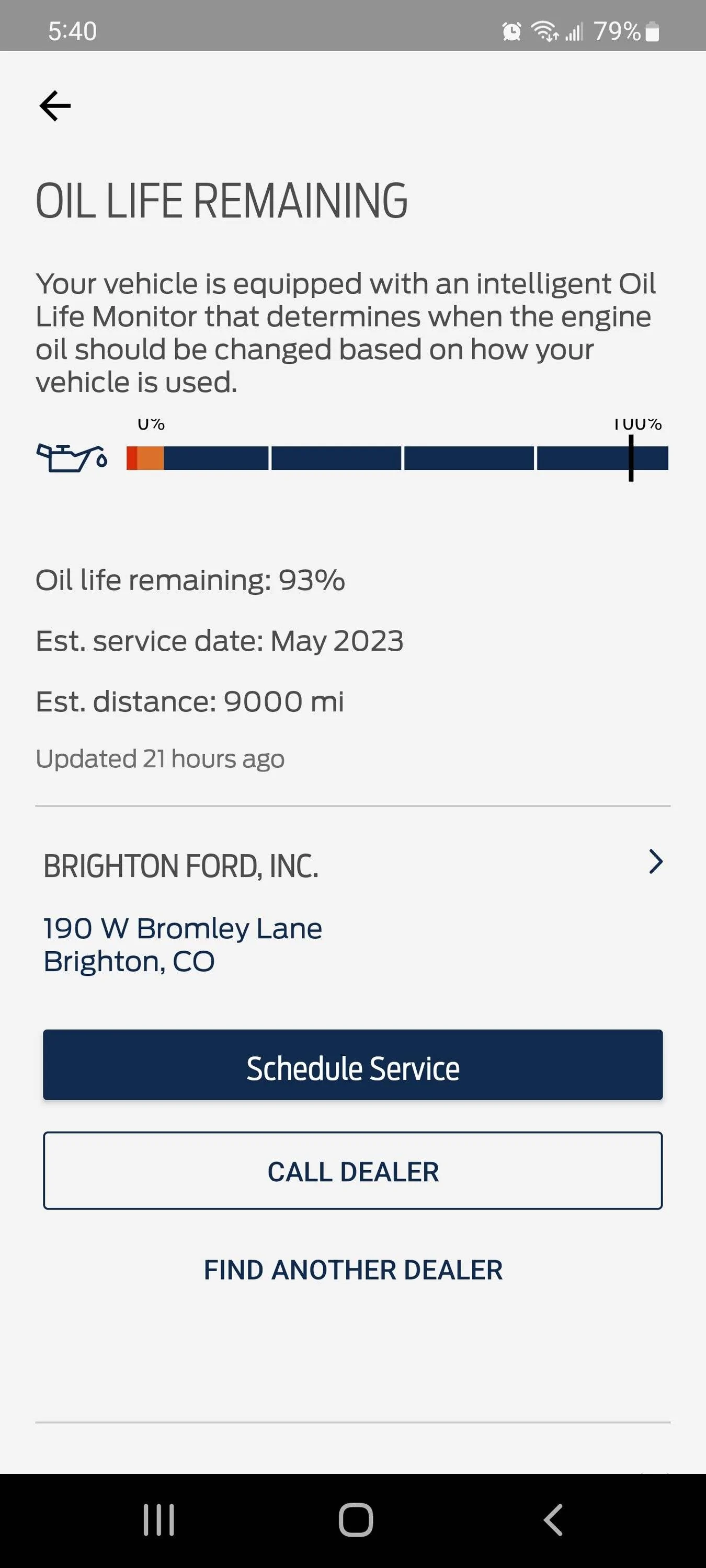

Here's mine. Oil change 750 miles ago at 35k miles.
How am I to change the oil at 9000 miles if the truck has 35000 miles on it?
When did people start speaking with authority about things they know nothing about?
