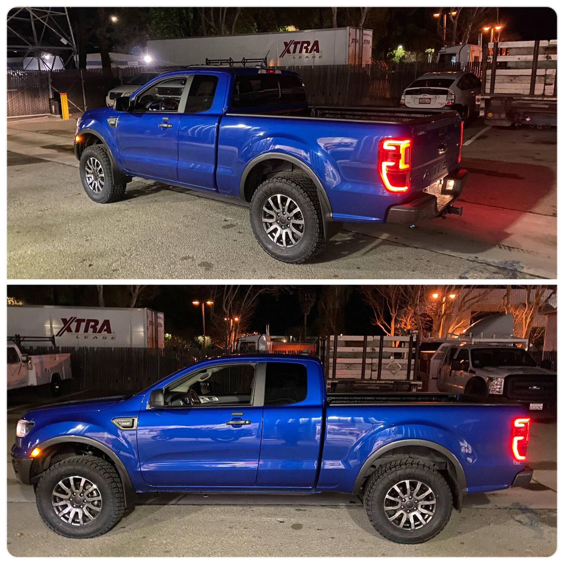

Fronts on...ride is level...feels like a truck now. Had some issues with install though...first spring compressor would not fit between coils, took to a Big O tire store who said they could do it...their wall mount compressor didn't have enough reach and couldn't compress enough. Finally rented the "tool of death" and it worked perfectly. It feels much better leveled...smoother ride overall, and looks great with the Nitto Terra Grappler 285/65/R18 tires. Having alignment done Thursday...did not realize that not all shops will align with coil over struts.
By the way...fairly complex swap for a non-mechanic. Over 6 hours of actual work...and it rained half way through so my butt was soaked...LOL!
