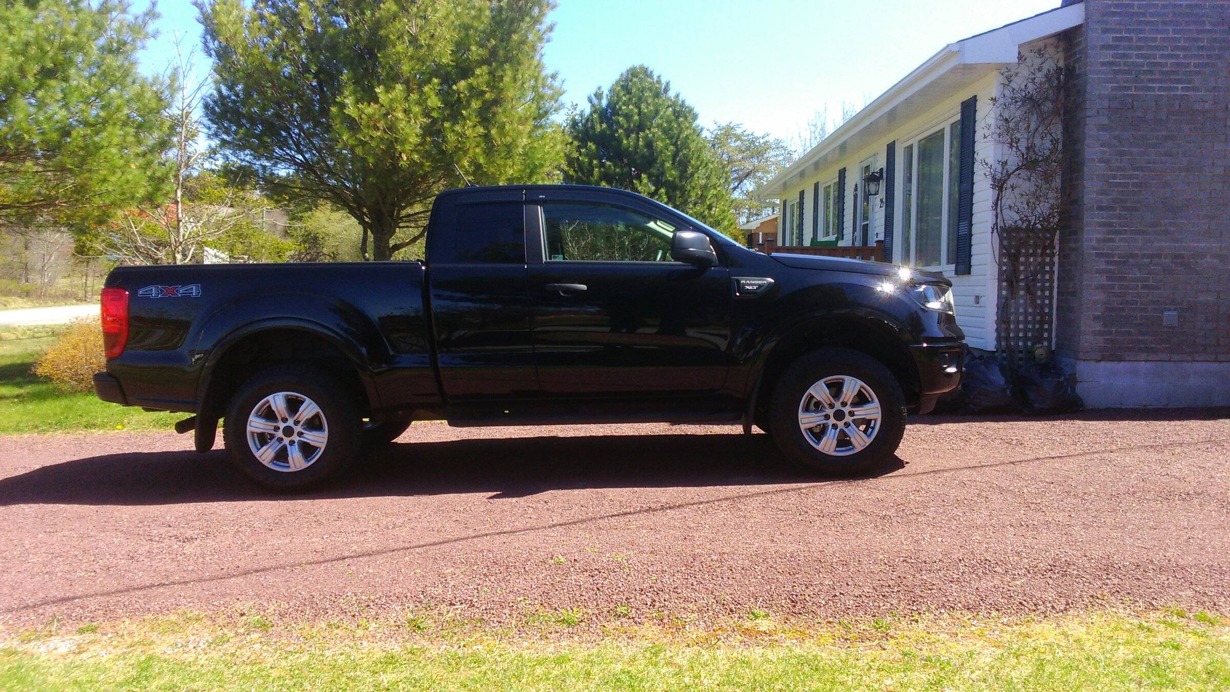

I'm going to make a second attempt to install mine this weekend.
Is it easily possible to turn the strut a little so the spacer lines up?
I didn't get quite that far last week as we couldn't get the tie rod end off. I bought a pickle fork today.
I was going to attempt it but opted to let the dealer tackle it. Getting too old for this. I purchased the lift from the dealer anyhow. Figured if they screw it up, it's on them.
