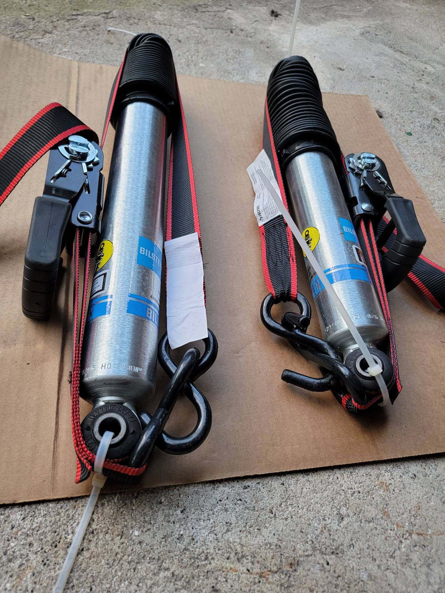

I did a modified approach to compressing the bilsteins. I had the ratchet strap slip off so I used zip ties in the eyelet to hold it in place. I installed them on my 2020 ranger with muscle and my shoulder hurt for a few days. This time around on my 2021 I'm working smarter not harder ?
