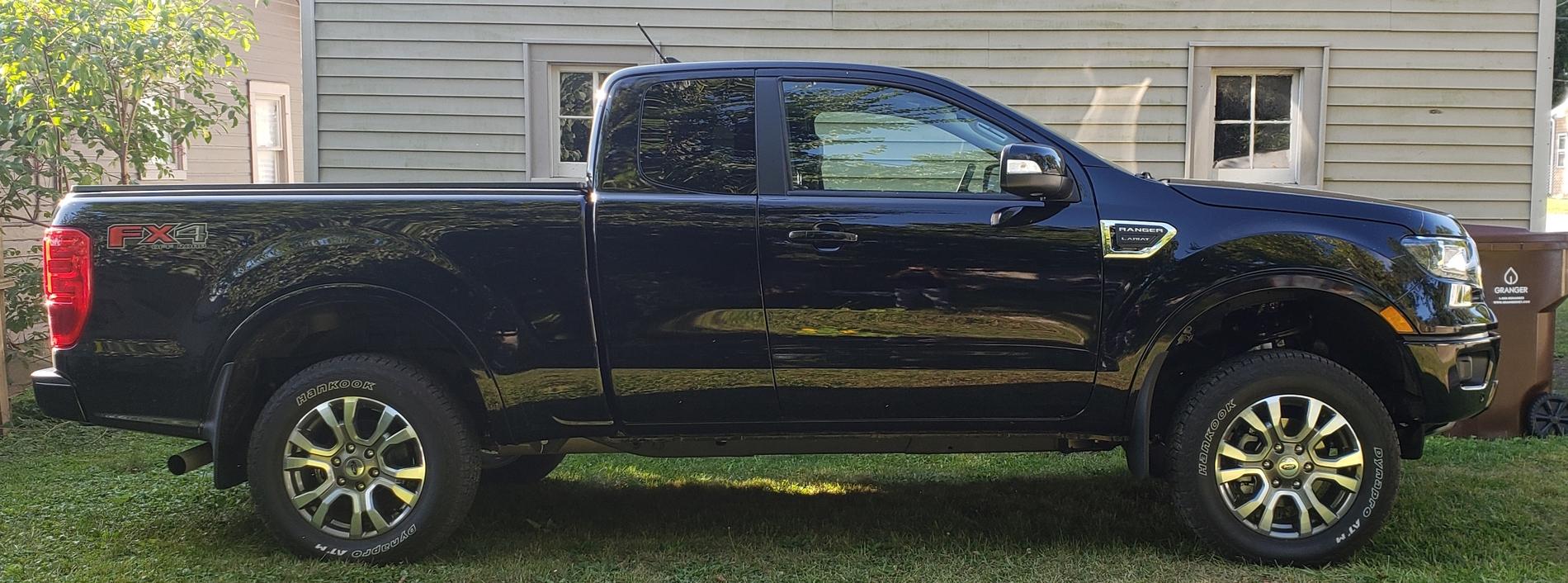

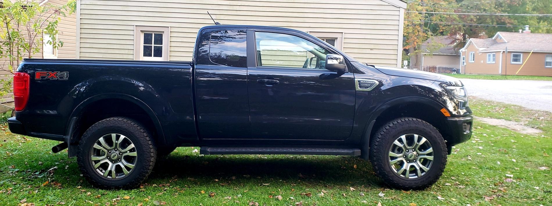

Installed a set of Eibach lift blocks over my lunch break at work. I previously installed a 2" leveling kit and was not too happy with the "leveled" look afterwards. Wanted to install these to add back a slight amount of rake. Pretty happy with how it turned out and adding some rake back into the mix makes it drive/ride way better.
Before (with stock tires);
After (with 275/65R18 tires);

Much better! That's the biggest reason I haven't gone with a level lift yet, I want to retain some rake.

Yup, I bought a 2" kit to try and retain some. But that wasn't the case. 1" in the rear was a great improvement.

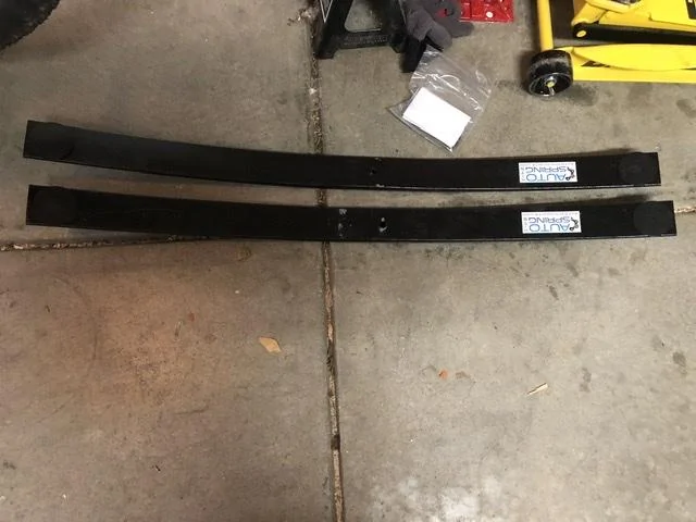

Well this peaked my interest so I decided to also see if anyone had an add-a-leaf and it looks like they do. Found one vendor. Called them and we can specify 1-1.5" lift instead of 1.5-2" in the order comments. I'm gonna go this route for the extra load capacity for overlanding. Just in case anyone is interested.

Nice! That's a good deal for a quality looking add a leaf kit. Plus, shouldn't be too hard to go that route either, since you're not having to worry about keeping a leaf pack compressed while removing the center pin/bolt. Would be a great "kill tow birds, with one stone" upgrade if you're going to be hauling often.
Yes sir. And for the record, I have no issue with blocks and I think these Eibach ones are a great solution at a great price for anyone looking. I just like the idea of a little less rear squatting once I have a RTT, mountain bike, kayak, fuel, fridge, etc. loaded on the back of my truck using the AAL.

I'm very interested in your feedback post-install.
Got them put on this morning. The instructions suck but I love the result. Definitely a little stiffer in the rear.
