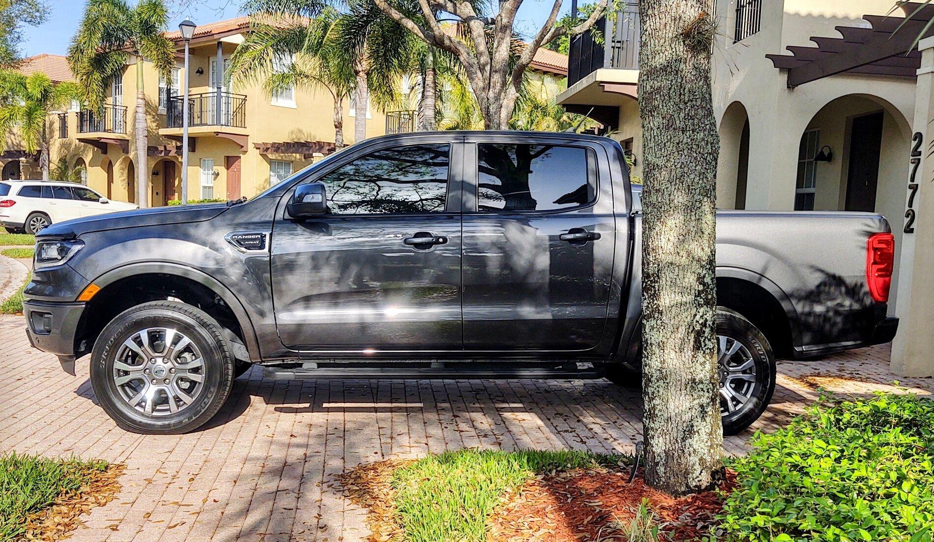

I was so interested in fixing the ride quality on my Ranger I didn't measure the change in rear height. After getting the Eibach fronts put on with the slight lift and an eye on some towing, I hope this compliments what I've done. The gap in the back is now one a d three quarters' inch more than the front. Beats the just over three inch difference from before.
