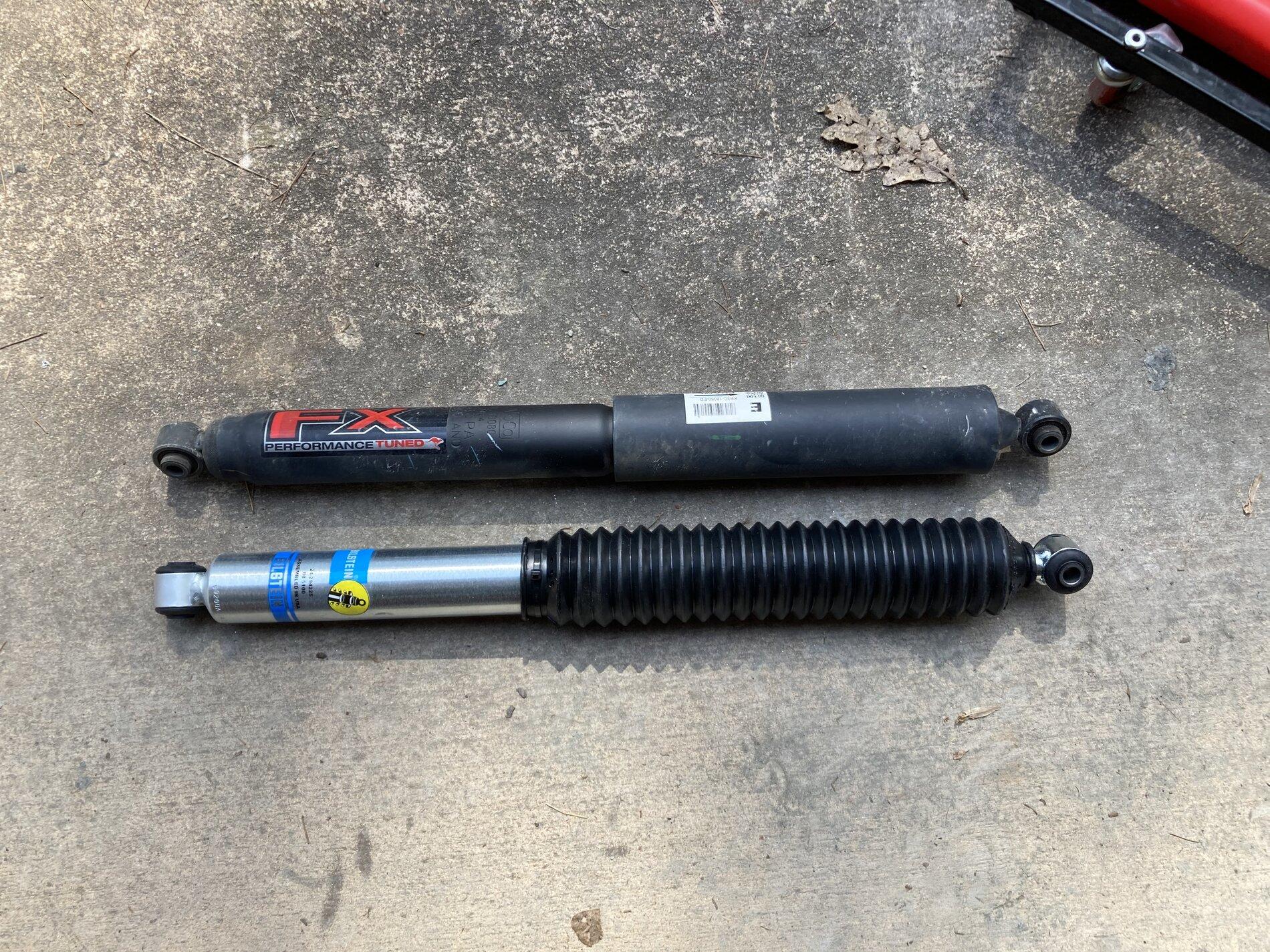

Update: Got the Bilsteins installed.
Took 20 minutes with part of that waiting for the air compressor to charge.

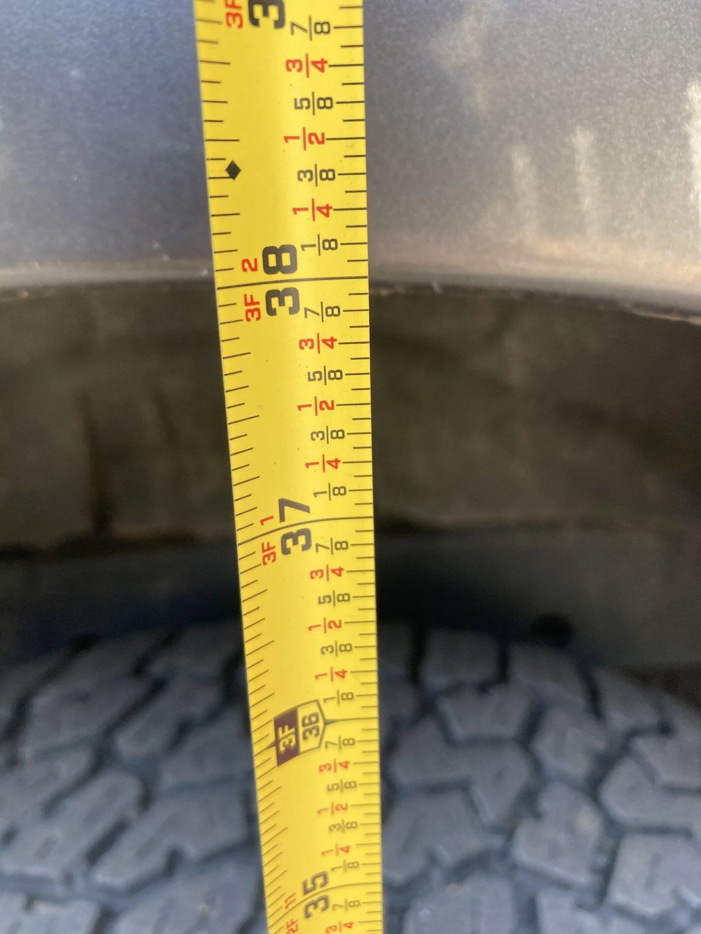

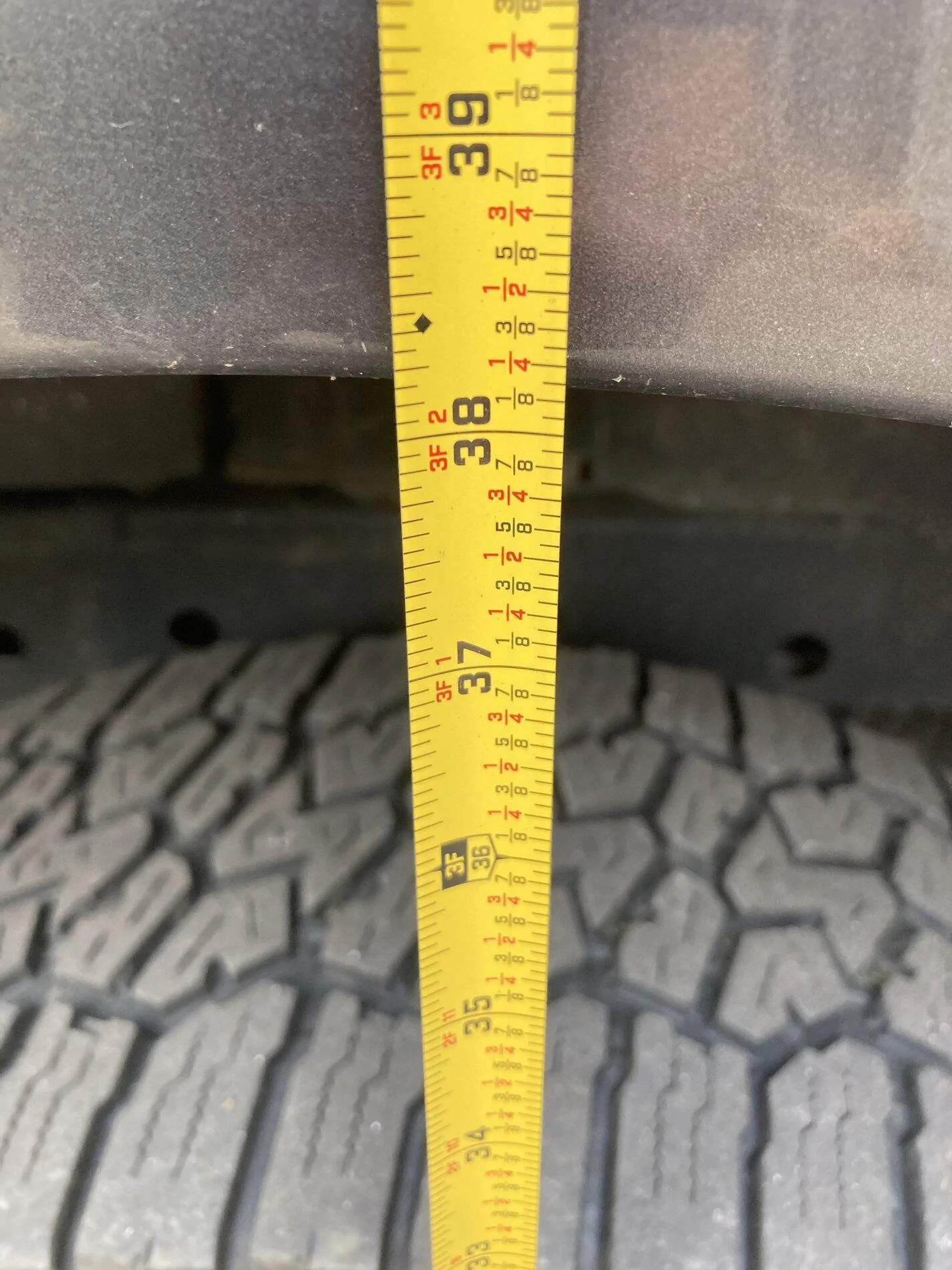

Like a few others here, it looks like I gained around a quarter inch in height in the rear.
And after much research and technical debate, and a coin toss, I installed them with the Bilstein logo downward.
Before:
After:
So the verdict?
Notable improvement on the road. "Tighter" overall feeling but not harsh at all.
So I headed to the closest dirt road that I travel frequently to really check it out, complete with some washboard.
BIG improvement. Handles it far better than before.
So all in all a very worthy upgrade.
Before:
After:
So the verdict?
