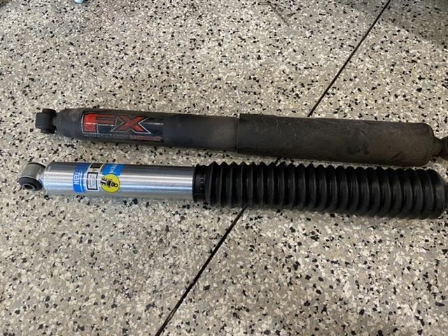

I know there are other posts that have some of this information but I wanted to share my thoughts/opinion.
If anyone is thinking about upgrading your rear shocks but on the fence about if it’s worth it - DO IT!
I installed Bilstein 5100’s on my XLT FX4 this morning. First of all, the install is EASY. Only needed a rachet, short extension, and a 15mm socket. Total time to do this was less than 40 minutes and that included set up and putting everything away. I did not have issues installing the new shocks - no floor or bottle jack - yes, they are a bit stiff but I guess this 60 year old still has it! Upper’s in first then muscled the lower end in.
I took it for a short drive and immediately noticed much less side to side rocking backing out of the drive into the street. Where before it kinda threw me from one side to the other, the truck ‘bounced/rocked- maybe a bad choice of a wording - once, recovered and it was much smoother with no subsequent 3-4 bounces/rocks back and forth.
Driving impressions - can feel the bumps just a bit more but in a good way. The bouncing is definitely gone and the truck has the feeling of being more stabile. Doesnt seem to feel like I’m floating on the road. Making turns, for sure the swaying is also pretty much gone. I’m anxious to feel the difference on the highway (where I’ve always thought the truck had a way too floaty feel).
The one interesting thing is that I’ve gained a little more than 1/8 inch of height in the rear - even measuring after driving for a bit. Hmmmm. I know these are much stiffer than the FX4 shocks but wouldn’t think they would impact vehicle height. We’ll see how it measures after a couple hundred miles.
As I said at the beginning of this post - Just Do It!

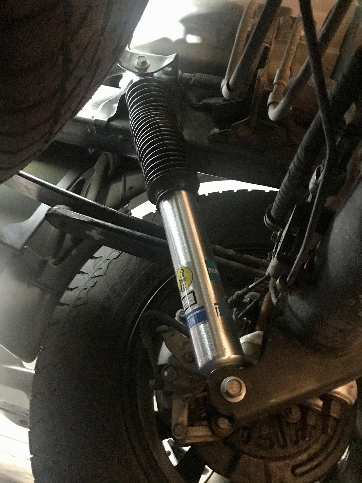

Ok, update here: Just installed the rears this afternoon...34 minutes, one 15mm ratcheting combo wrench and a long flat blade screwdriver...easy peazy. I didn't pre or post measure height so I don't know for sure that there was a change but...the drive test was incredible...smoother response to ruts and bumps without the "Death Shimmy!" Seems like less instantaneous rebound...the valving on Bilstein is spot on.

After tires, the most significant improvement I made to my 5G ranger was replacing the rear shocks. (In my case with Bilsteins).
I've driven compact/mid-size 4WD pickups since the late 1980s and the factory shocks and struts on my Ranger were ...not bad...but, uh, not really "truck-like"...
When I replaced the rear shocks, the ride was night-and-day. Also, my rear traction improved on and off road noticeably in that my tires weren't prone to spinning as much on spirited acceleration while turning from a stop. ? The extra firmness kept them better planted on the road instead of bouncing back up into the springs.
Honestly, I recommend to anyone that replacing the shocks is one of the first great and economical improvements one can make to their Ranger.

Just did the rears on my truck this morning. Easy install and like everyone agrees, really stops the side to side swaying the truck had with the stock FX4 shocks. This is going to be one of those upgrades that’ll I’ll easily forget about but in a good way. It really has sorted out the handling so it handles and drives normal.
