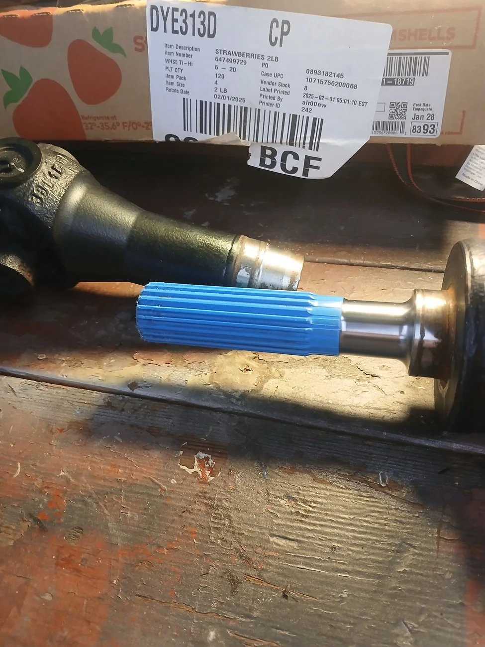

Took the whole damn thing out and it still binds up, that plastic coating is the bad guy I think 🤔, thats definitely the story I told the wifey when the credit card dinged her phone for $740.00...
Im mad and glad at the same time as maybe I'll finally lose that slight vibration from the carrier bearing, it wasn't bad, but ... I'm down at least a week though, and I blame all this on Duke getting me to test out his pex pliers on those damn clamps to see if he could save a nickel...
And damn those flange bolts, they fight to the very end 😳! I think Tom Woods is near Canada so maybe Duke can just swing by on his way down to help me fix this/his mess ...

Well the nightmare continues, just installed the Tom Woods and I have a vibration at 45 to 55 that was not there before... I guess I'm going to have to order a Ford one...

Just talked to Shawn about it , might be an angle issue 🤔, but im tapping out on messing with pinion angles and such...

Ok , looks like I'm stuck with these two, I just need to figure out why they got divorced in the first place and how to get these crazy 🤪 kids back together!
Im cleaning all the crap outta there and going to try and straighten things up...

Is there any chance you had them clocked 180º from how they originally were? As I recall, there are gaps in the teeth at the 12 and 6 o'clock positions... maybe it fits smoothly in one orientation, but demands alimony in the other?

The only thing I can think of trying is to use a small file and gently file down the flat tops of the blue coating at the end of the shaft , to match the contour of the non burred splines
