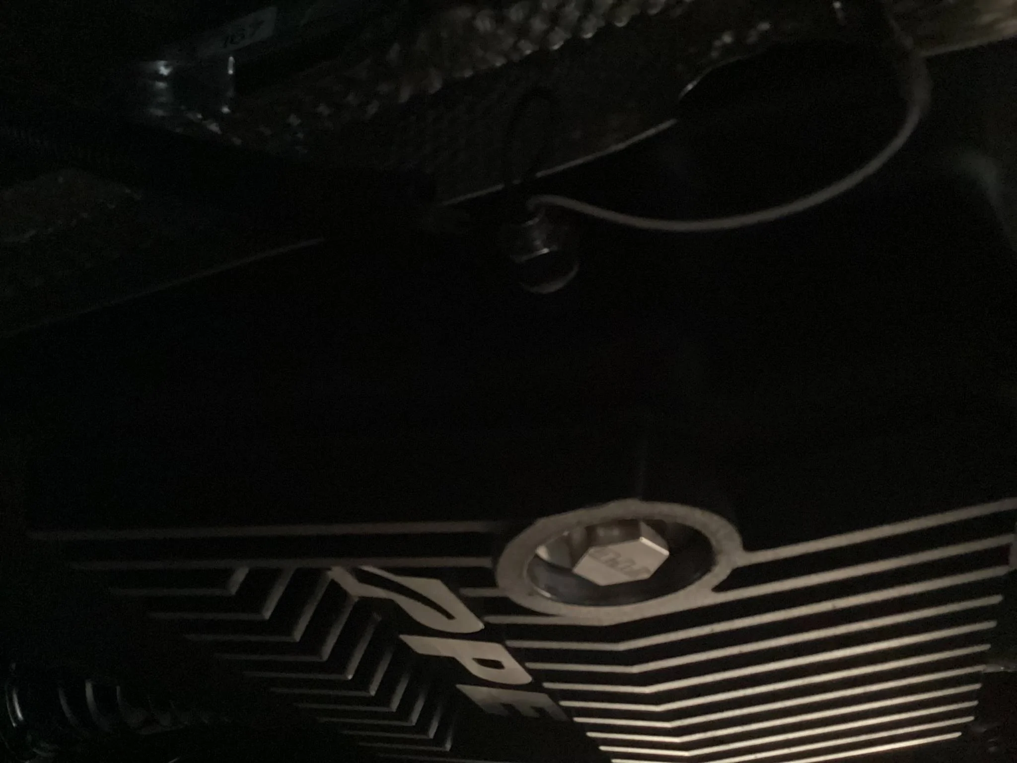

Front and Rear diff are easy if you have drain plug. Use oil in squeeze bottles.
Good luck finding Ford Tech who can do transmission in less than 2 hrs, plus $40 filter, and + 5 Qts ULV @ $7 qt,
I did it myself on ground in four hours., added high Capacity PPE pan, and changed filter, gasket and filter seal are reusable.
https://www.ranger5g.com/forum/threads/installed-ppe-transmission-pan.16182/page-5
This will be my 1st vehicle where one cannot use the tranny cooling lines to get most of fluid out, inc that in the torque converter . But currently have no plans to change it in the near future. Like others have expressed I lament that dipsticks are a thing of the past, with auto boxes I believe in doing a visual assessment of the fluid giving mileage lesser consideration. So no argument about having the dealer do it early, just one of doing it early, but roll your own. Did your change get the fluid out of the converter ? A long time ago those had drain plugs.

Added 7 1/2 qts 1/2 new fluid, now new have pan has drain plug and can change whenever I feel is necessary.
Use is towing in + 90F Fl heat, and the oem plastic pan is sketchy at best.
Thanks, the new pan I assume is metal? Auto makers continue with use of plastics on engines, 1st with valve covers , tranny pans, fords 2.7 and gm I belive have plastic oil pans and drain plugs, fortunately ranger is metal. So how did the fluid look ?
