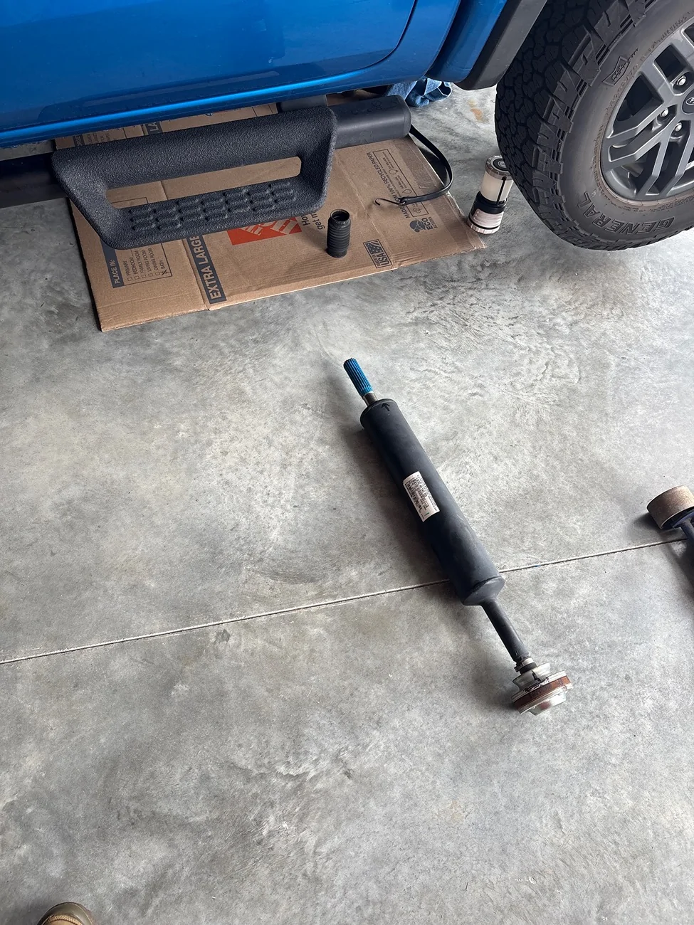

Yeah , i marked it ... and i did it with the tires on the ground so it wasn't even rotated. Not sure how I screwed this one up. First attempt it went in about halfway before I felt it resisting so I thought maybe too much grease so I pulled it back apart . After that each attempt went in less and less , maybe an inch or so and I would have to hammer it back off.

Thats what I wish I had done , put a jack under it and slowly let it slide apart, but not all the way...

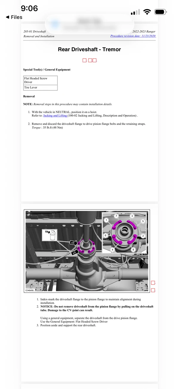

Question for the forum. @Stevedbvik1 makes dropping the Tremor driveshaft sound easy. Trying to work up the courage to do so, versus dropping the carrier bearing and trying to lube the joint that way instead. So the question is, do I use lock tight when reinstalling the small bolts holding that Rzeppa joint onto the diff? Also, any of you gurus know the torque spec for those small bolts?
Also, if the 🐔wins out, do I use lock tight on the bolts for the carrier bearing? I'm assuming so. Blue I would think?
Really not liking the idea of this project. Want the results. But not the potential 💩 show.
35 ft lbs
Clean threads on bolts and use blue loctite

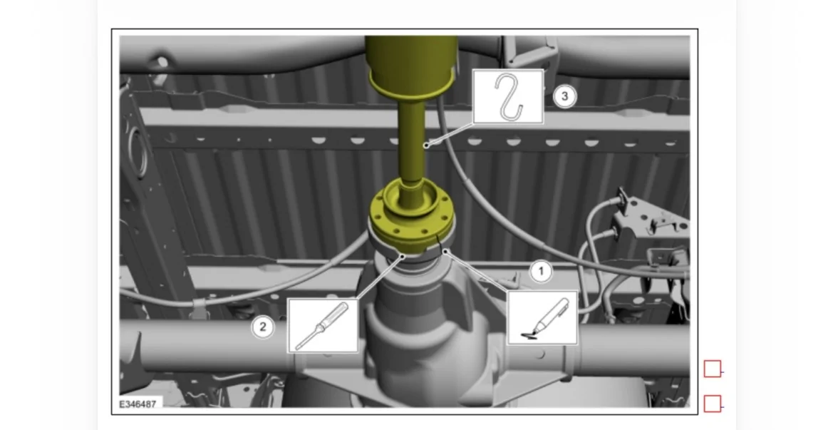

Here’s from the shop manual

For those of you who may be 🐔 to do the slip joint on the Tremor due to the weird piece at the differential, don't be. It really wasn't that bad. Granted at my age getting under and out from under the truck 6348 times was getting old. And probably not pretty to watch if I'm honest. And I'll feel a bit of it tomorrow. No doubt someone who's done it prior, or is younger... or both, you could have done it much faster. It took me 4 1/2 hours total. However, in my defense right after I got started I realized my torque wrench would not go down to 35#'s. So I had to go buy a new torque wrench. Deduct 30 minutes. Then when almost finished I realized I did not have any crimp type clamps that were large enough. So, that was the trip to O'Reilly's, Autozone and Advance Auto. Completely wasted trip. But all told that ate an hour. So, in reality, I did it in three hours. Which means many of you guys are probably looking at 1 1/2 to 2 hours. Score me at 3. I'm ok with that.
