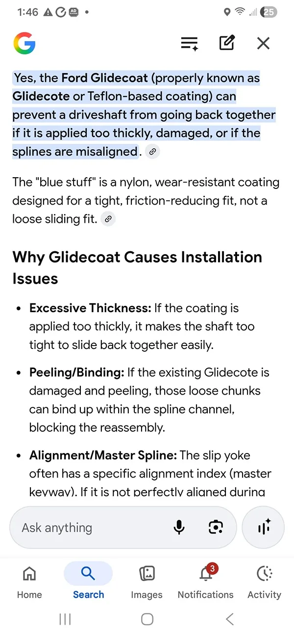

I guess that stuff is called "glidecoat" , but it seemed to do the opposite for me...

Good for first time use only.
