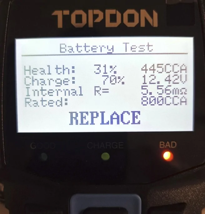

Our build date of 6/2020 puts the battery at 5.5 years. When not driven for a few days, I keep our CTEK MXS_5.0 battery maintainer plugged in. Haven't had any problems, but due to age, I wondered about the health. Checked with a TOPDON battery tester yesterday.
If the battery is this bad, then why aren't we having problems ??
I did not disconnect the battery. Is this the proper way to test ??

If your maintainer has a desulfate mode, I would run that. I saved my neighbors battery that was way worse than that.

It is very difficult to get the Topdon clamps properly connected to the battery with the bus work/clamps attached to get an accurate reading. If in doubt, remove the battery cables/connections from both battery posts and retest for the most accurate reading.
