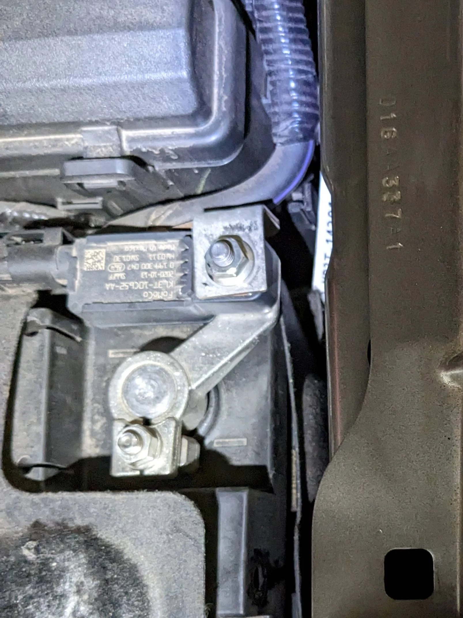

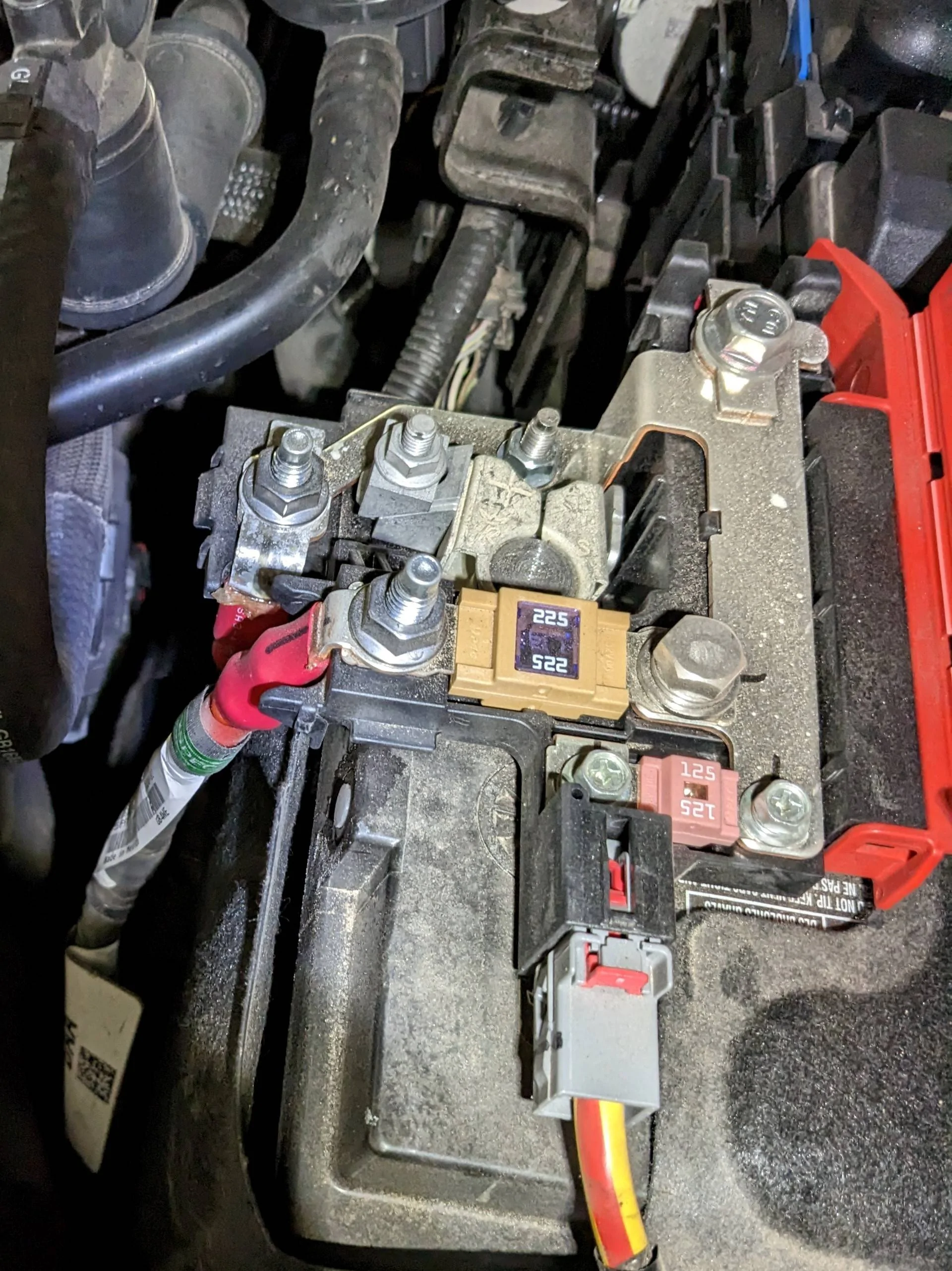

On the topic of battery chargers (Battery Tender), which point are you all connecting the charge leads too? I want to install the quick connect dongle for my Battery Tender to the Ranger's battery. However, there is a lot going on at the battery terminals (see pics). I watched a YouTube video from Ford mechanic (link, see around the 8 min mark) who suggested connecting battery chargers after the BMS (i.e. not directly to the battery terminals).
I only want to connect the Battery Tender as preventative. I do not have any weak battery symptoms at this time (truck is 2 years old, 24k miles). However, I do often leave the truck parked for two weeks at a time.
Connect the positive lead of the charger to the positive terminal of the battery and connect the negative lead of the charger to ground, not the negative terminal of the battery.

On the topic of battery chargers (Battery Tender), which point are you all connecting the charge leads too? I want to install the quick connect dongle for my Battery Tender to the Ranger's battery. However, there is a lot going on at the battery terminals (see pics). I watched a YouTube video from Ford mechanic (the link is posted somewhere on this forum) who suggested connecting battery chargers after the BMS (i.e. not directly to the battery terminals).

137,170

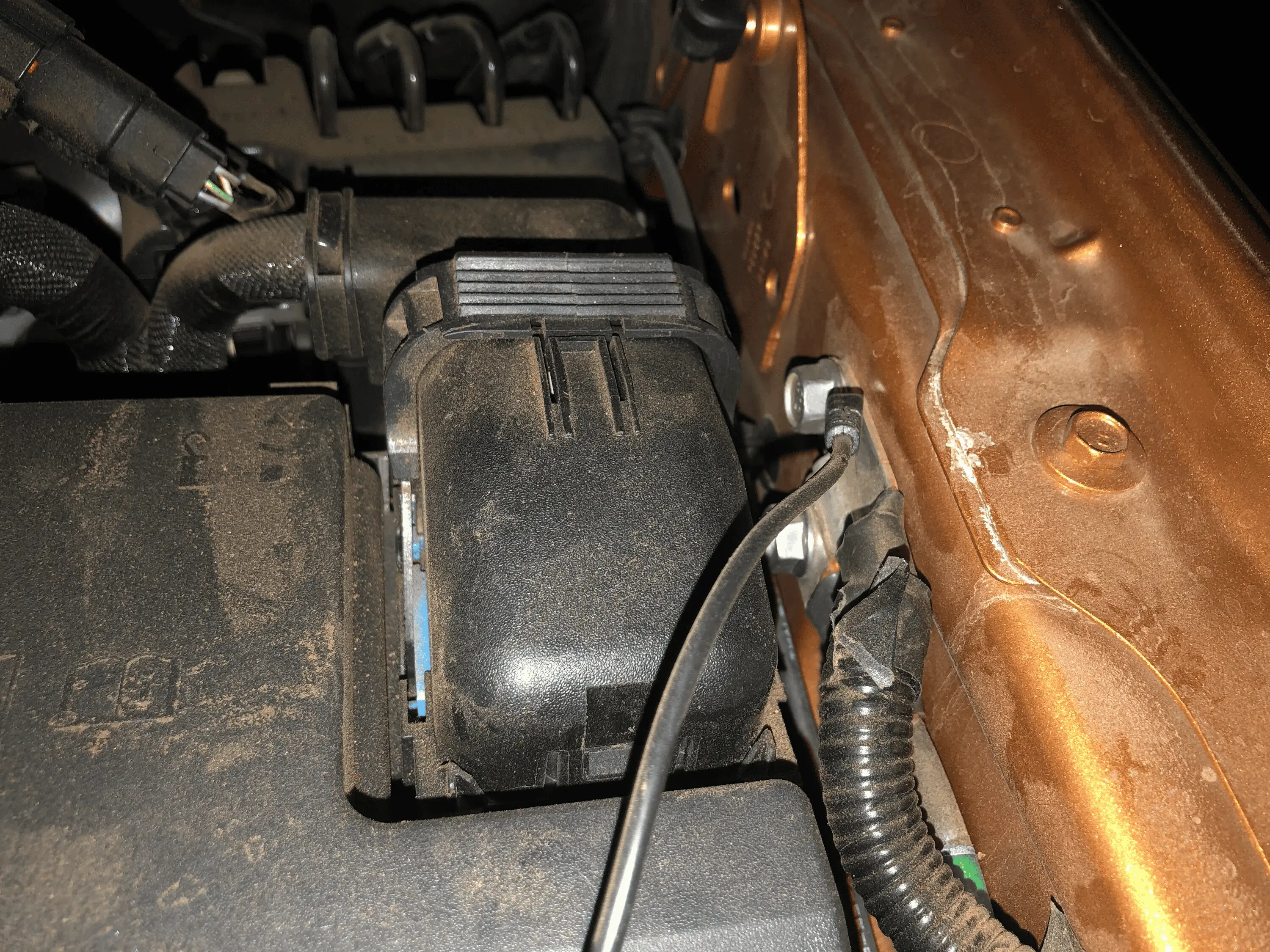

This! The negative should be connected here.
I know you live in the desert and I know you wash and wax your truck often, but Dave, lets do some cleaning under the hood, huh.
