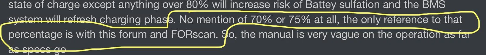

It’s about so much more than just voltage Roger. This is from the manual…

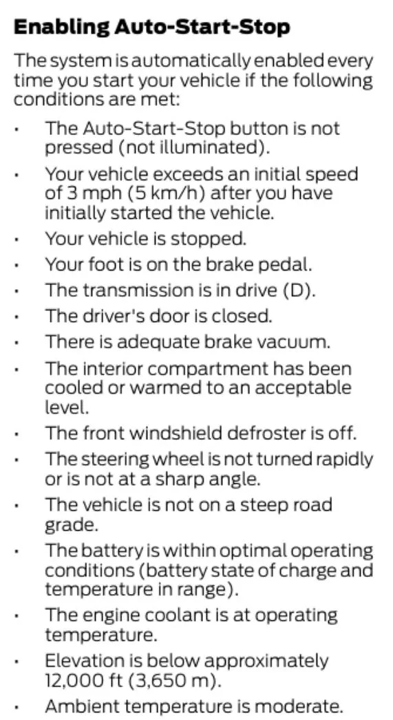

I am attaching the System Ops from the Manual.
I am wanting to know the Specific Voltage that trips:
1. ASS Off
2. Climate Control Off
3. Load Shed
4. Deep Sleep
If we can determine these specs, it would be easier to watch for as owners, than my ASS stopped working (Is it a sign my battery is failing?) which appears to be the most common
or my Inteligent access stopped working is a sign my battery is failing
I'm just a mechanic trying to find an easier solution than guess work on this system but need specific specs on its operation

Well, I’m not sure I’d put too much stock in this “gaggle of retirees” and a 3rd-party software solution. Any of us could have made that figure up while on the Friday night drunk posting thread. ?
