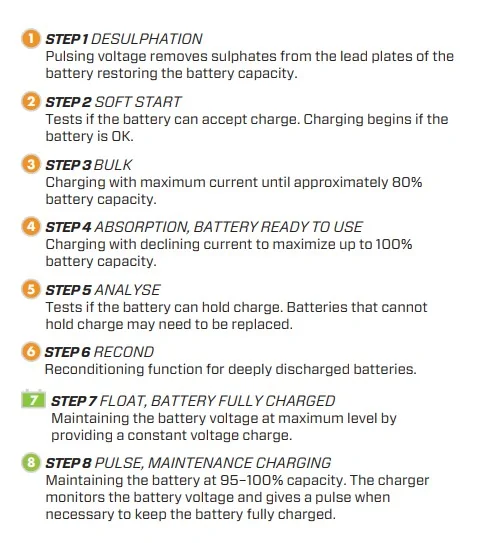

If your maintainer has a desulfate mode, I would run that. I saved my neighbors battery that was way worse than that.
CTEK Step 1 is desulphation.
