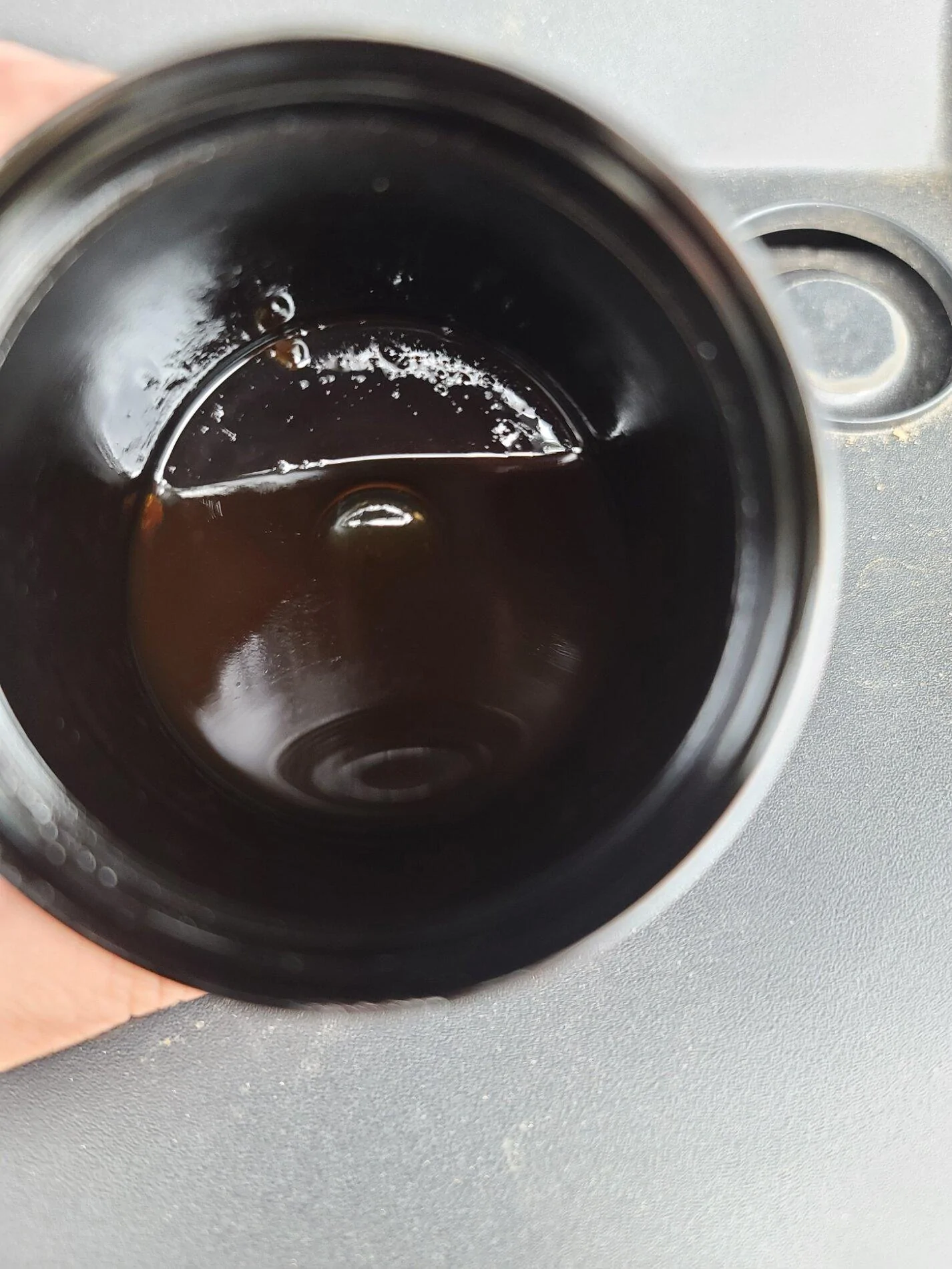

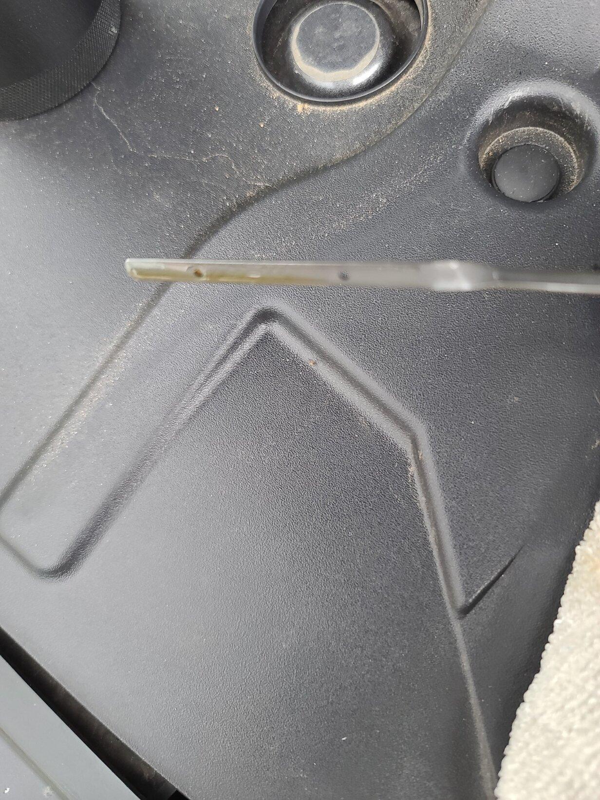

I haven't smelled any fuel in the oil or seen anything unusual. But, here are the pics from my last catch can dump. It was 1500 miles after the last dump and the 10K oil change. I can't tell you what it is actually catching, but it seems to be more fuel since it evaporated so fast after bumping it in the oil drain pan. And as you can see my dipstick looks normal. Mostly highway miles at 60 to 75 MPH.

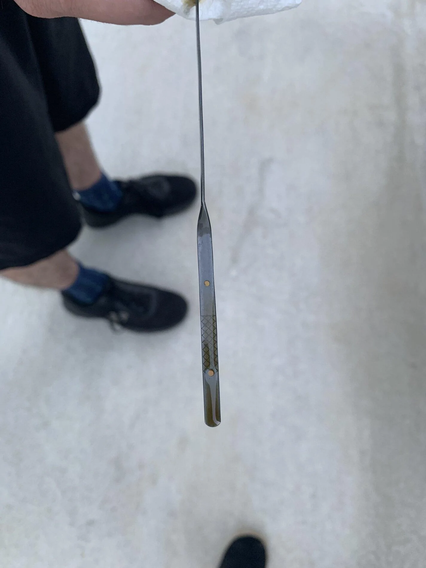

Well mine is at the dealer now for this problem.
Had the dealer change oil and filter at 2500 miles as the level was above the hole on the dipstick.
I thought possibly just the factory fill and rings seating, etc. but was aware of others having this issue so I wanted to be sure.
The dealer recorded the level and I drove it another 2000 miles.
Checked it yesterday and it was over the hole again.
Dropped it off this morning and dealer confirmed high oil level and the smell of fuel.

Update:
Dealer just called and said that my HPFP was the problem.
One is on order and I should be able to pick up the truck Monday or Tuesday.

The HPFP is driven off the camshaft, so if it is leaking the fuel can mix with the oiling system.
I don't know if there's an updated pump or if I just got a bad one.
I had no other symptoms besides the oil increasing.
I'll be watching it closely to see if the problem is indeed solved.
I certainly hope so as aside from this issue I really like this truck.
