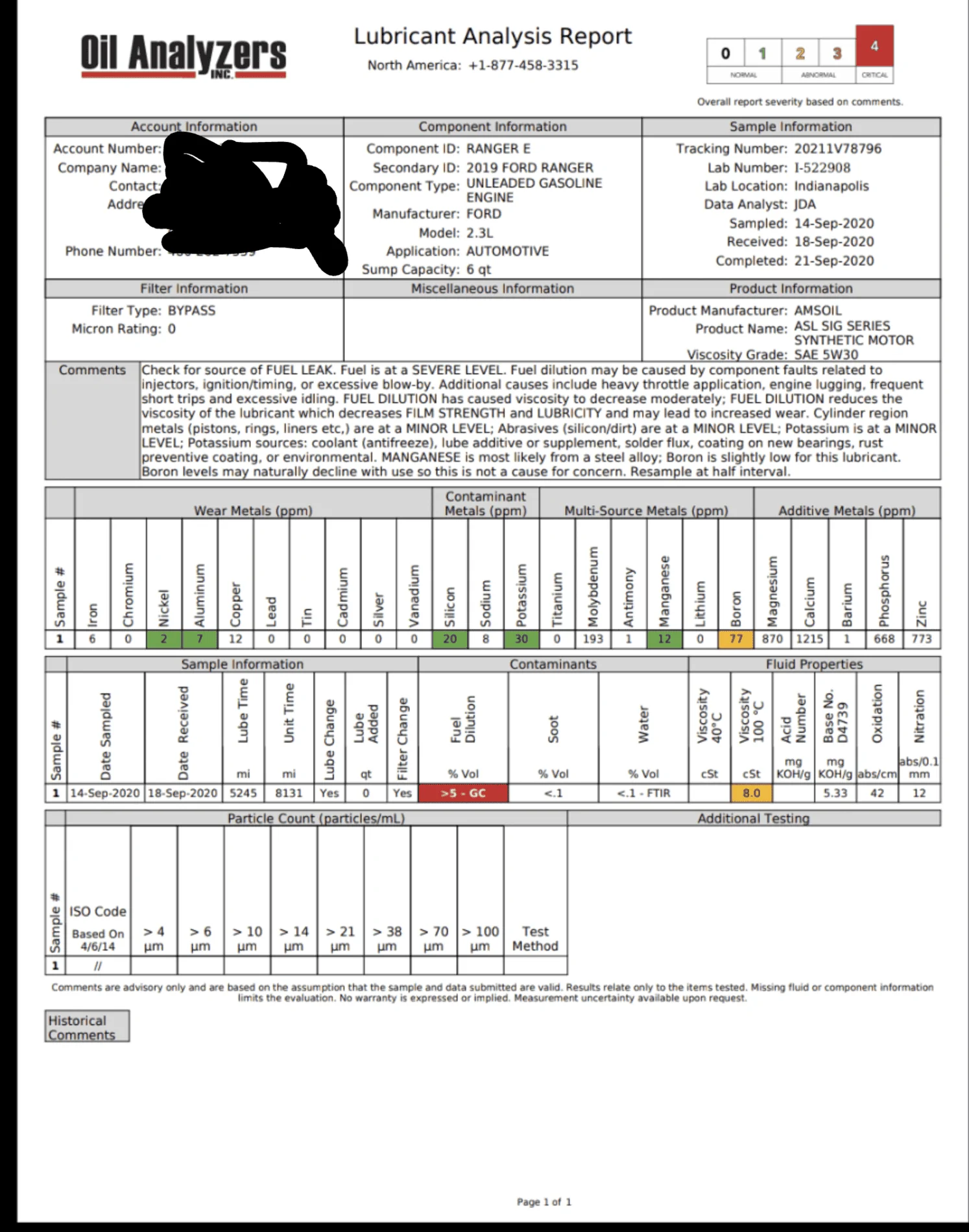

After replacing the injectors a 2nd time, my oil level was creeping up every day and was 1/4in above the max hole after 300 miles (about a week). At that time I tried contacting Ford Customer service, but my rep has gone missing in action. For the past week and a half, I have left her several voicemails and a couple emails to call me back, so far no reply. In the meantime the level continues to rise and at 600 miles, the oil should be changed again as it is at the level that came back at 12% & 13% fuel dilution in past samples. I spoke to the dealership and they do not know what else to do, short of an engine replacement (their words). So I called Ford Customer care and spoke to a supervisor. I said I think my rep is on vacation, but they told me that was not the case and that they would have the rep call me soon? So I am waiting to hear from Ford as what to do next.
I'm baffled, the compression check was within spec, the leak down test was within spec, the HPFP was replaced and injectors have been replaced twice. There really is nothing else left to explain this? I believe they would have replaced the HPFP a 2nd time, but parts are not available until November? It may be buy back time? If so, I will push for a replacement. Oh yeah, I have an appointment after work tomorrow for the AC that has not worked since the dealership swapped the injectors and HPFP the first time back in May. It's odd, blows ice cold when its below 65 degrees, and gets worse after that and by 75 degrees outside, it is not cold at all. I have not seen condensation drip beneath my truck all summer long, used to see a river under there. It's nuts that it hasn't bothered me more, but I was more focused on the fuel contamination issue getting fixed.
I'm getting ready to send an oil sample off, have a little over 400 miles on the oil change and it has risen to just at the top of the upper hole. I tried to tell my dealer were I thought my fuel dilution was, wouldn't take my word for it but said they would except test results. I've dealt with it long enough now I can perrty much tell how much fuel dilution I have. I will give him test results and recommend they change my injectors which has not been done yet. Hopefully in my case that fixes it or I will be in the same boat as you. Hope your case turns out the best for you, we shouldn't have to deal with this after spending the amount of money these trucks cost!!
