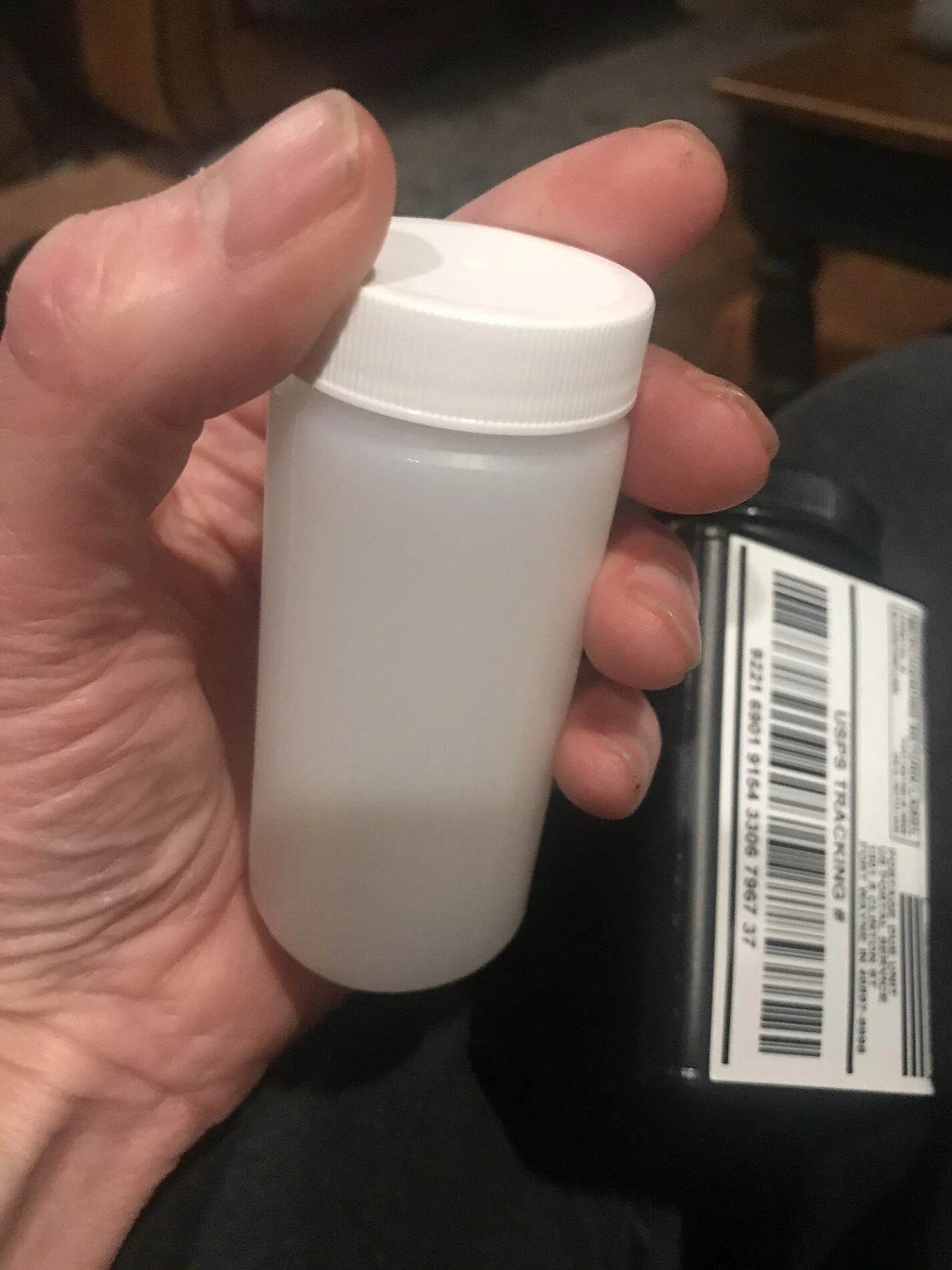

My appointment got rescheduled until two weeks from now when I will be at about 1200 miles. I really want to send a sample to black stone for analysis.
