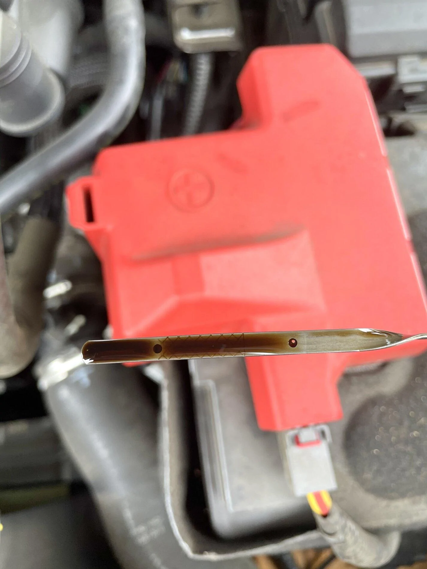

I ordered my oil analysis kit today. I am going to try to get a sample tomorrow in anticipation. I have a small glass vial with a lid I can keep it in until the kit gets here. I want to get this captured before the truck goes in for service as I am obviously going to request that they change the oil.
How are you all getting the sample? I was thinking a small tube down in the oil fill port and draw out a sample that way. How much do you usually send into black stone?
I am thinking I might keep my truck parked until my service visit since it’s almost two weeks out. What a pain in the a$$. My oil is currently at or slightly above the twist. I don’t even feel like it’s a good idea to drive my brand new truck considering how much gas in clearly in the fuel.
