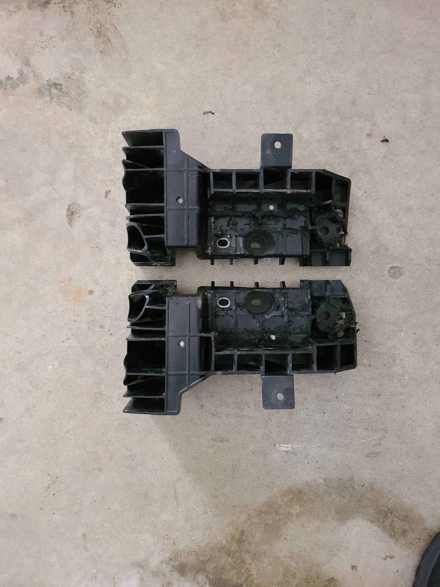

I remove the plastic behind the front tires and gave me a bit more clearance.
Yeah my dad worked on Pendleton for awhile. I did the same. I may trim those and put them back on though

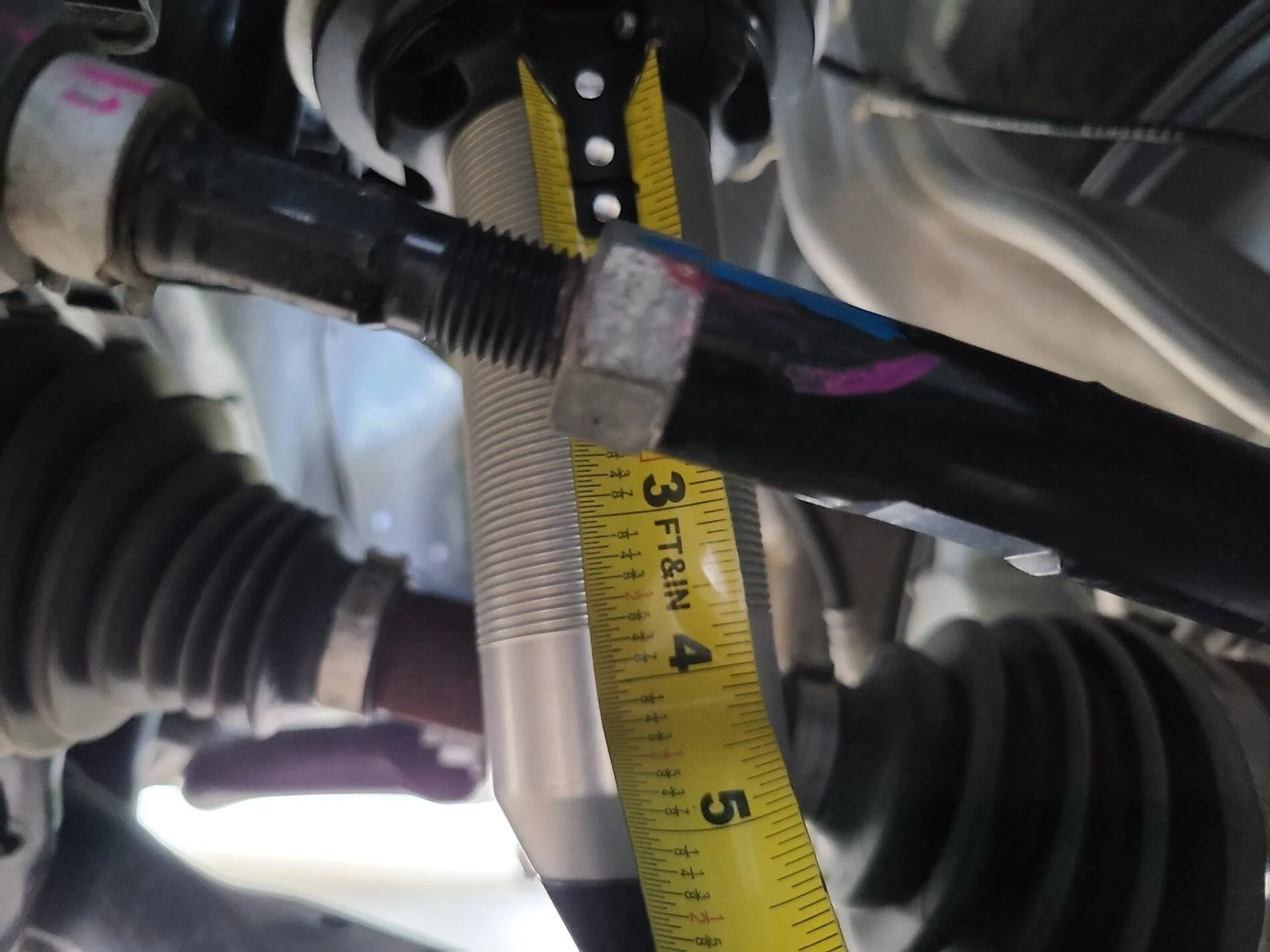

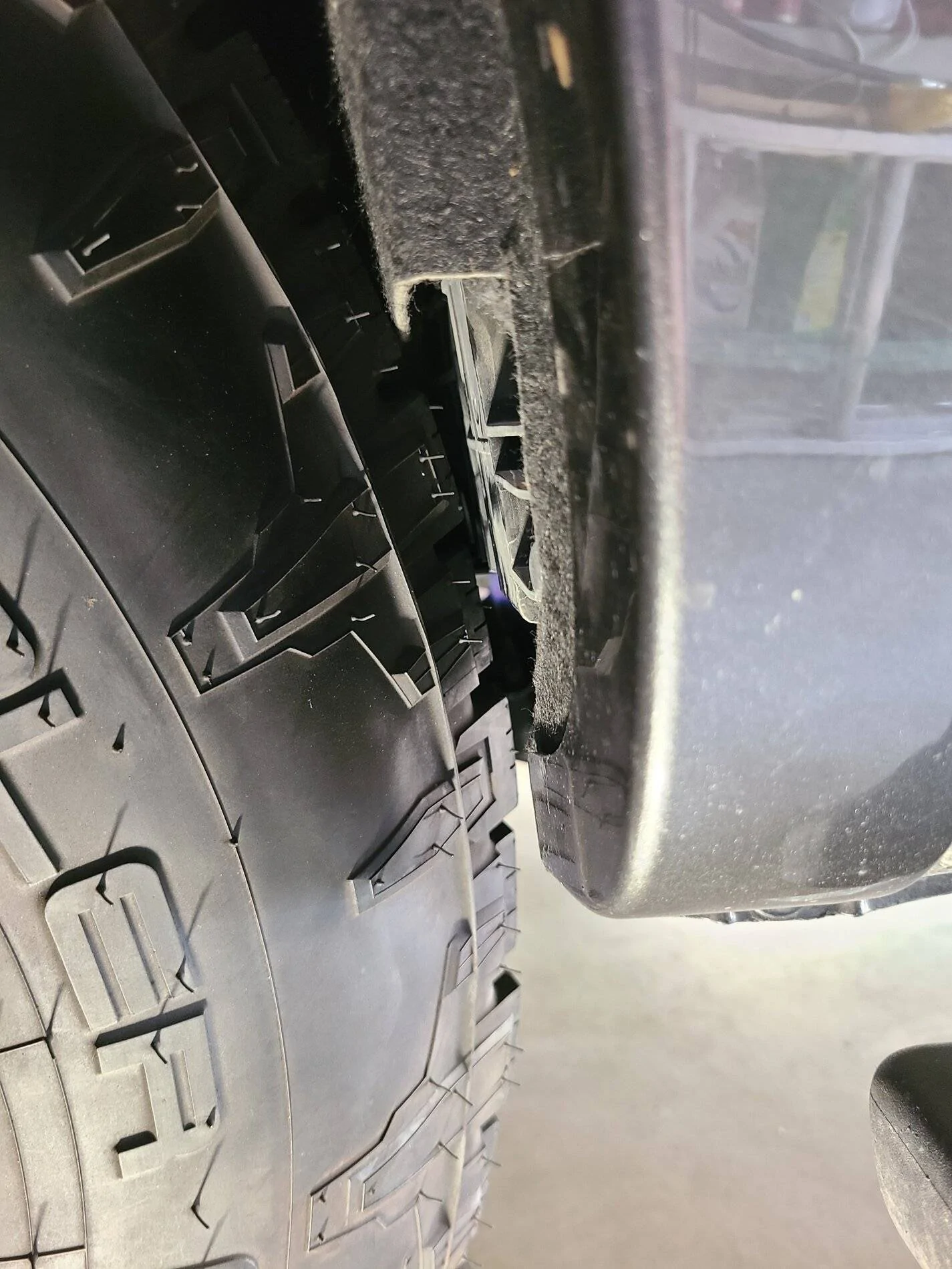

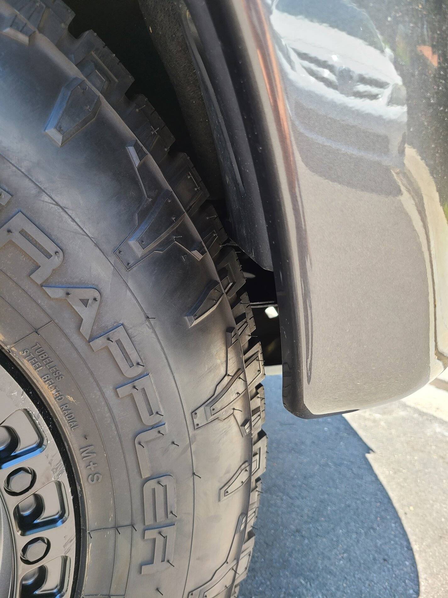

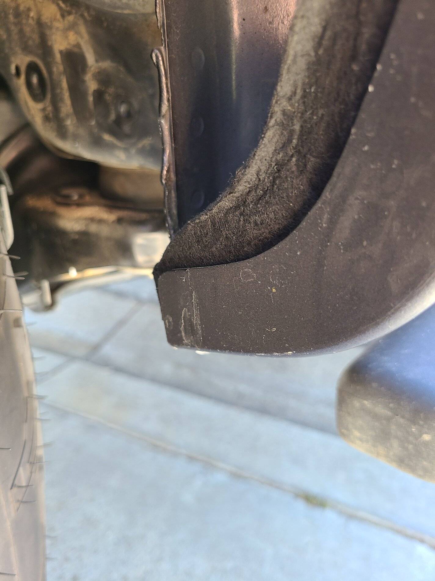

That's what I'm trying to find out, I had 4WParts installed my Fox 2.0 last year and I ask them to pre load it at 3 but I think they said 2.5 or 2.75. I need a setup that can get me to 3.5 and I'm currently looking how to up grade. The first pics is I think my Fox 2.0 is setup at and the after removing the plastic on the firewall the only thing rubbing is on the 2nd pic. A small piece of the fender flare. My wheels are 0 offsets. Rob from Rangerlift said I can used his 1 inch lift for the Tremor to get a total of 3.5 inch.

Okay yeah you’re rubbing because of the offset too. I’m at 3” lift with a +18 offset and the only functional rubbing were the crash bars but I changed them. You could use a spacer (what I’m guessing Rangerlift is talking about) but again you may be straining the suspension at the point
