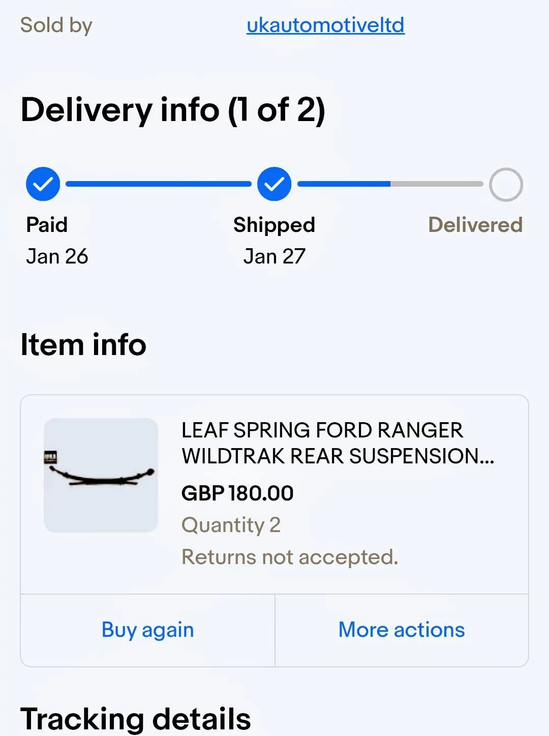

I broke one of my leafs, but I was running jeep trails. I replaced them with wildtrak leaf packs from UK and they're awesome, especially for 300 bucks shipped.
$300!?! Do you have a link or was this a one-off type thing? I'm very interested.

I was on the Ebay page where I bought the UK multi-leaf set (they are currently out of them) and they had what appeared to be monoleafs.
