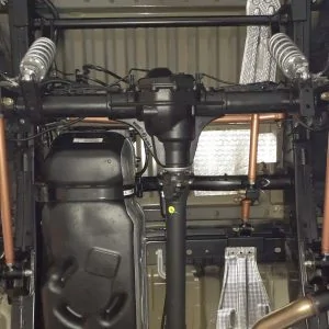

That is a good solution if you want to spend the $25k or so to link the rear end of the truck (which I think has been done once and is pretty cool), but on any good aftermarket rear shocks, the shocks are no longer the limiting factor in either compression or rebound situations, the leafs are.

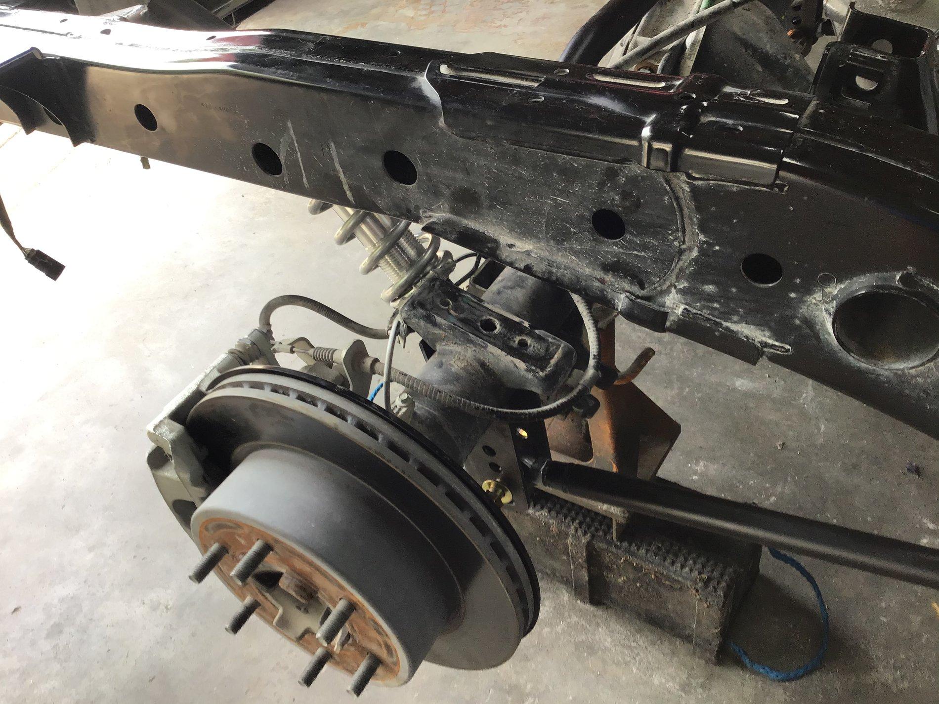

$2200.00..

Cool! I'm glad someone figured out a less crazy expensive way to do it. Granted I still (for my intended purpose) prefer leaf springs and it was yet another reason I bought the Ranger specifically. But if it is just for decent to well paved road comfort someone is looking for, there are tons of other vehicles better at that than the ranger and cheaper so I've never quite understood the need for the conversion.

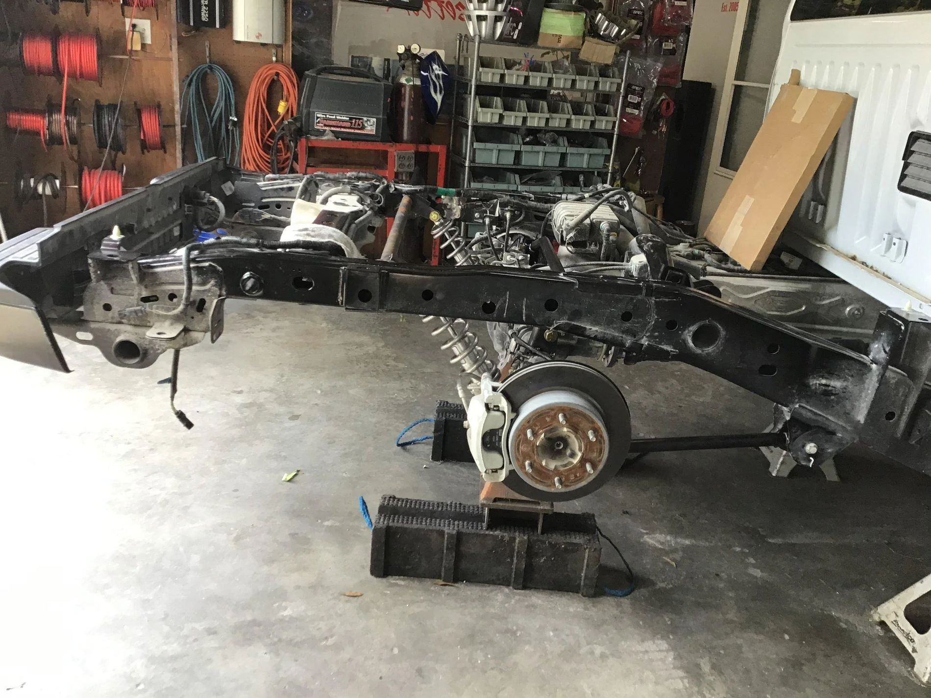

I’m setting it up for drag racing..we rednecks here in north fla like to race trucks:)
Regards
Haha ok more stable than a sway bar and leafs makes sense for that application. For offroading I'm going the other way, designing leafs and then traction bars.

So Doc, did you lose the springs all together? I'm wondering if this route would be something to explore for a street truck?

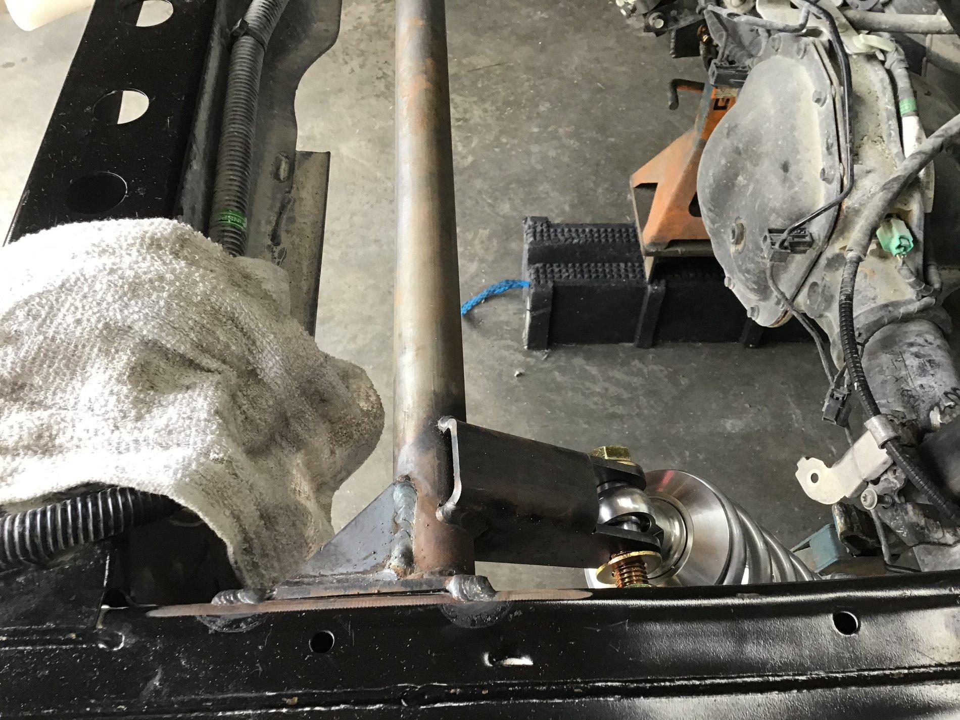

Yes, just adjustable Coilovers. Still in progress.
