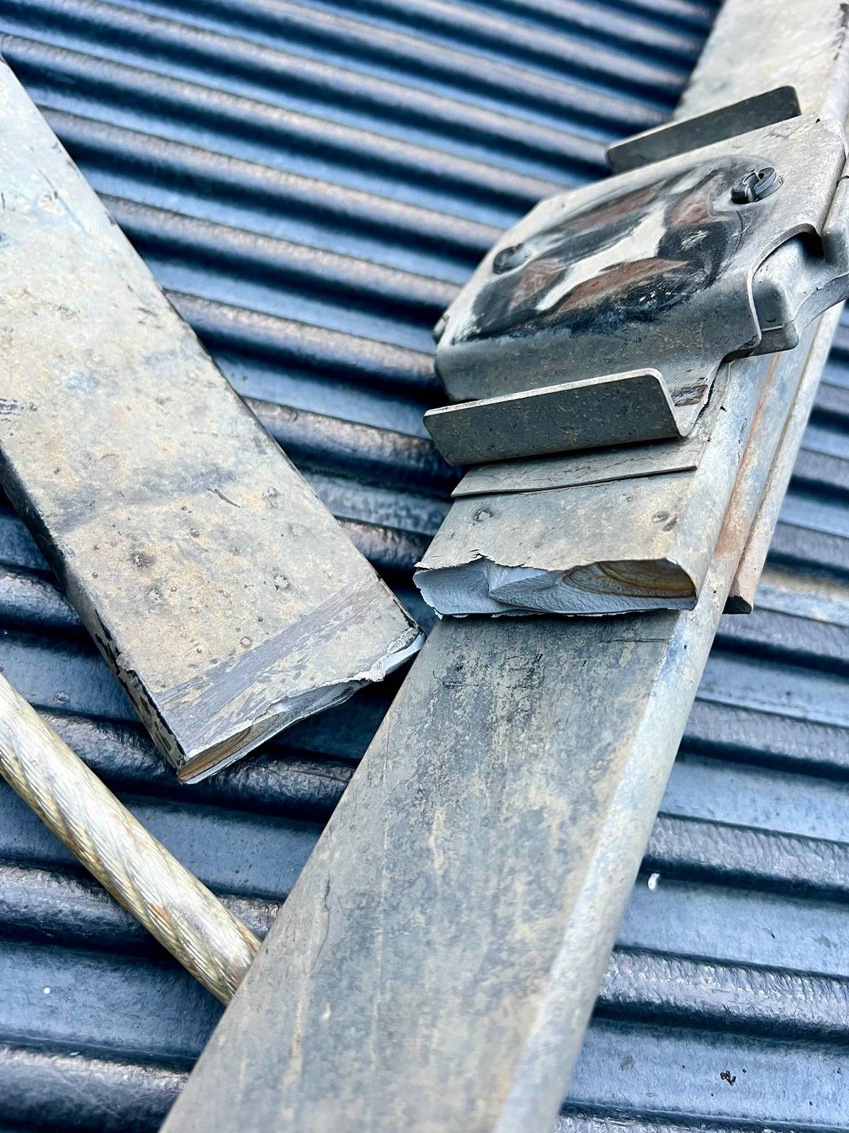

The darker part on the break makes me think it was cracked for awhile or a problem with the metal

Thanks all. It was a clean break.
Zappy: It is unbelievably clean, like new!
The break is on the other side of the eye holding the brushing? Still need to see any break pics...

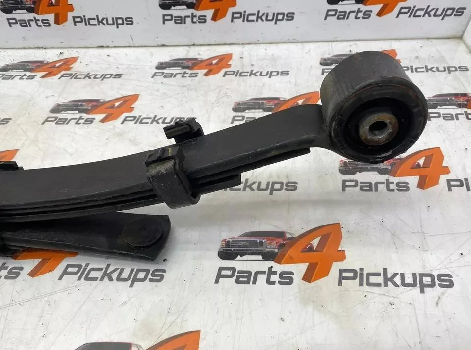

Just a tidbit of information for the curious as I saw something that sparked my interest.
Ref: The Ebay Link above for the Wildtrack springs
This pic is taken from that
Note the cross divots in the coiled end, more notably is it appears to be thinner at that point. Bushing hiding it? Maybe
But I was curious on what the divots were all about, since it appears (not yet confirmed) that the OP's Leaf Springs broke at this point.
Since I was in the garage, I decided to see if my truck had these same divots.
If you reach up from the bottom you can feel these divots with your finger.
So, this is possible way to know if your springs are splitting open at this point, if you feel a wide gap.
These are divots from the mfg process, if interested in how they are made - view video link below and you can see the clamping (rig) that is used to roll the end produces those indention divots.
Ref Link Below:
How It's Made - Leaf Springs - YouTube

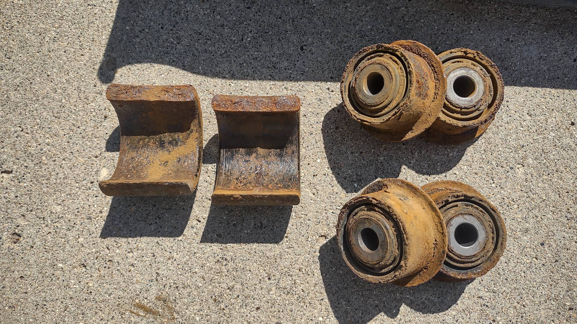

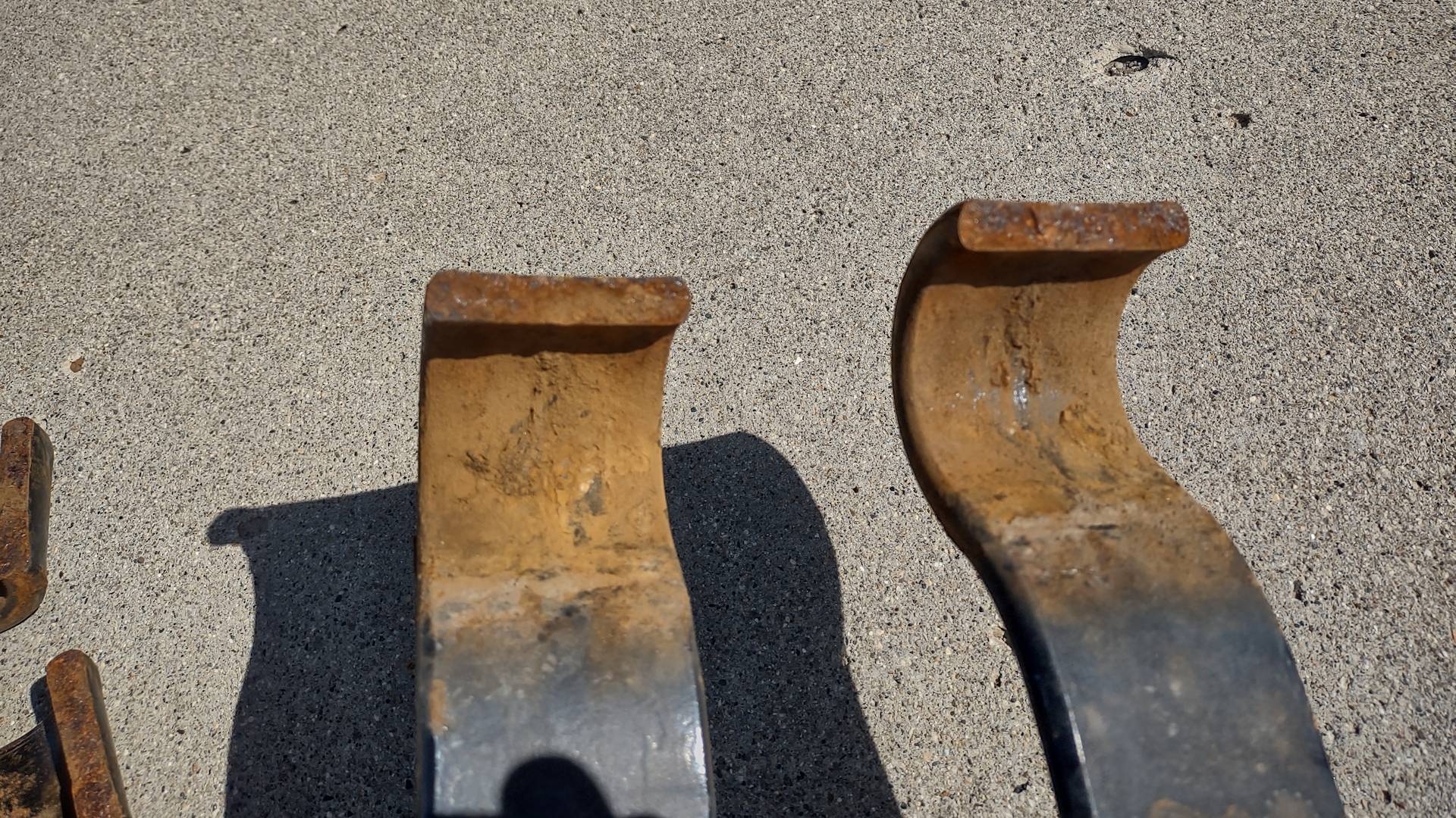

Ford installed new OEM leaf springs this morning. I will attach photos of the broken eye mounts and bushings. The rear eye mounts looked pristine. The mechanic noted that the cracked off parts were rusted so the cracks probably occurred some time ago. I honestly cannot think of a time when I drove or hauled in a way that even came close to exceeding the truck's specifications.
I reached out to Ford via their website last Friday and on Monday I received a phone call from my assigned Ford Advocate. She told me this would be covered by warranty. Parts were $860, Labor was $527 and Minnesota sales tax was $71.67. I also indicated that I would like to get the old parts to a Ford engineer but there does not appear to be a mechanism for that.
I appreciate all of the replies to my post - it supports this was likely caused by a problem with the spring. And, I am now well educated on leaf springs.

Those are rusted to shit. No wonder they broke.
Bull Poopie.....I've bought used vehicles that were 30 years old and lived their entire life up north and aside from surface rust, have never seen springs like that rusted thru, especially after only 5 years.
