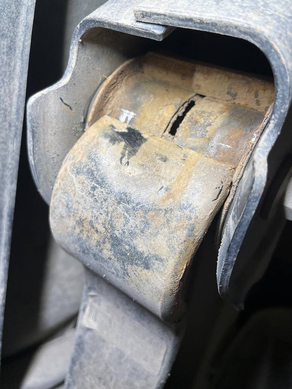

The amount of surface rust on the springs is not surprising for Minnesota winters. They are not "rusted through" but have been broken for a while. Lifting the truck and taking the load off the springs brought the issue to the forefront. The popping sound was probably the spring slipping off the bushing.

Yep. I am a railroader and when you break a knuckle or a drawbar on a car the first thing the manager looks for is if it is a new break or an old break. They can tell by how much rust is on the surface of the break. Generally if there is more than 50% rust on the surface they consider that an old break and not the Engineers fault. Anything less than that, you are looking at some discipline for poor train handling.
That is 100% percent old break with the rust covering the surface of the break. Must have been broken for a bit.

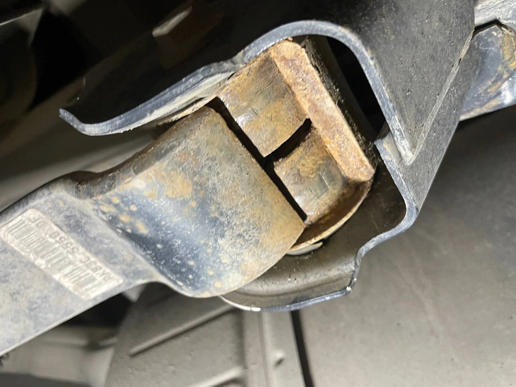

Ford installed new OEM leaf springs this morning. I will attach photos of the broken eye mounts and bushings. The rear eye mounts looked pristine. The mechanic noted that the cracked off parts were rusted so the cracks probably occurred some time ago. I honestly cannot think of a time when I drove or hauled in a way that even came close to exceeding the truck's specifications.
I reached out to Ford via their website last Friday and on Monday I received a phone call from my assigned Ford Advocate. She told me this would be covered by warranty. Parts were $860, Labor was $527 and Minnesota sales tax was $71.67. I also indicated that I would like to get the old parts to a Ford engineer but there does not appear to be a mechanism for that.
I appreciate all of the replies to my post - it supports this was likely caused by a problem with the spring. And, I am now well educated on leaf springs.

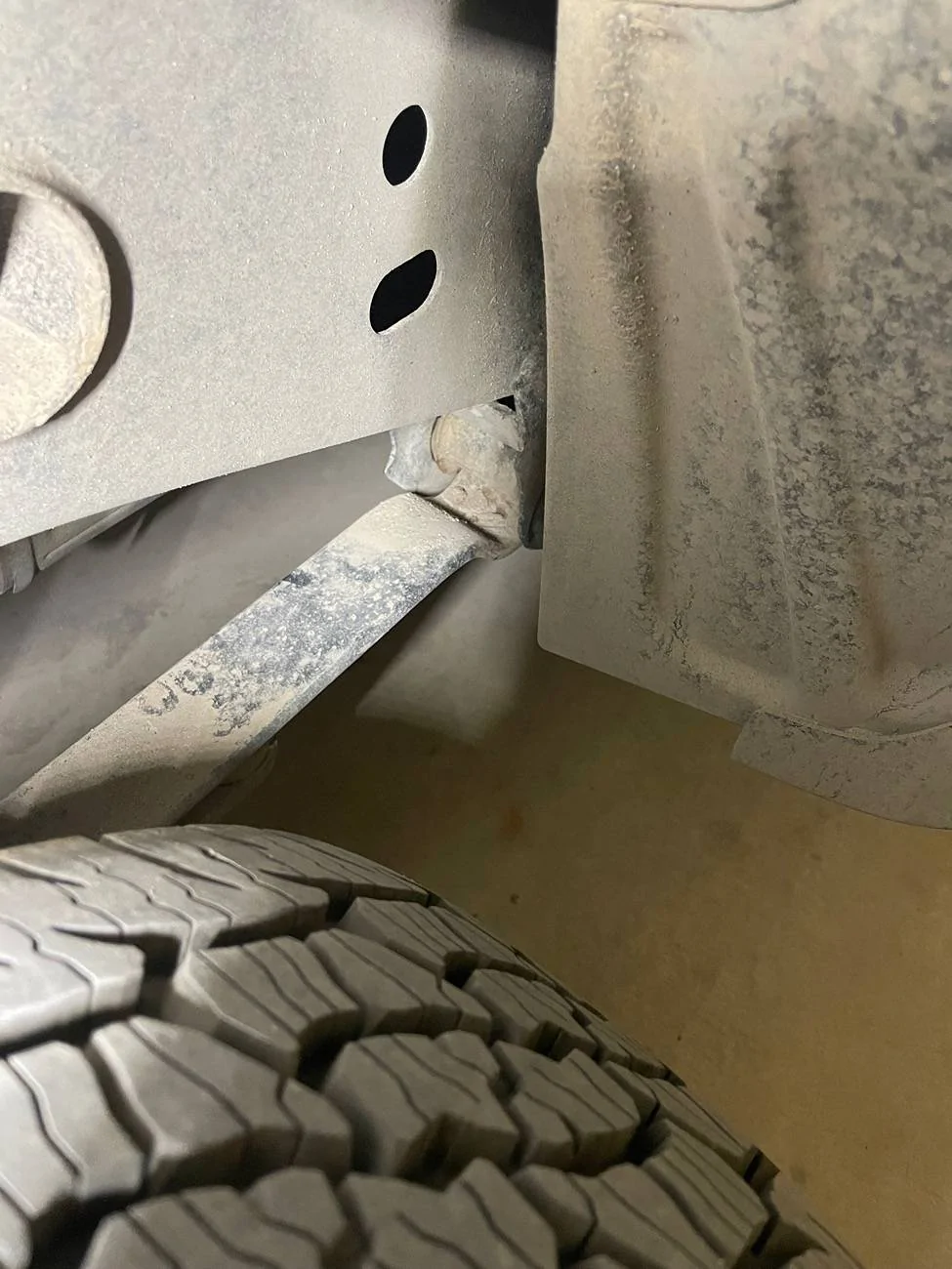

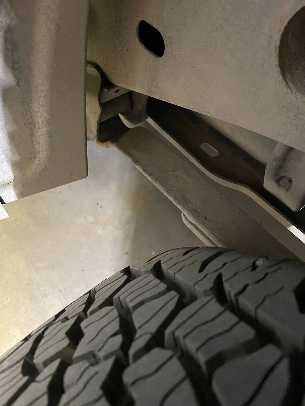

My springs look almost identical to this. 2019 ranger. Going to call the dealership tomorrow to see if they will replace them. If not I guess I’ll do it myself out of pocket. My ranger is no longer under warranty and only has 42k miles. Replaced the shocks already because the leaf springs being bad made the rear drivers side go bad.

2019 Ford Ranger XL with 47,000 miles. I brought my Ranger in for an oil change this morning. As the mechanic lifted the truck, the forward leaf spring mount holes (sorry I don't know the correct term) broke on both sides and the leaf springs detached from the mounts. I could see through a large window into the service area the mechanic and service desk person looking at the mounts and they called me in right away. While my first instinct was to blame the mechanic (due to the improbability of this happening) it looked like the lift was placed correctly. I searched this forum and the Internet at large and I do not see many instances of a leaf spring failure like this and certainly not both springs failing at the same time. I never carry heavy loads, never go off-roading, and only tow my 14 foot fishing boat to a local lake about six time per year. The Ranger is kept in a garage. I am in Minnesota so I suppose winter time salt could be a factor. Is there a known issue with the leaf springs?
I took these pictures

here are some pictures of mine still on the truck. They look identical to these. I am still waiting to hear from the dealership tomorrow see if they will replace them.

Ford is not going to replace them so I am going to do it myself. I’m going with the icon. This is sad because it’s for sure a defect but because it’s outside of warranty they won’t replace it.
