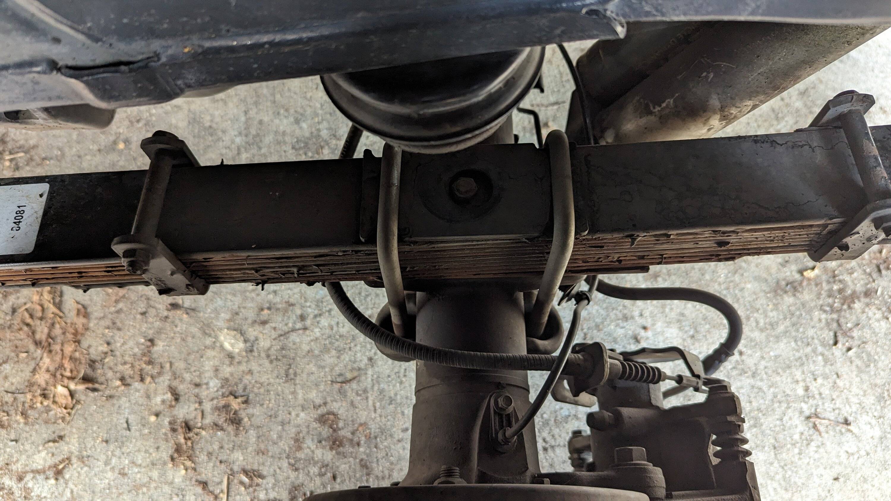

Been feeling a little loose like the chassis was gonna fall apart from the cab and my truck looked crooked. Couldn't see my u-bolts so I stuck my phone in the wheel well and yea I found out why my rear axle was so crooked.

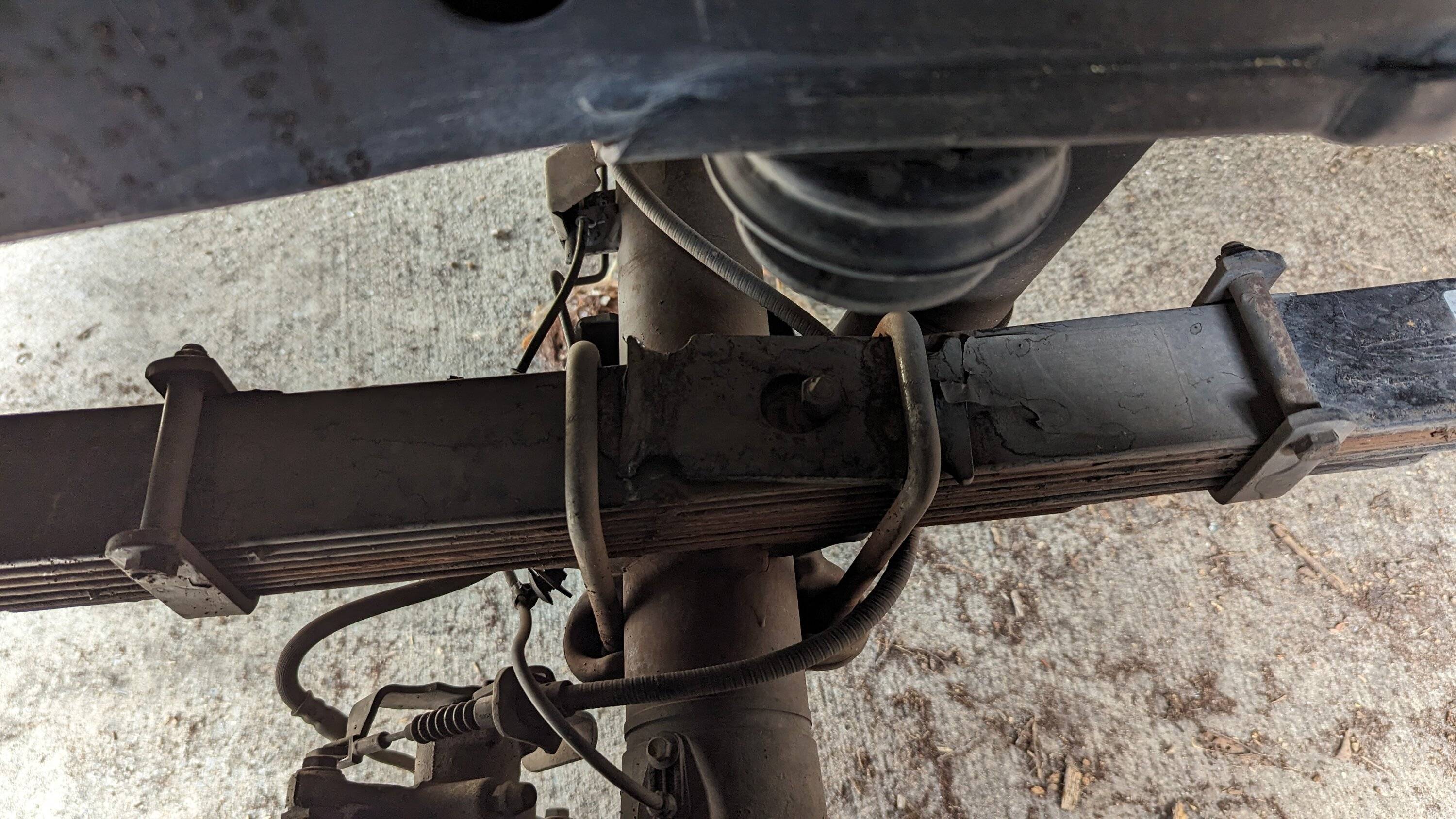

Definitely do some investigating there. I'm curious if all that causes it was the U-Bolts coming loose

Looks like my u-bolts broke loose from the plate and the rear axle is now scooted back on the right side because the plate isn't keeping it from going fore/aft.
As @Frenchy mentioned, that needs some close investigation. If that top plate is the Deaver design (it doesn't look like the Ford one at all) I think you'd have a potentially disastrous failure of the rear suspension likely while in motion. I'd address it with them right away. Are/were the U bolts stock?
That plate is their design. Those u-bolts and plate came with the springs. I used what they gave me.
