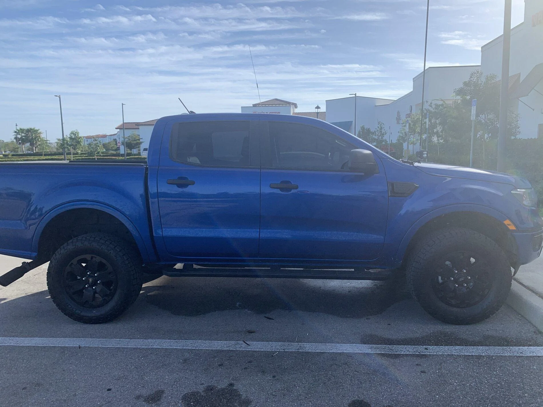

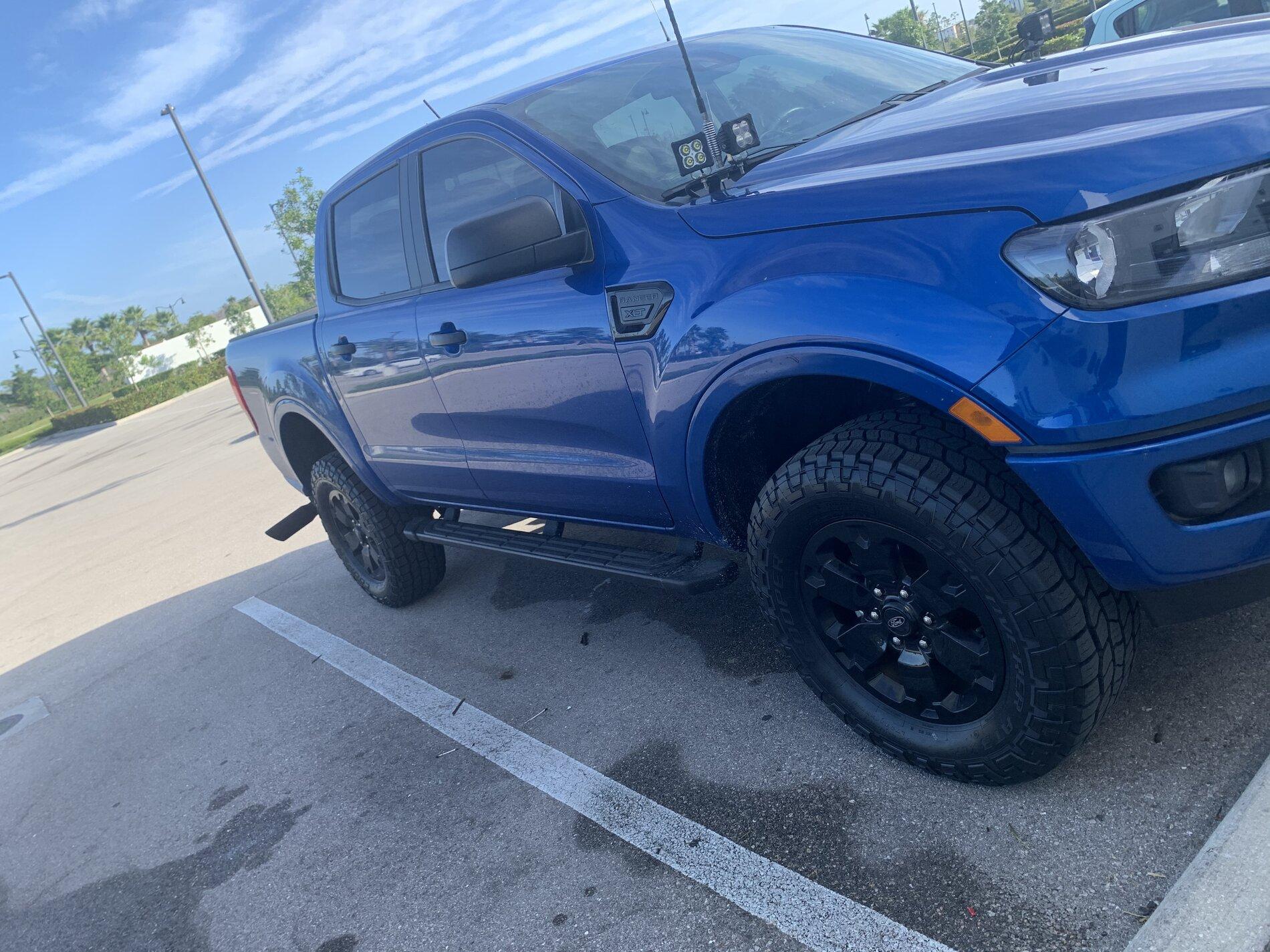

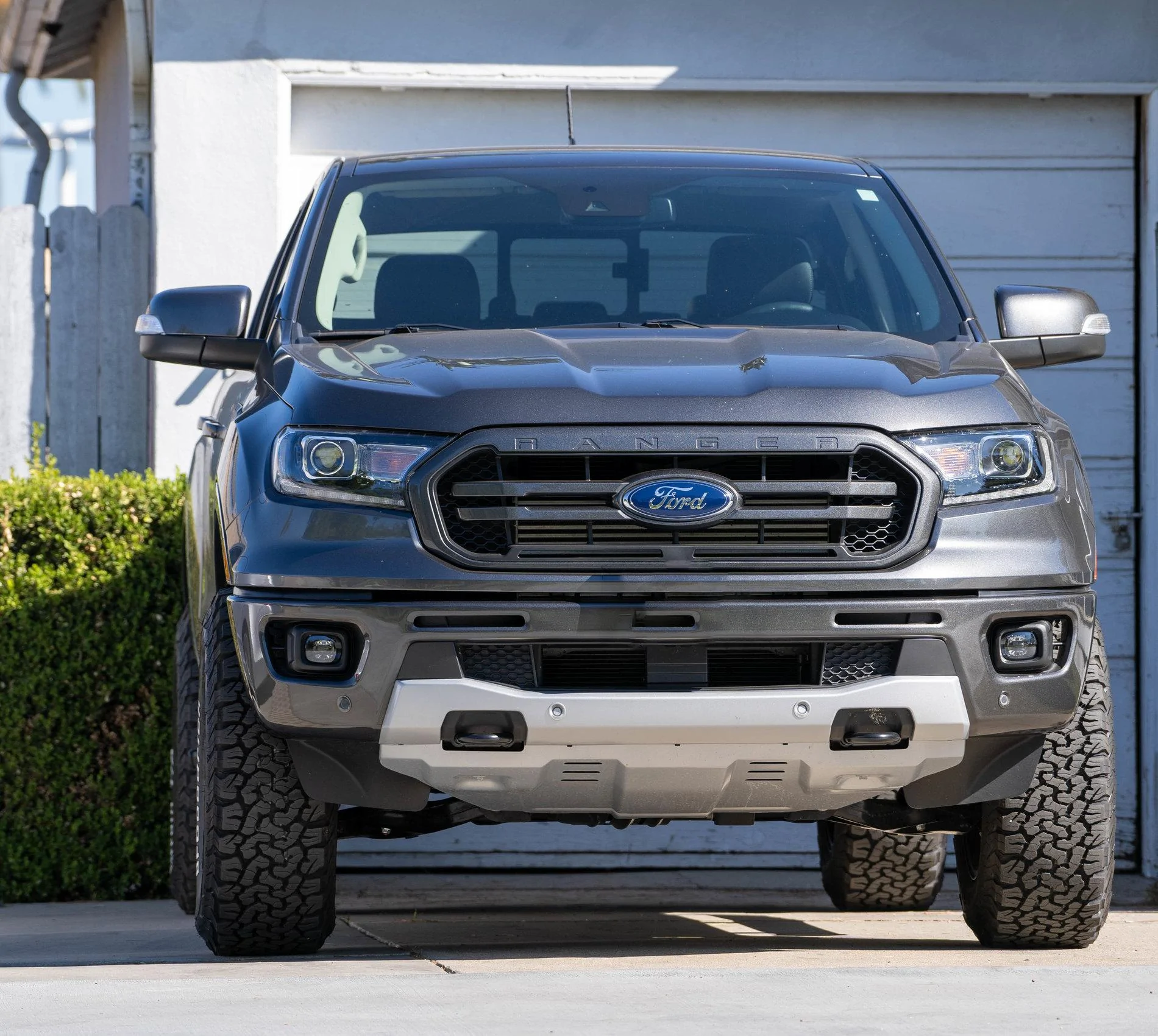

Just wanted to contribute something that would have helped me when I was deciding what tires/wheels I wanted. On 2 separate occasions in less than 7,000 miles I've had rocks cut into my stock hankooks; once just enough to cut/lodge itself in the rubber, the other time actually puncturing the tire. I wanted something that would inspire a little more confidence on trails and also fill up the wheel wells a little better. Finally settled on 265/70/17 BFG KO2's.
I also really liked the looks of the Fuel Shoks that I've seen a few users her put on their ranger so I decided to change everything at the same time. It seems pretty well accepted here that 265/70/17's will fit with no issues, but for anyone also looking to change out their wheels, this was not the case for me. The Fuel Shoks have at most a +20mm offset vs the stock +55 and they are an inch wider as well. I was able to move the crash bars and get most of the clearance I needed, but there was still some rubbing at full lock, especially in reverse.
I ended up with two choices: custom crash bars or leveling kit. I went for the Ready Lift 2" leveling kit so as not to lose too much of the factory rake and I'm really happy with the results.
Wheels are basically flush with the body now so the truck has a much better stance IMO. The BFG's also seem to ride better than the Hankooks so far with hardly any difference in road noise.

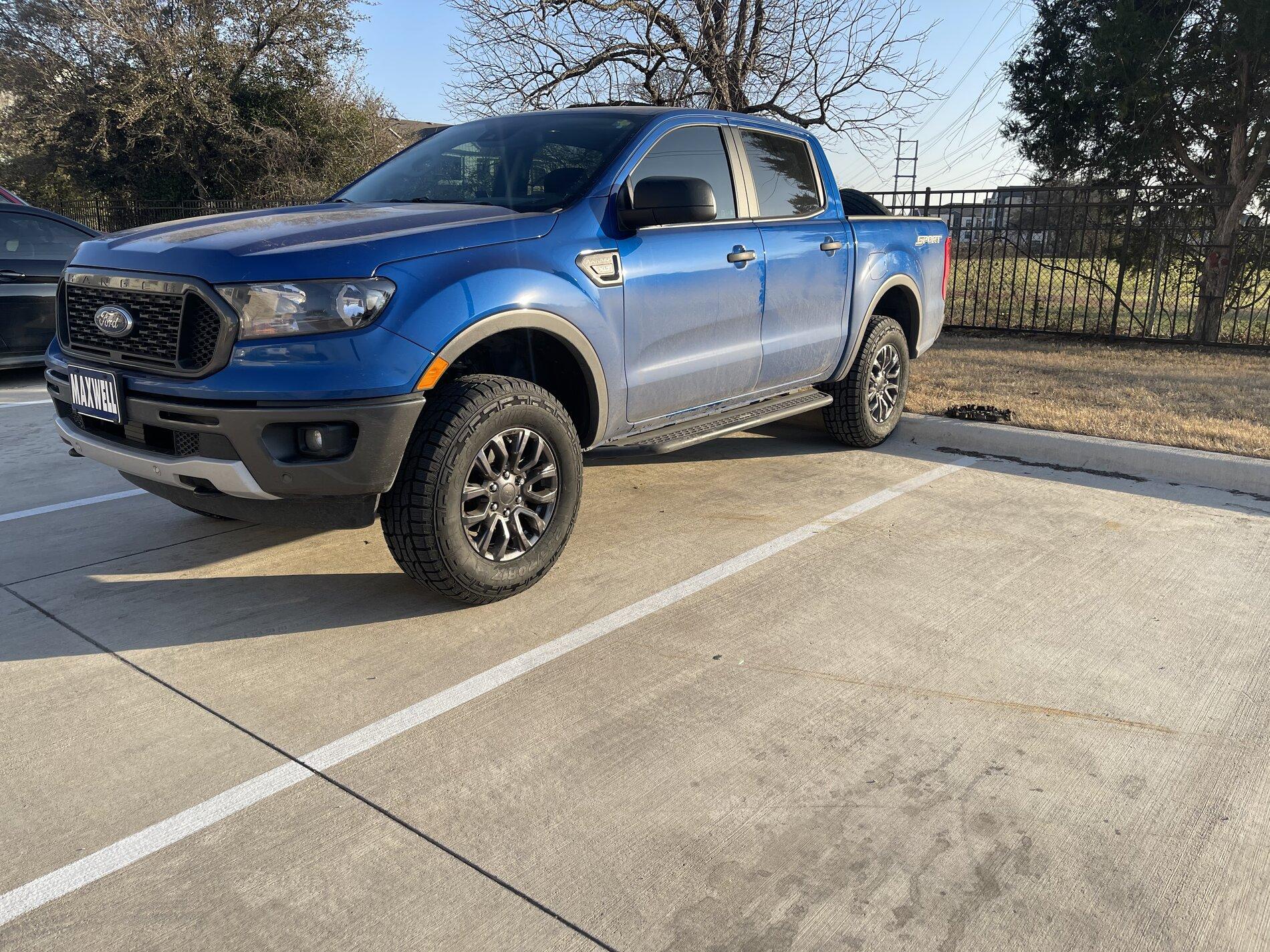

I just fitted 265/70/17 with a level kit and it looks like I could have gone bigger

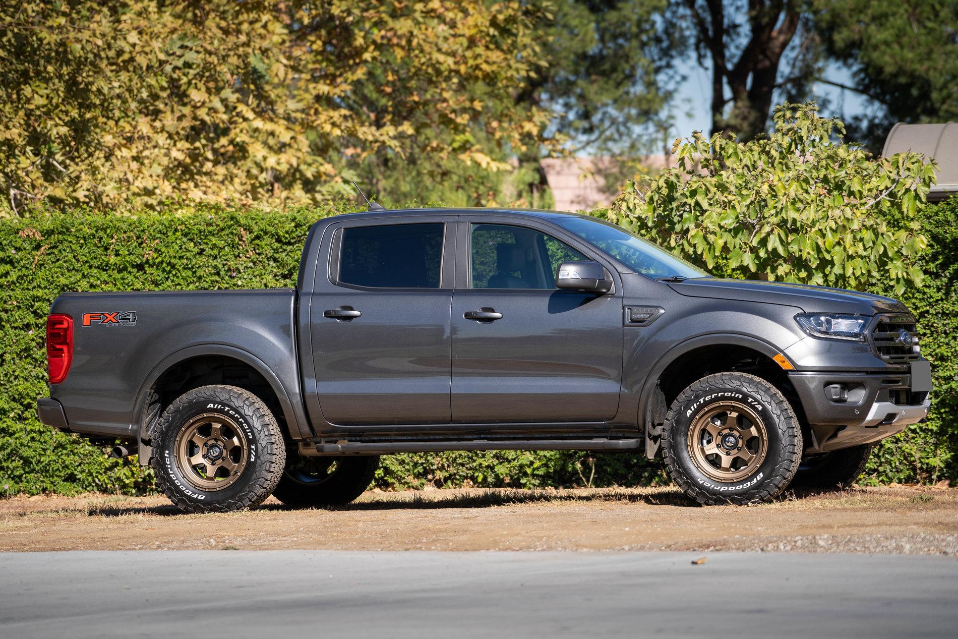

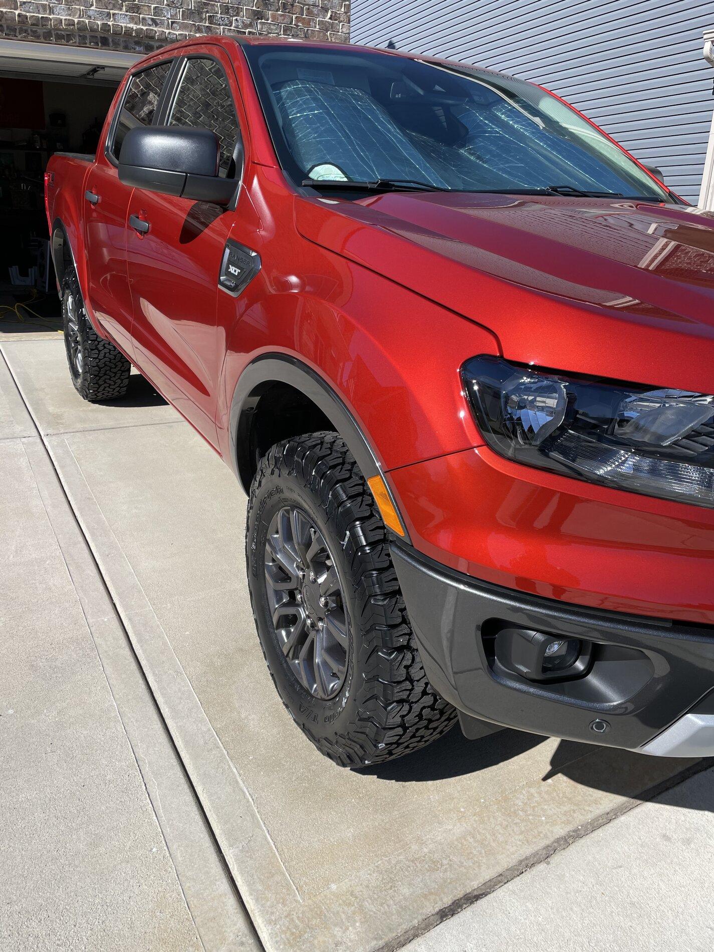

I can confirm a snug but no rub fit for 265/70/r17 BFG ATKO's
Stock wheels.
Stock ride height.
They do look a little like Pizza Cutters. Not as wide as I expected but it is close enough to the spindle that I would NOT GO WIDER.
I was going to see if I could adjust the Intrusion Protection Beams / Crash Bars but they were put on by the 800lb Ford Gorilla. I may still do it but w/o any rubbing, I'm not sure why I would.
Wife is a little sensitive about the "tall height" of my truck already and I was afraid she'd notice the 3/4" height difference. She hasn't yet.

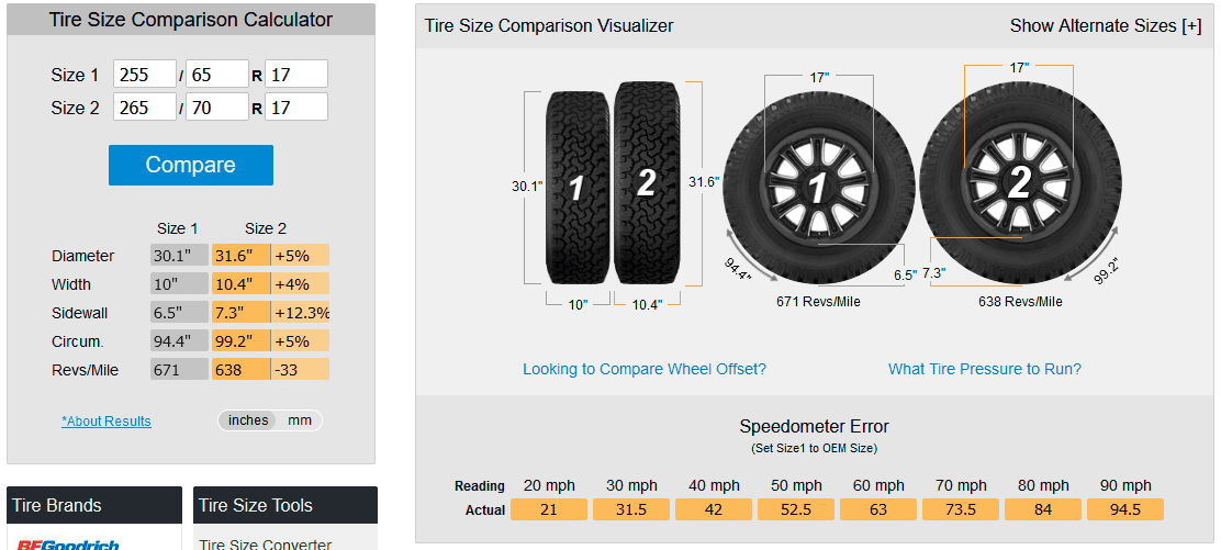

How much bigger can we go with no lift? Looking at 265/70/17 which are 31.6 vs the stock 265/65/17 which are 30.5. so that only equates to 1/2" difference in diameter approx.

Knowing how my 265/70/17s fit I would say you can, but given how close they are to the spindle, I'd recommend a 1/4" spacer. I'm probably going to add a 1/4" spacer to mine any way just to help me feel better.

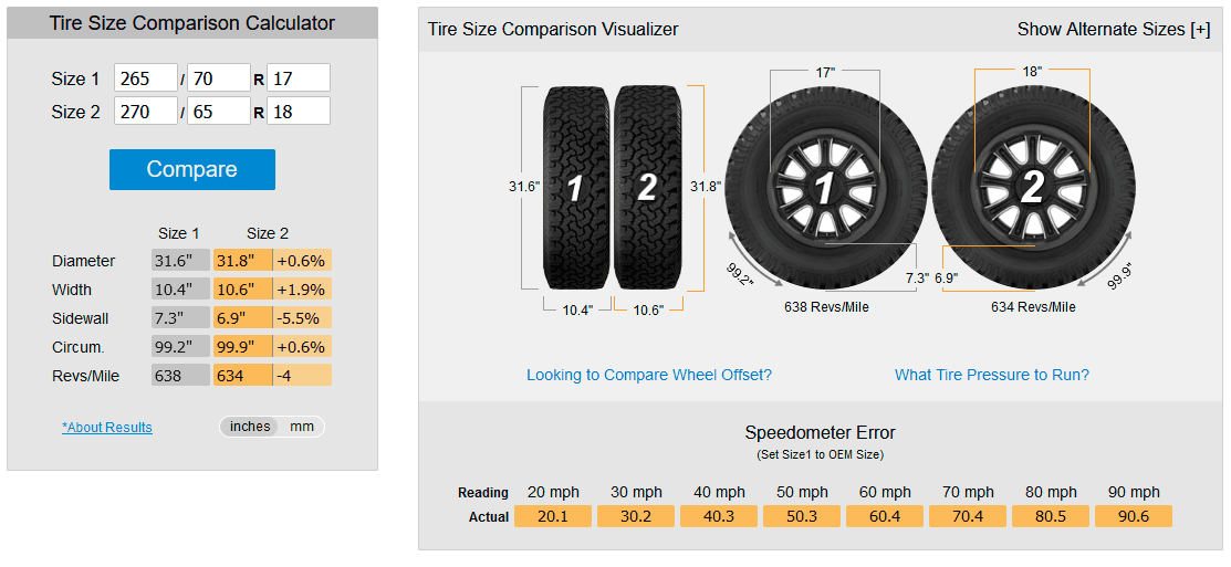

I ran the numbers and a 265/65/18 is the same width, same heigth, and only 0.1 inch smaller in circumference. If it were my truck, I'd run that size.

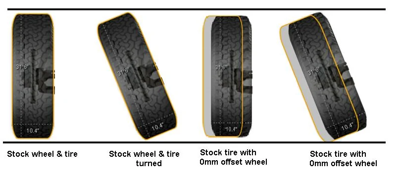

@GTGallop offers some very good insight. Sometimes, our desire to go as big as possible can cloud our judgement. His spacer recommendation is spot on but avoid the desire to go with a wider spacer just to get a bit of poke - you could end up pushing your tires into your crash bars when locked.
Adding spacers is the same as reducing offset. Here’s how too much poke messes things up. The lines represent the crash bars - the shaded tires (rhs) represent the new position.
