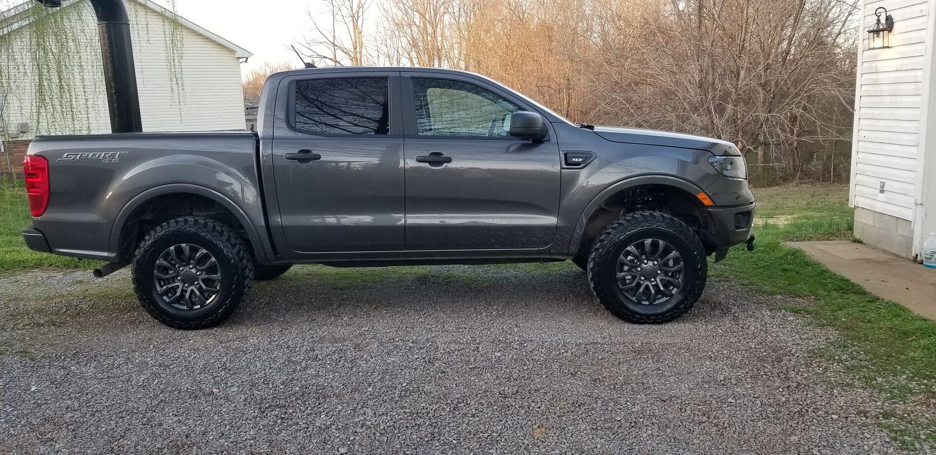

I have this same truck and looking for this exact stance. Yours look GREAT. I dont see in the thread what offset you chose. Did you select 20 or go with stock?
Thank you! Sorry that this is probably too late, but yes I went with a 20mm offset. The other options for the Fuel Shoks are 1 and -12 which would have pushed the wheel out too far for my taste.

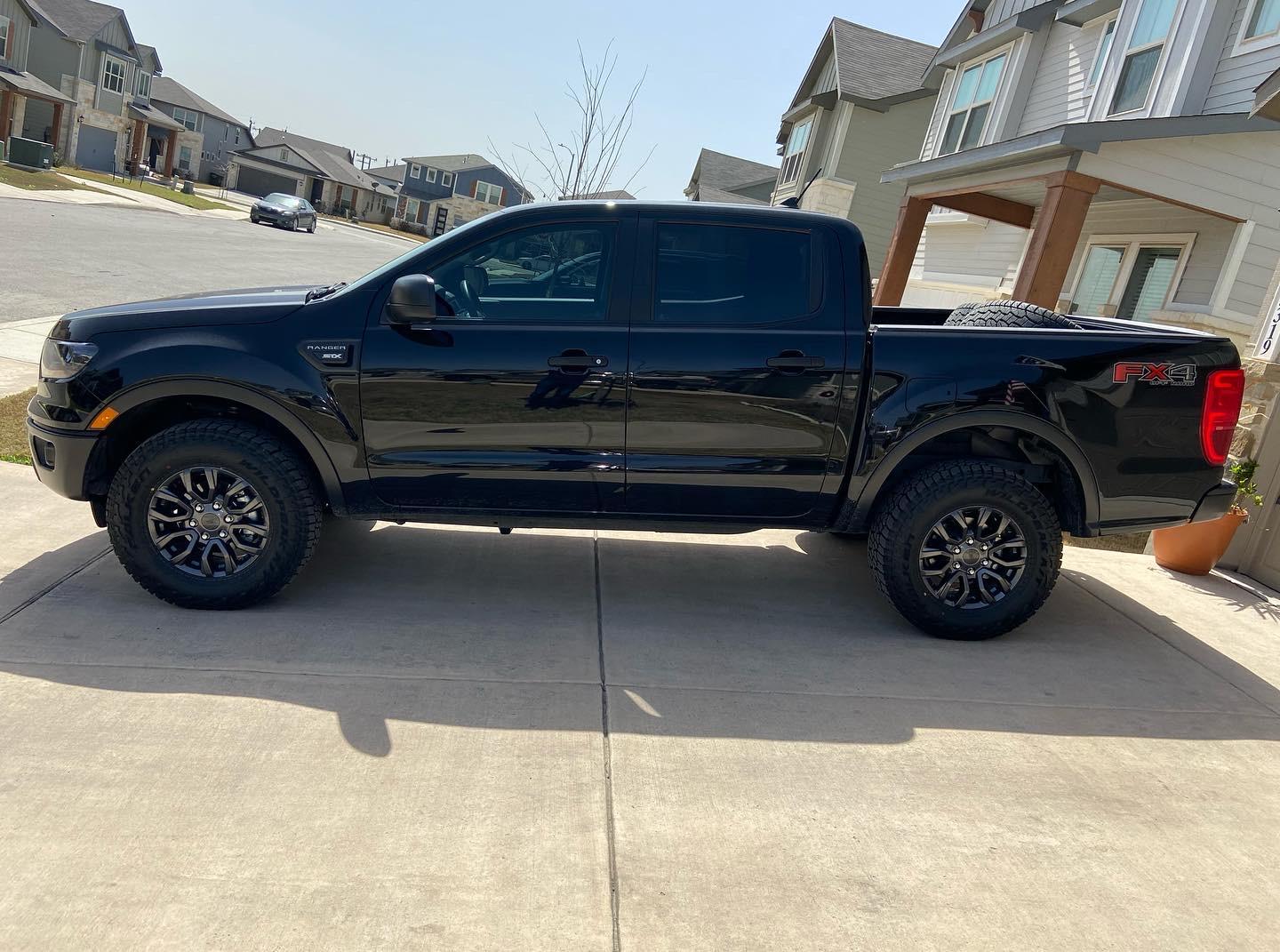

So I've spent hours reading through multiple threads...Can someone confirm that a 265/70/17 will fit on a bone stock XLT Sport (plan to do leveling kit in the future, but would love to get rid of the stock Bridgestones ASAP). From what I understand, there is no height difference between the Sport and FX4. Am I correct? Pic for reference.

My truck is not a Sport, but I recently put 265/70R17 BFG KO2 tires on my 2020 XLT with stock rims and no lift and they fit just fine.
