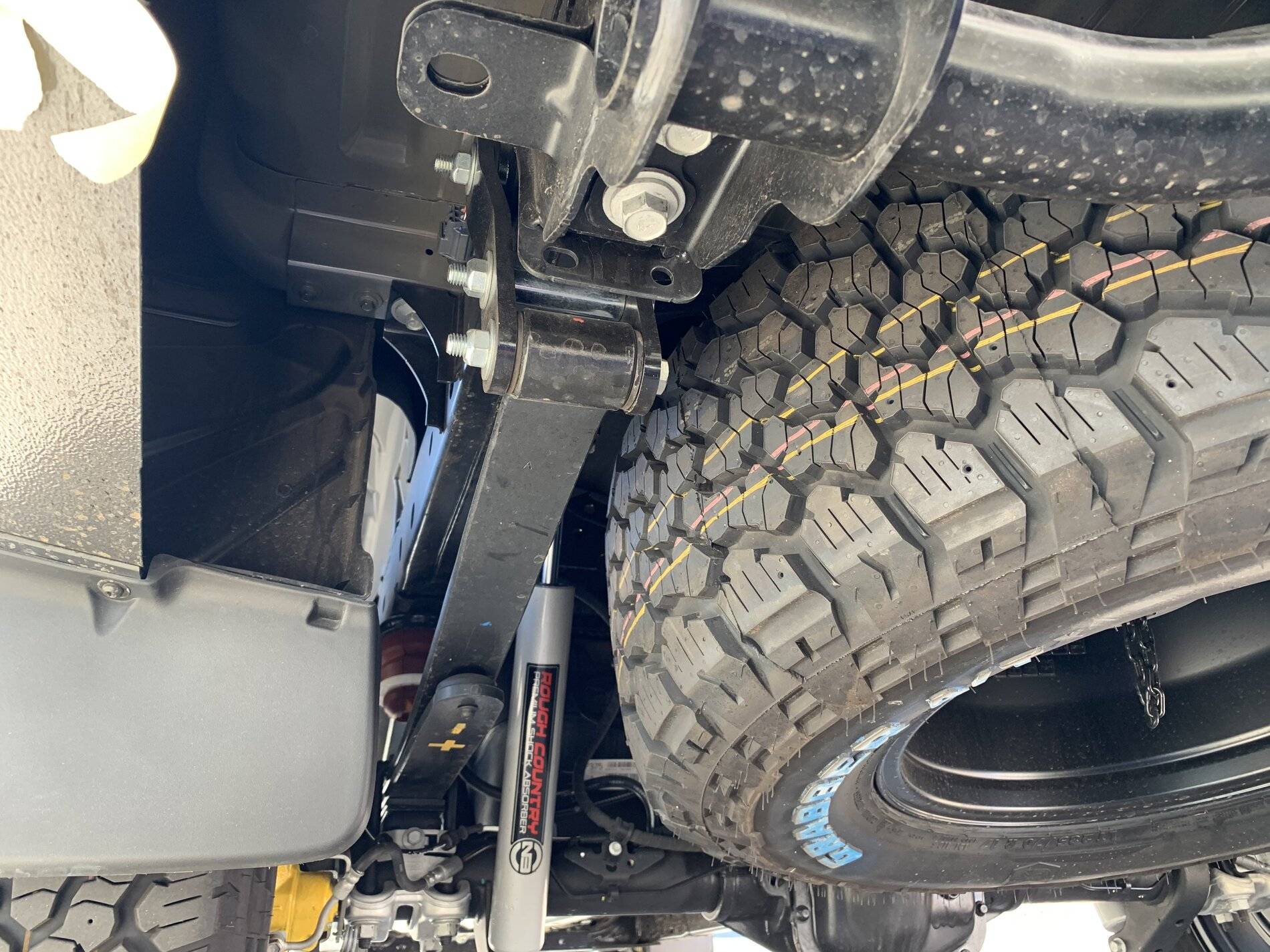

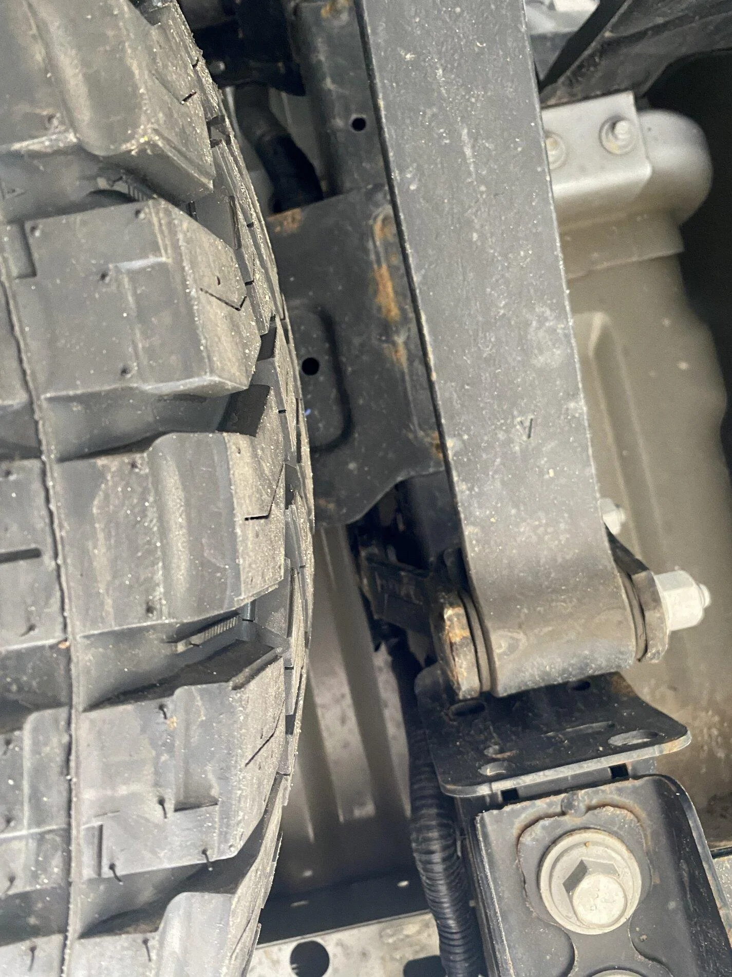

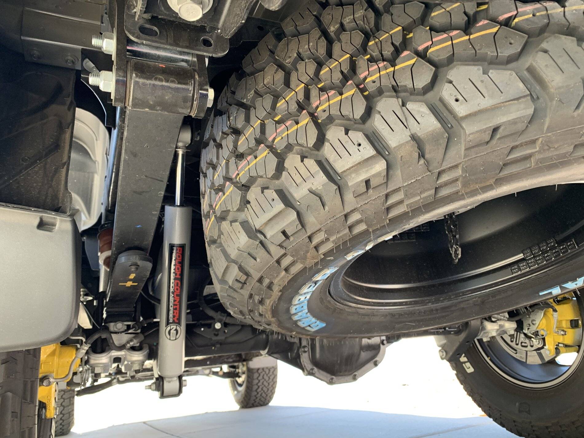

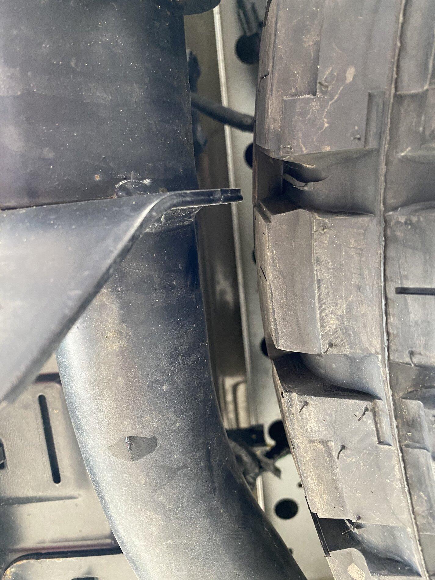

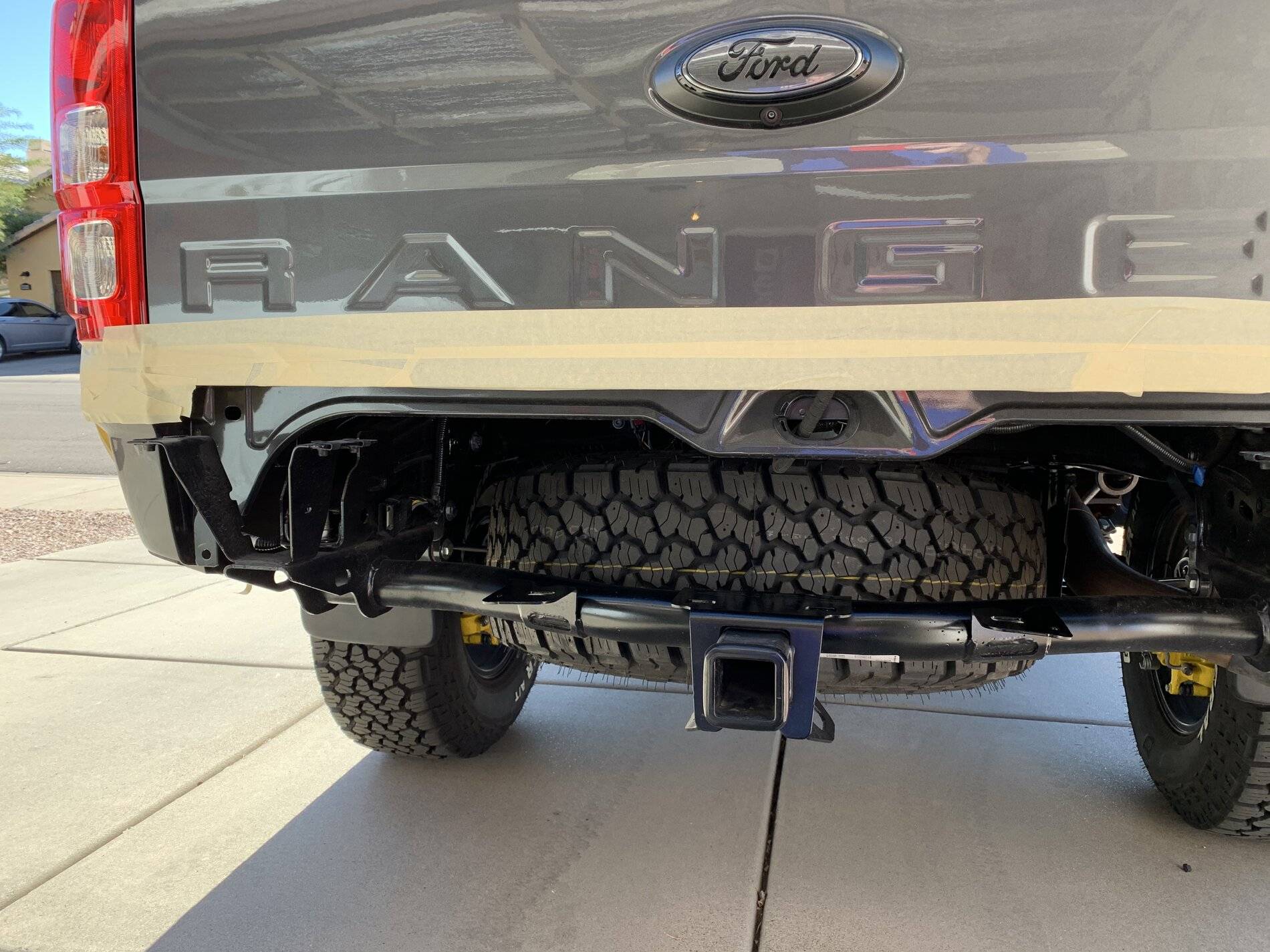

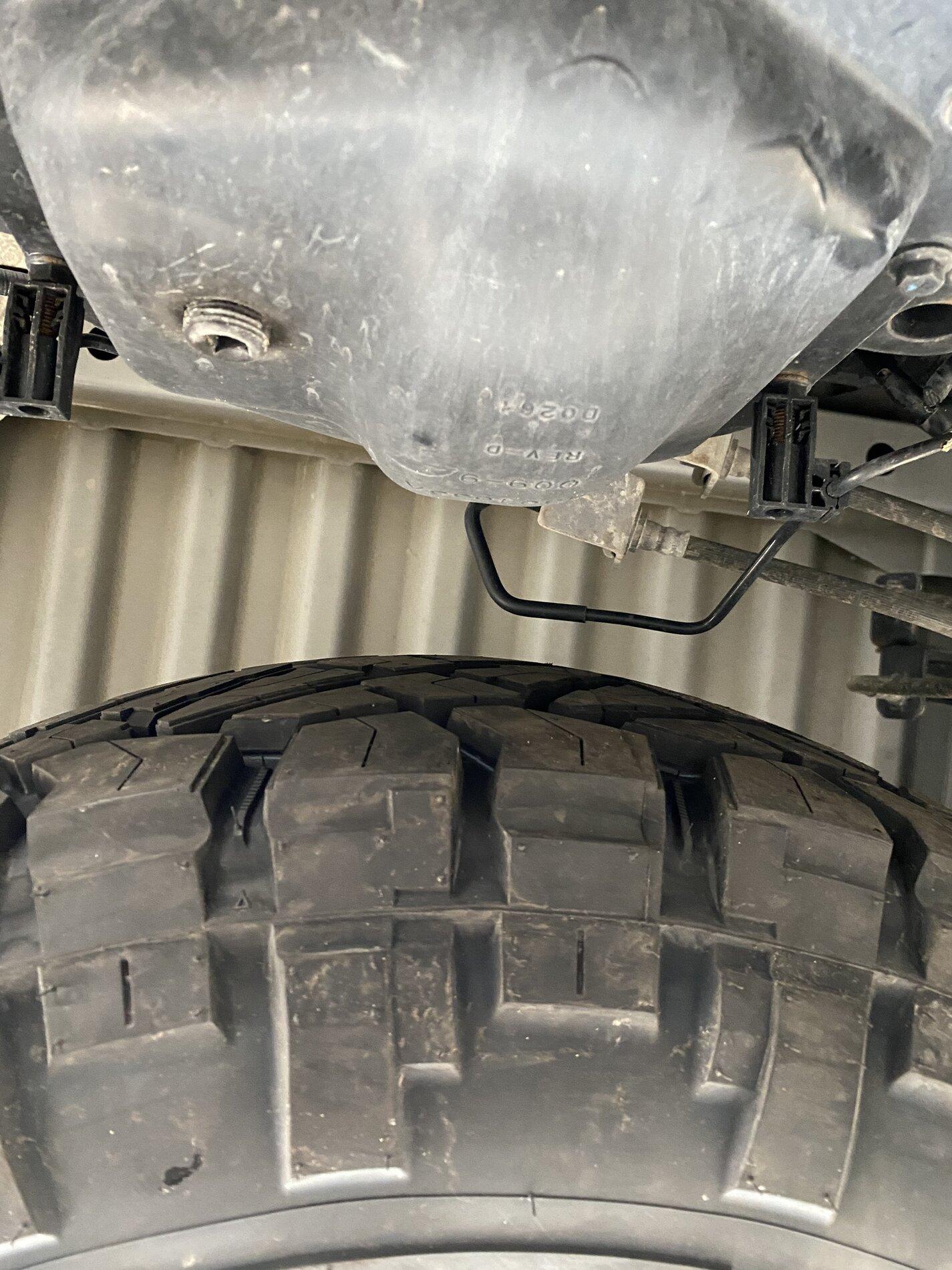

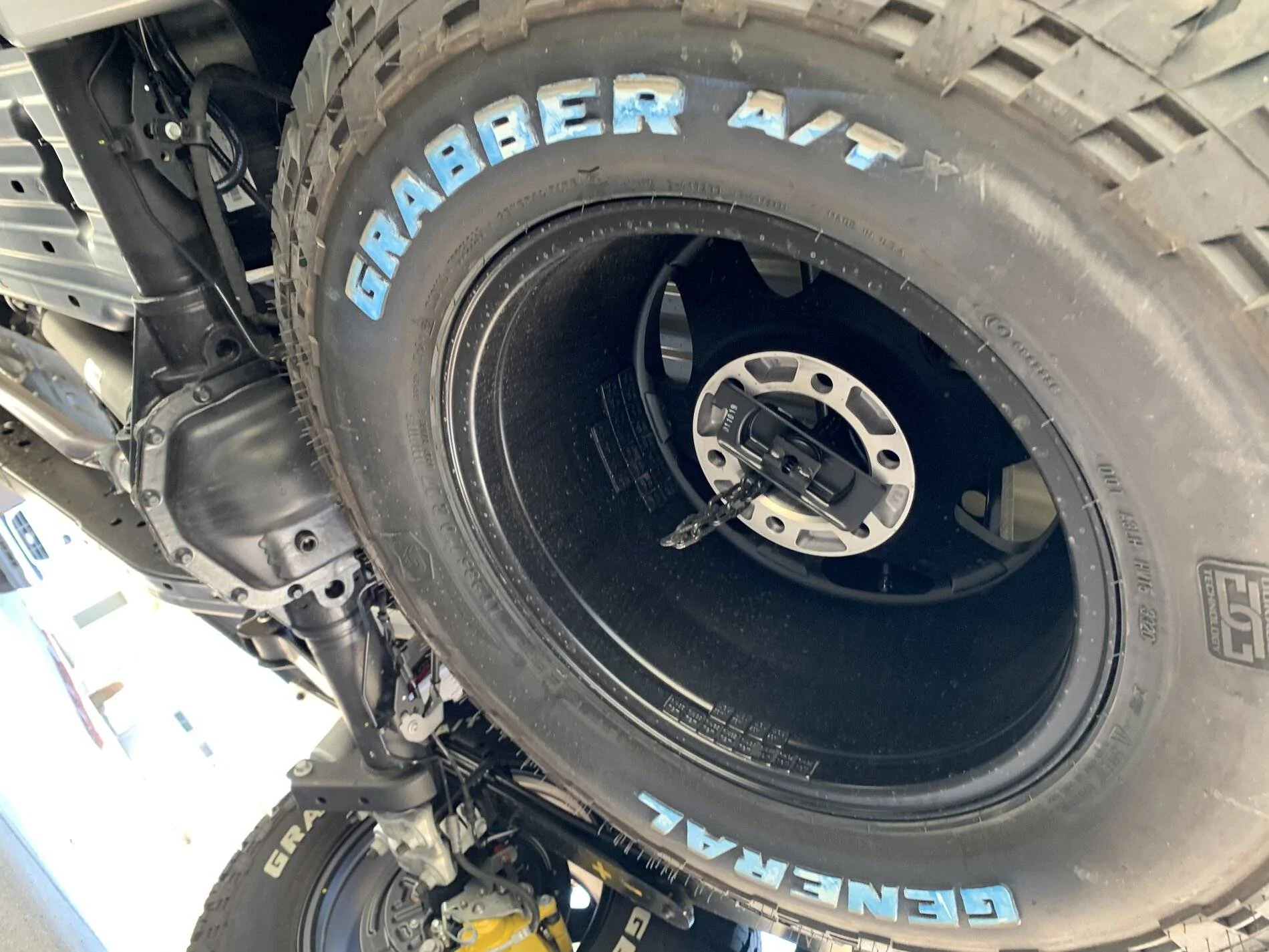

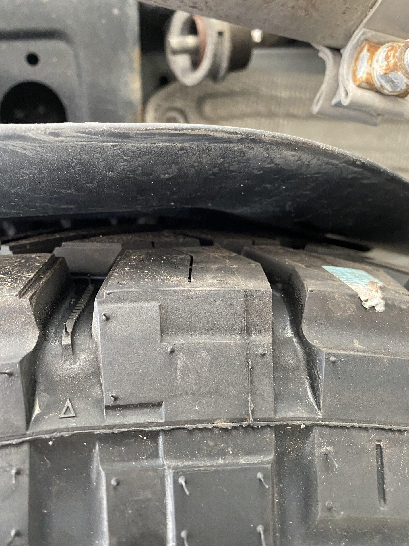

I have a 255/80R17 Nitto Ridge Grappler mounted on a OEM 17” rim under there. It appears to be the biggest you can fit. A34” might but it would be tight. See below.

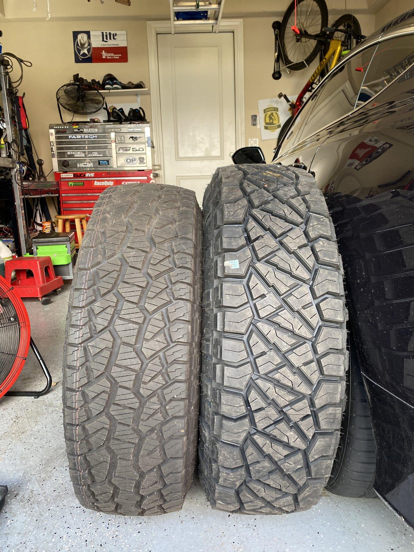

All mounted up and under the truck. 17" factory rim with Nitto Ridge Grappler 255/80R17 tire. Factory spare compared to new spare in first pic.
I think a 34" tire might fit under there considering the Nitto is a hair over 33". No way a 35" fits I don't think.
