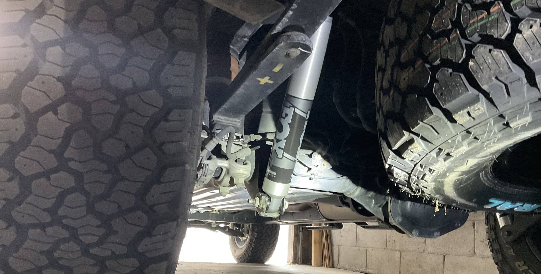

@y2krtaf how do you like your RC rear shocks.
Made a big difference on my FX4
They were great,especially for the price.Made a HUGE difference just putting them on the back.

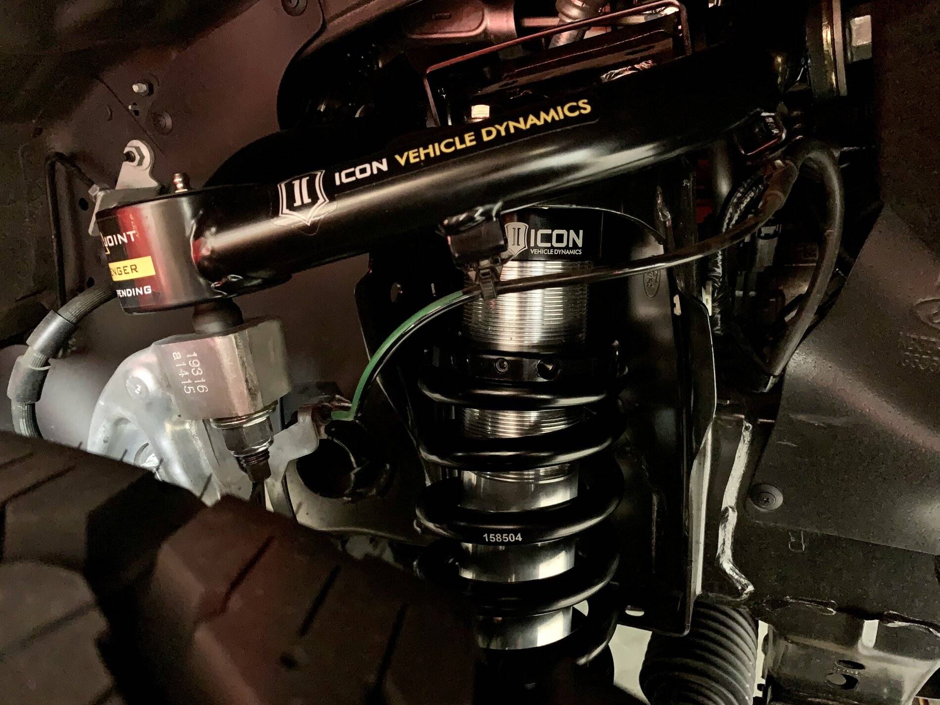

The truck now sits on an ICON stage 2 suspension.

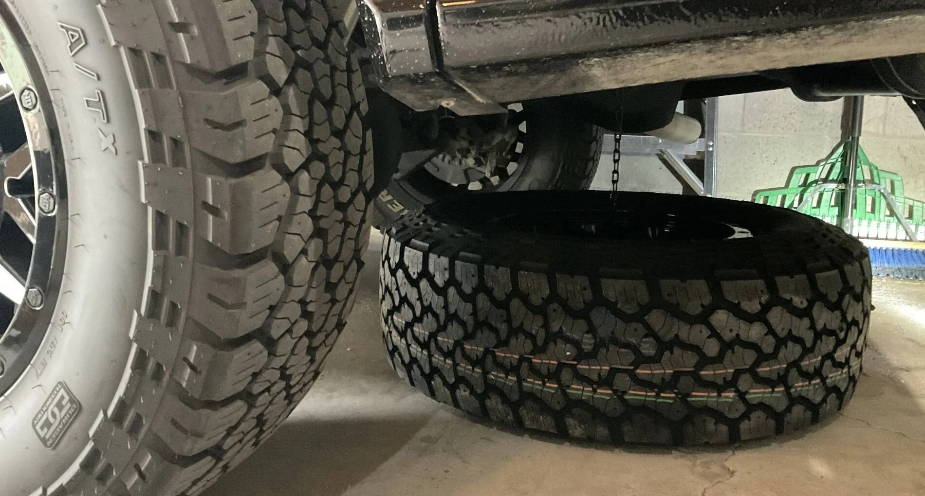

Another member on here reported a 285/70-17 in their under bed spare carrier, which is 32.7 inches.
Yup I bought a 5th wildpeak.at 285 70 17 and it fit right into the oem spare storage space. It's on the factory 17" steel wheel.

33 is the biggest that will fit.

Tremor comes standard with a 32" spare tire. It fits. When i installed my aftermarket hitch, i lowered the spare and put it back up after the install. It is tight indeed, but definitely fits.

I’m running a matching spare (275/70R17 32.2” General Grabber) and it fits just fine.
