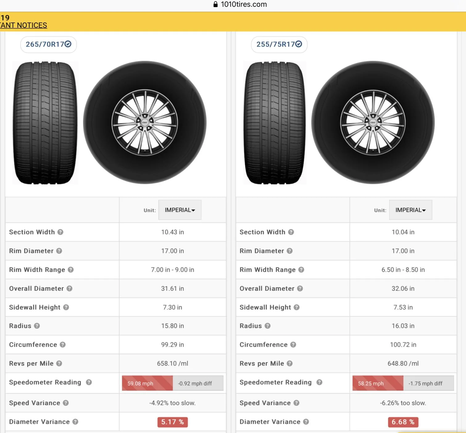

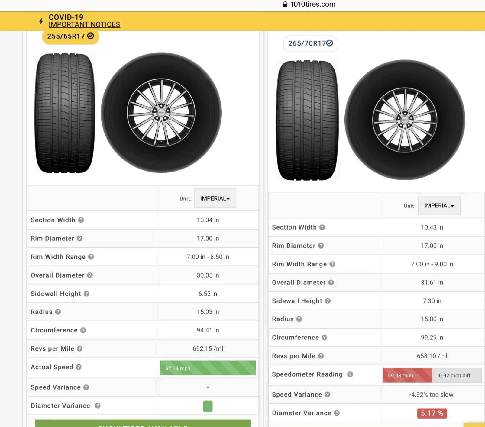

255/75 r17 fits stock wheels and suspension with crash bars in place. It’s about .5 inch larger diameter than 265/70 r 17 tires.
I found this interesting calculator that compared stock tires versus 265/70r17 and 255/75r17. it not only gives the size difference, but the speedometer speed changes.

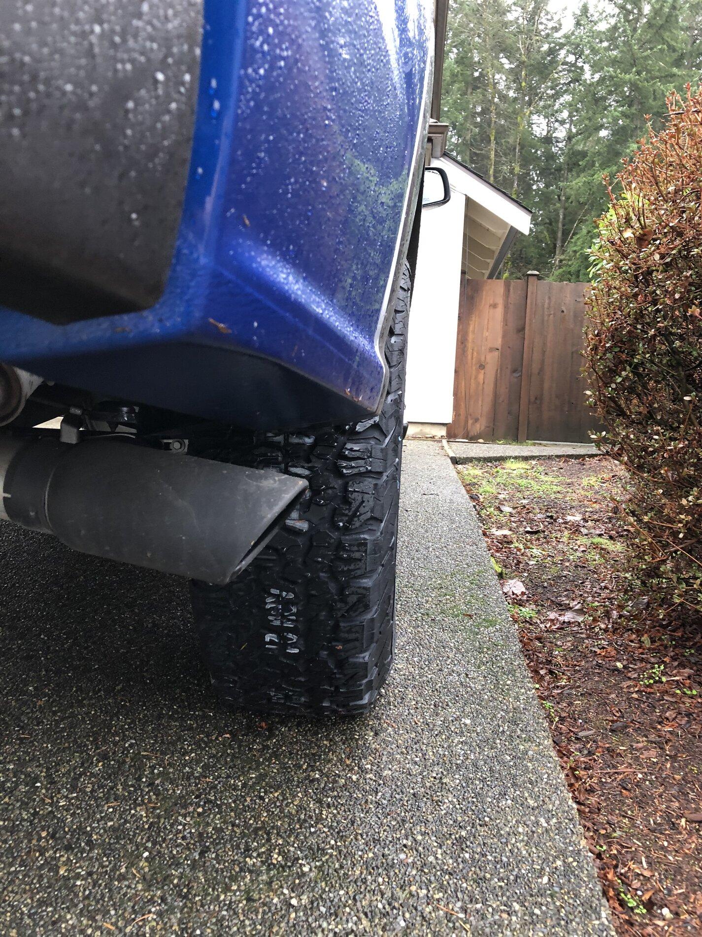

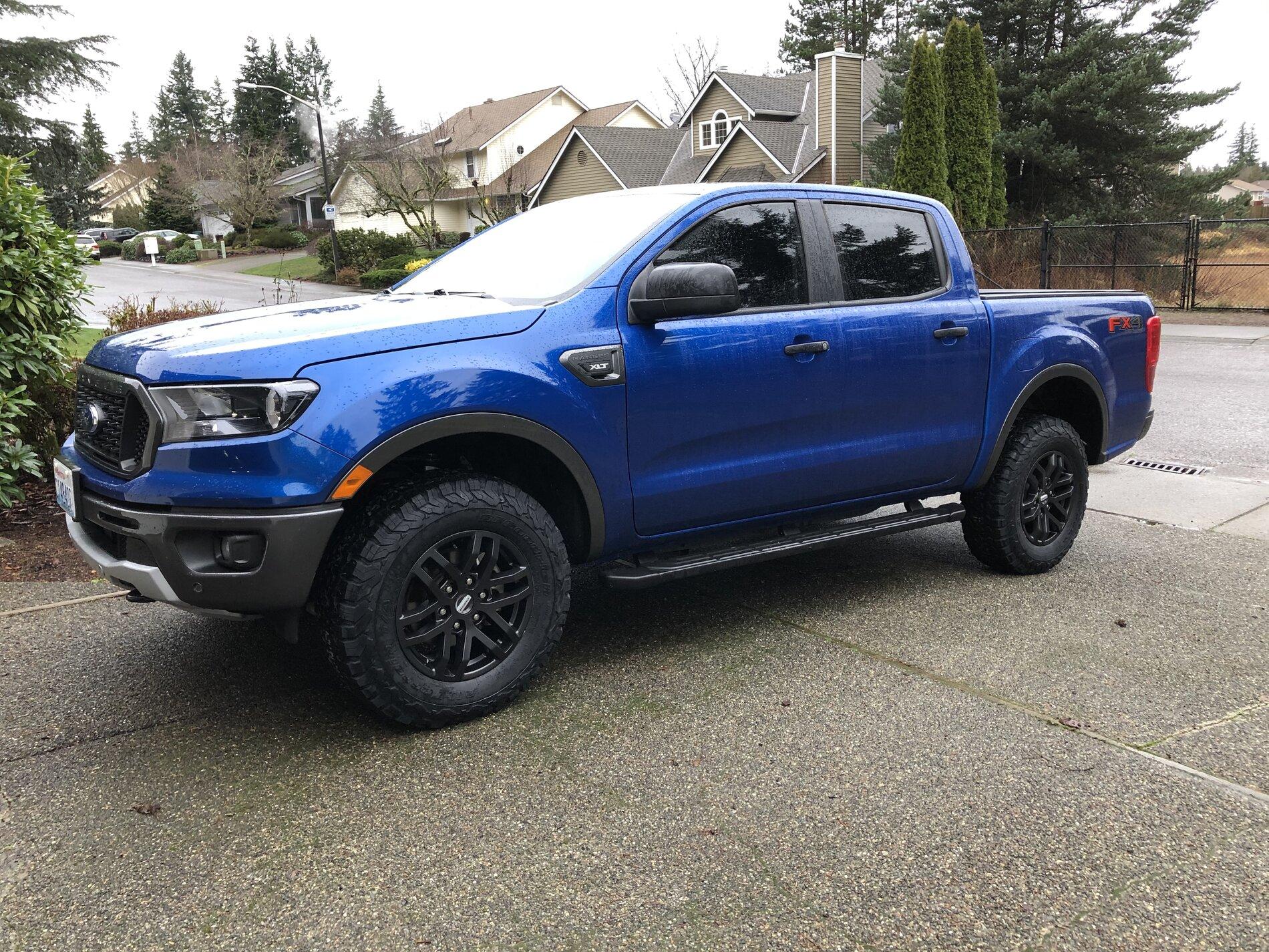

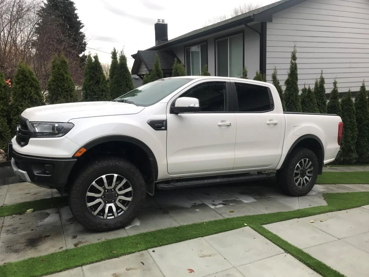

I was not expecting to like these this much - but they really add to the truck.
Ranger Raptor Dyno Gray Wheels M-1007K-RGR1785OR with 265/70r17 KO2. Main reason I am adding to this thread is because I could not find how the wheels would look without any spacers.

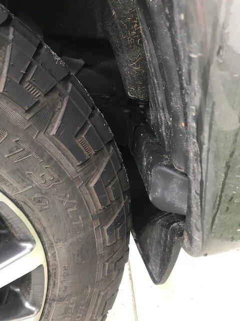

Not the black wheels, but I figure the offset must be the same. These are Cooper Discoverer AT3 XLT's. I have had no rubbing issues whatsoever, but I also don't do a lot of heavy off-roading. I've gone out a couple times where I've definitely needed 4wd and compressed the suspension, but I can't say for sure if I've ever fully compressed the front suspension at full wheel lock. Sorry, wasn't good enough light to get a decent picture showing tires on the truck.
