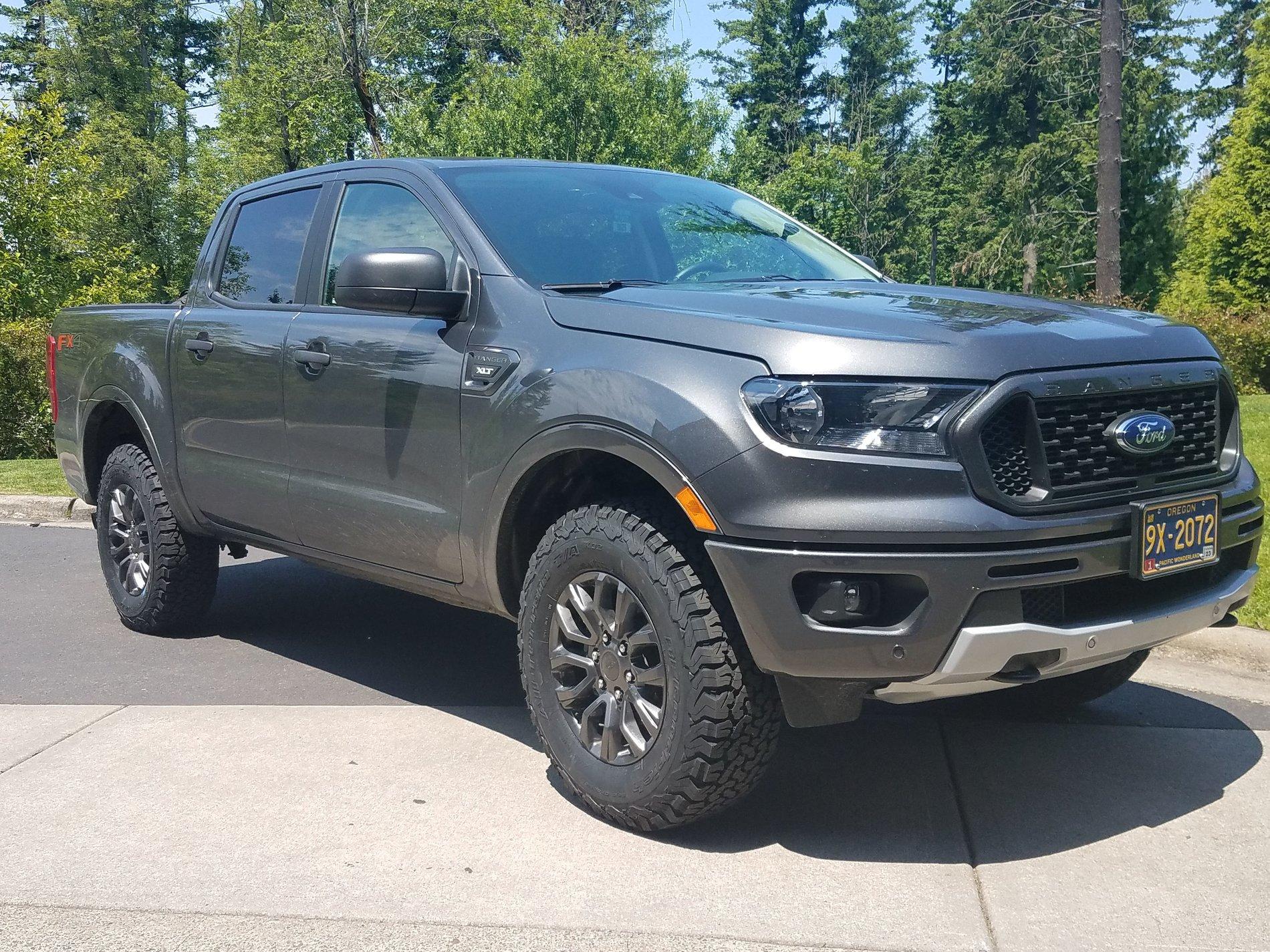

I also went with the 265/70R17 but I chose the BFGs.
I really like the look of your tires. I also like that they go on the OEM wheels and no lift or level required. It won’t happen for a few years, but I am pretty sure these will be my replacement tires.

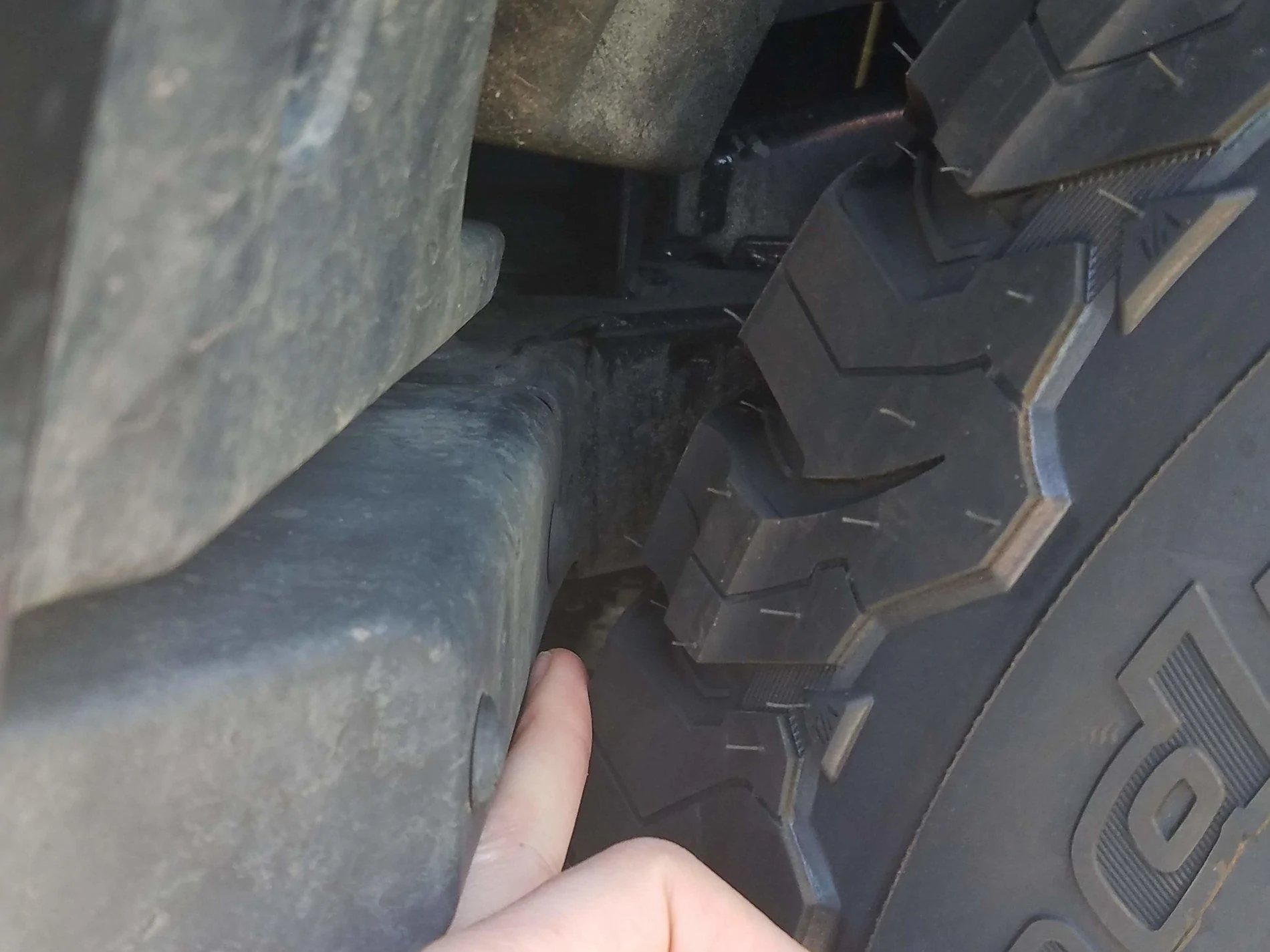

Truck looks fantastic! Just want to confirm you are running 275/70/17 and you have no rubbing, didn’t need spacers or remove the crash bars?
2019 2WD XLT Sport
LT275/70R17 Falken Wildpeak AT3W (6 Ply)
Rough Country 2.5 Leveling Kit
N-Fab Epyx Series Step Bara
And an alignment in a pear tree...
Rides/drives better than OE, looks great (in my humble and very biased opinion) and really ended up exactly how I wanted it. Absolutely no rubbing and required no spacers.

i have 2019 sport with fox 2.0, 2.5 lift, running 275.70/17, no rubbing issues, crash bars still in place!

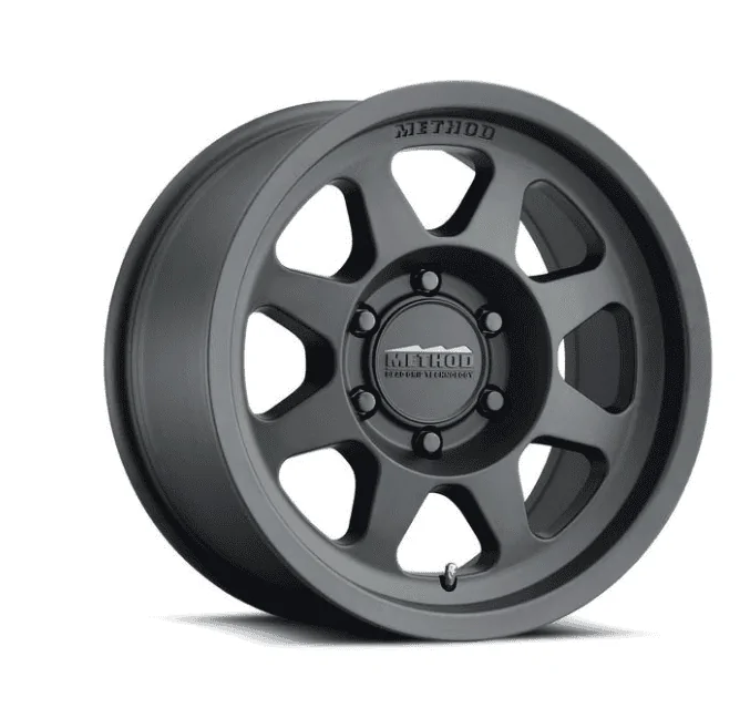

So I want to purchase 17 in wheels. Truck came with 18 in and I prefer the smaller wheel more tire look. Can someone tell me what the - offset would do for me.
Oops see below for wheel sizes
