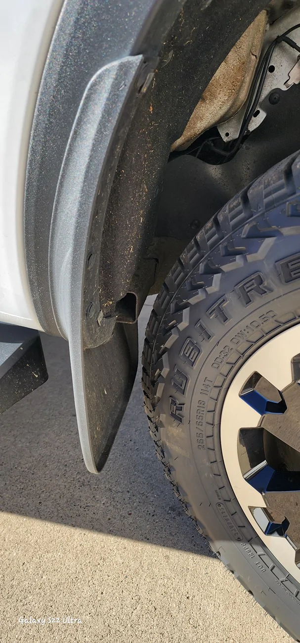

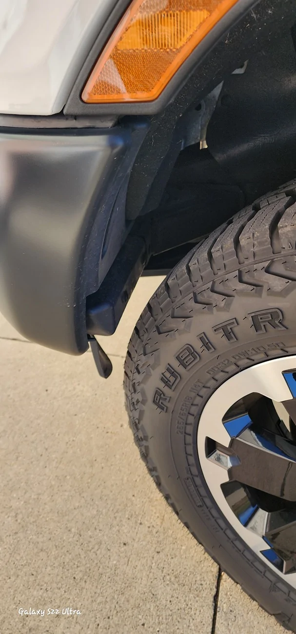

In reverse full crank they would rub slightly on driver and passenger front crash bar I took the plastic cover off. And then tried to loosen the bolts cuz they say there's a little wiggle room in there why couldn't get the damn bolts loose with a big old Milwaukee so I said screw it I took a small sledgehammer tapped them and boy did they move easy and it was just enough that they didn't hit it at all after putting the plastic covers back on
