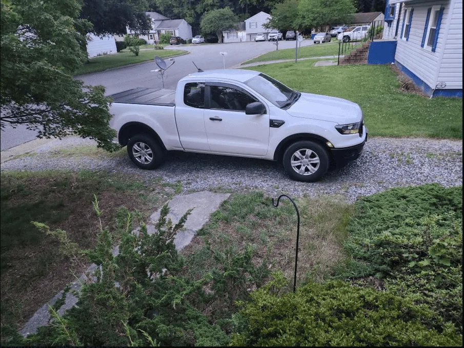

Got half of the Beltech kit installed today, that I bought from a member here, like 8 or 9 months ago. Figured, since i was in there to replace the lower ball joints anyways, id get the lowering kit done.
Didnt have enough time to get eh rear done and, really didnt want to fiuss with cutting the exhaust just yet. If I could find a cheap enough axle dump, I think Id just do that.
Anyways, here's Wonderwalllmao

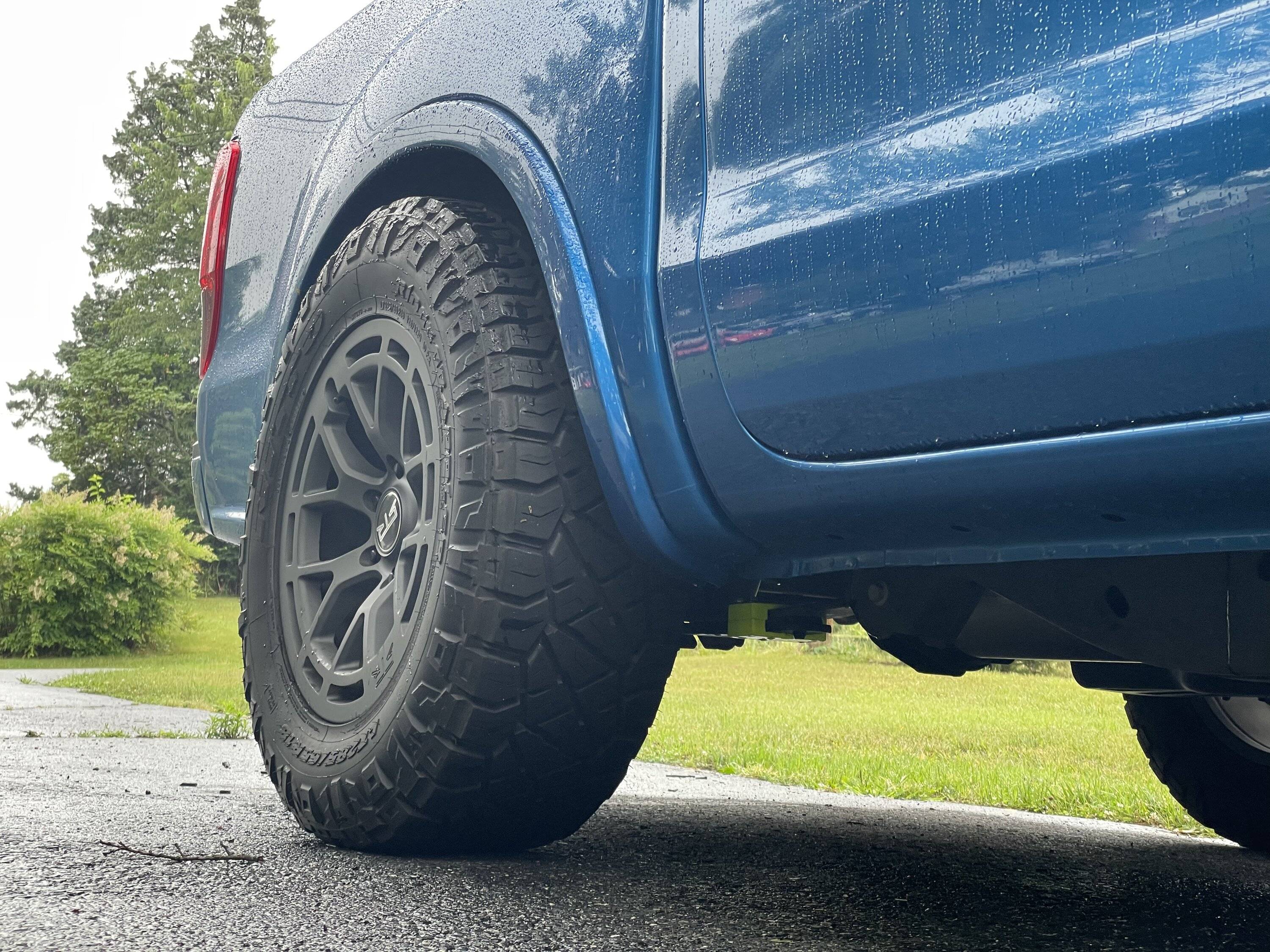

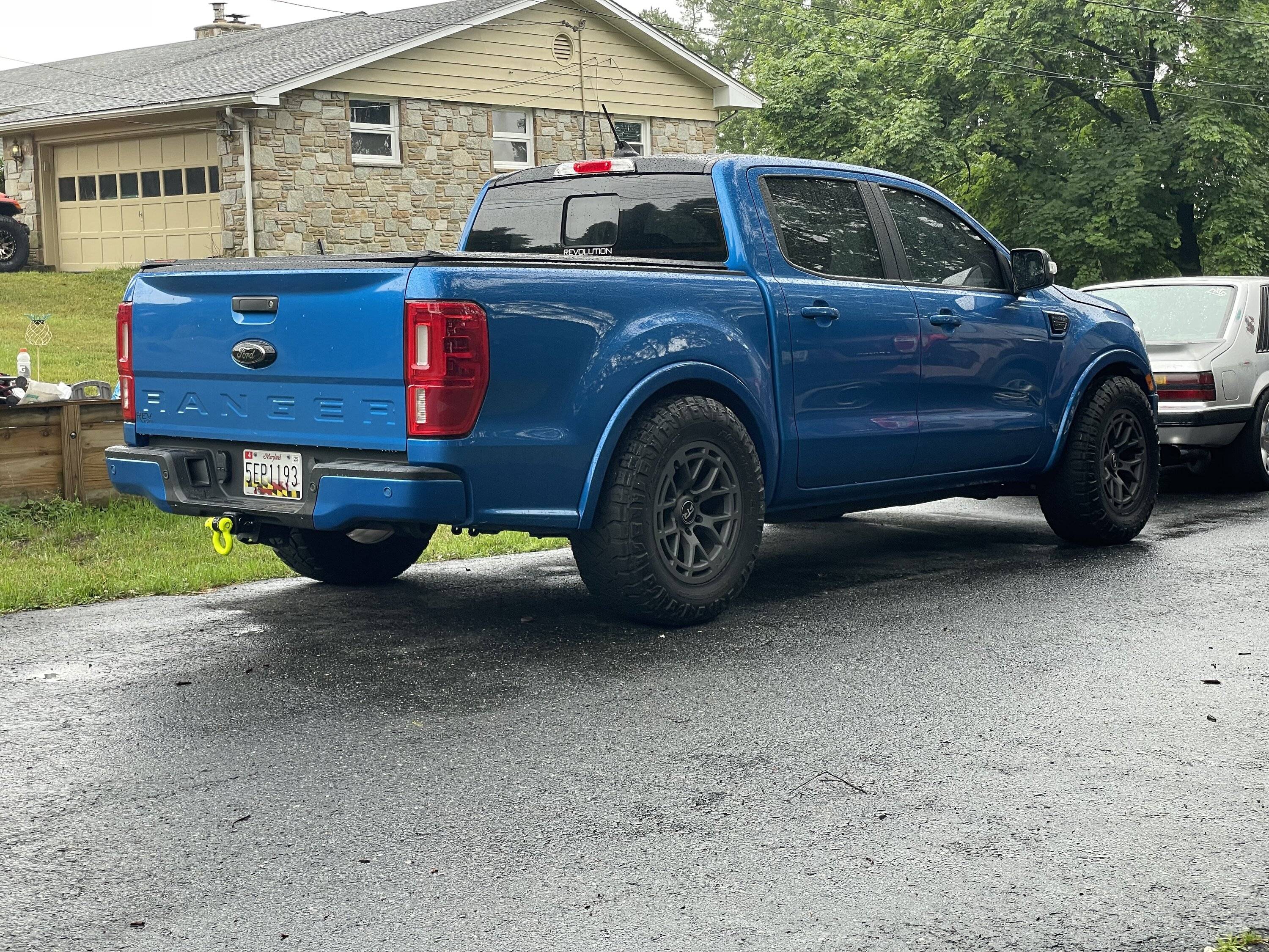

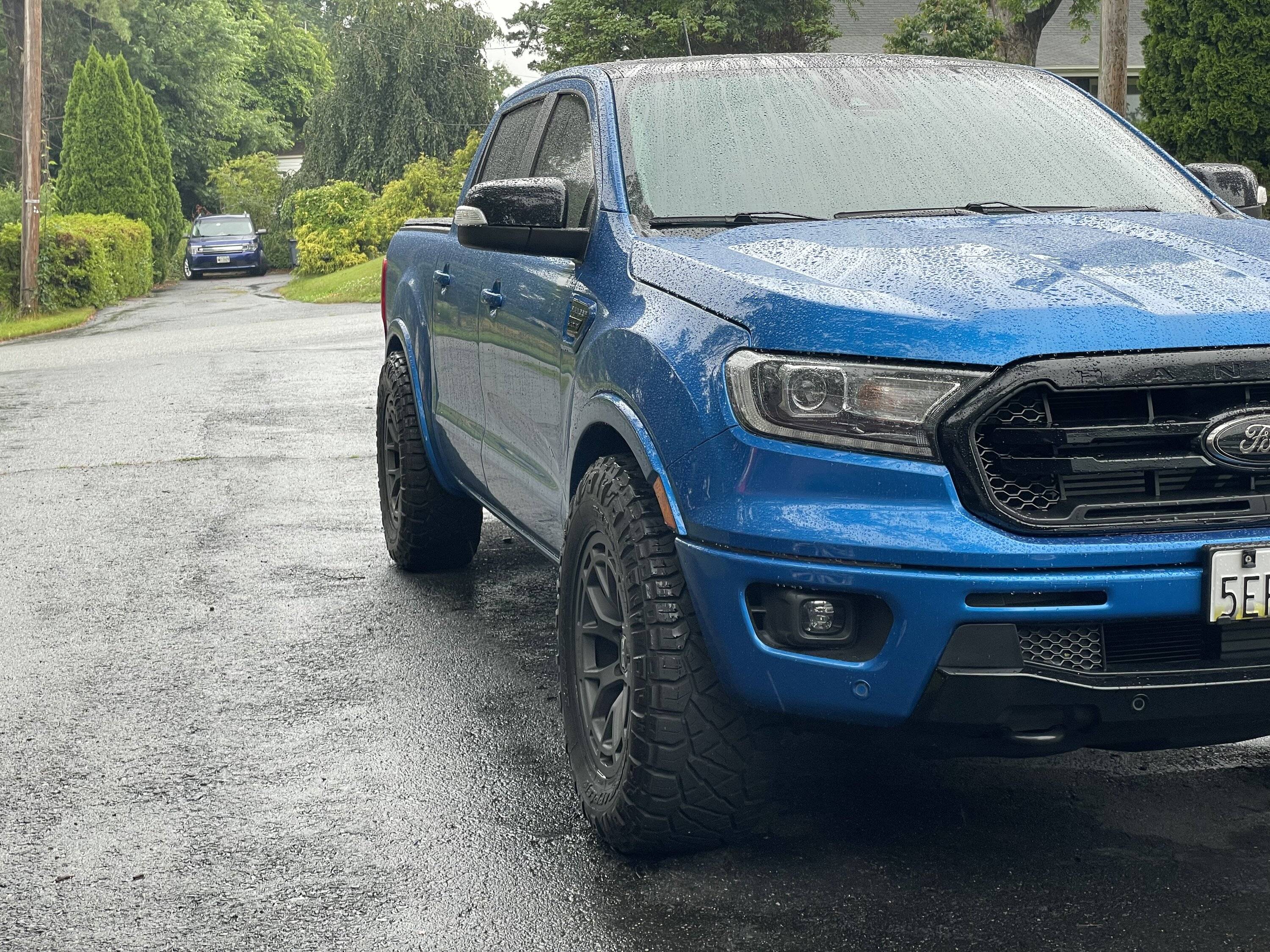

I have the kit to install just have not got it on yet. But do you have any tire rubbing issues with your wheels outside the fender lip and being that close to the fender lip. How much did you lower and what are your wheel /tire sizes?
They rub worse without the spacers actually. Lots of cutting and clearancing to fit 285/65/18 for sure.
I drive daily in all road conditions with no issues since it’s been sorted out.
