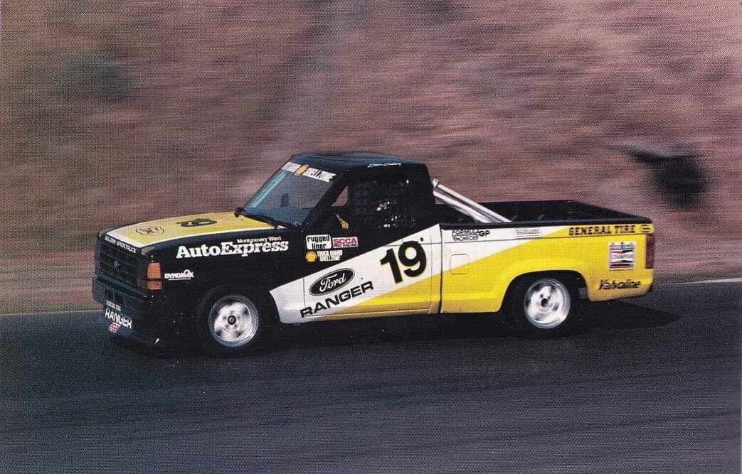

I too would like to lower the ass end of the Ranger, but having developed the SCCA Race Trucks, the flip kit is something I need to review. On the SCCA Race Trucks, we deleted the multileaf pack and went to a custom Monoleaf from the Ford OEM suppliers prototype shop...(nice to have access to this, eh?) Not sure about Belltech or Freak Ride...So sitting on the sidelines
Steve Saleen at speed in one of the trucks I built ... This is the look I want... nothing out there to accomplish this yet...and maybe never will. Slamming a truck that does not handle is not my cup of tea...
Phil Schilke
Ranger Vehicle Engineering
Ford Motor Co. Retired
Nascar trucks are slammed pretty low and handle really well!!
