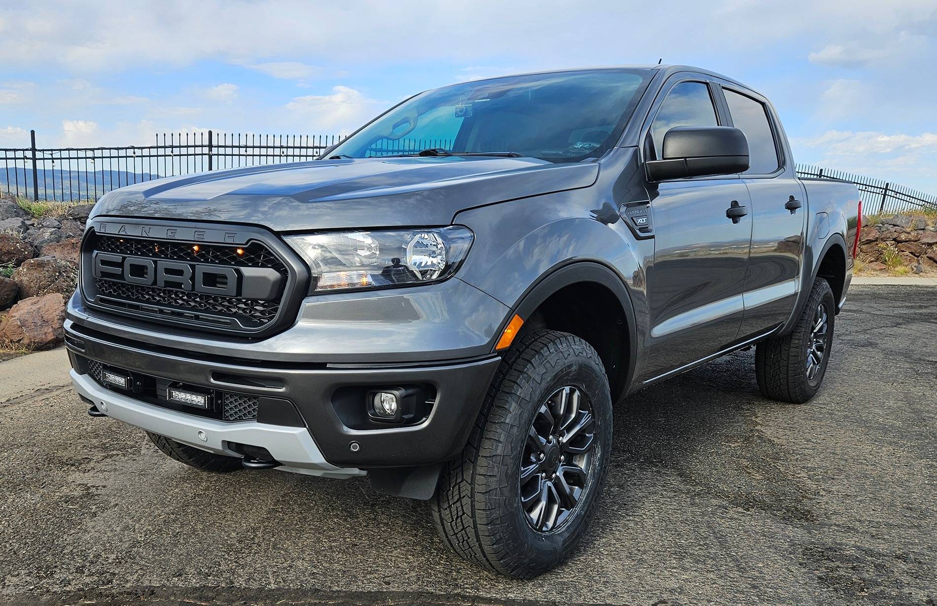

Lifting the front up will do what you want. I went with Eibach Pro Truck on my FX4 and they are better than I expected.4 settings, 0, +.75, +1.5, +2.25 and +3. I went with the +75 and really like it. Smoothed out the back a lot. Improved handling on the twisty mountain road that I run twice a week and handling over fire roads and pot holes is vastly improved. Photo with 265/70R17
