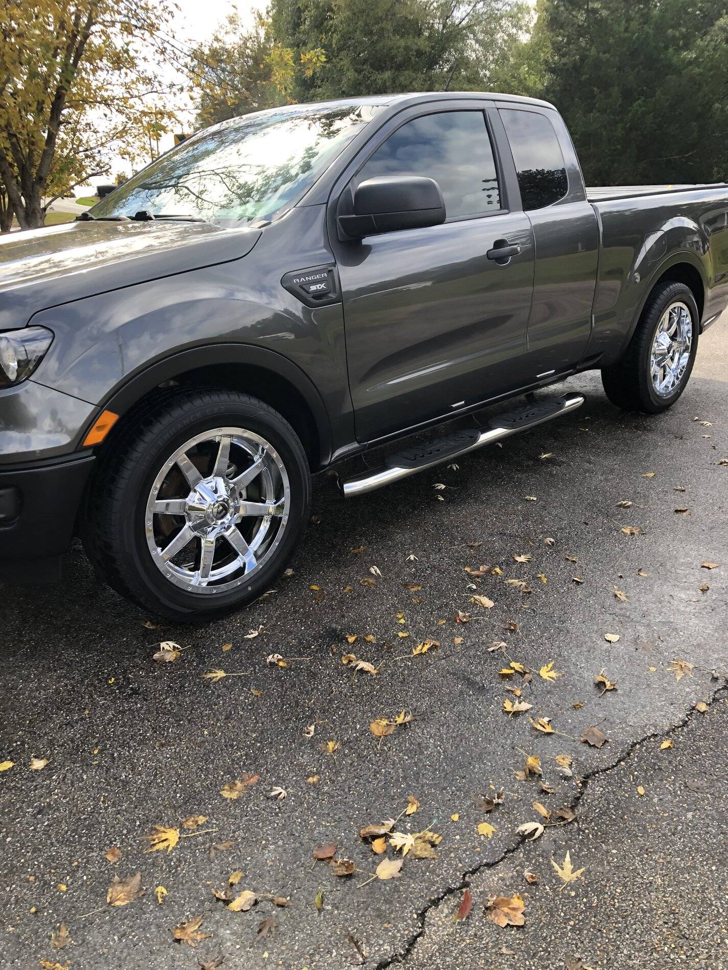

I bought a 2019 Ford Ranger strictly for on road use. Installed a Roush stage 3 Performance kit, 2x4 Belltech lowering kit, Custom Wheels and Tires. Having trouble with front end alignment. Caster adjustment to max. Is anyone else having this issue.
Great looking truck! I really like the chrome wheels and the chrome nerf bars. How did you tint your tail lights?
cadjames
Calvin
Nov 2, 2021
Mechanic
Spray.
