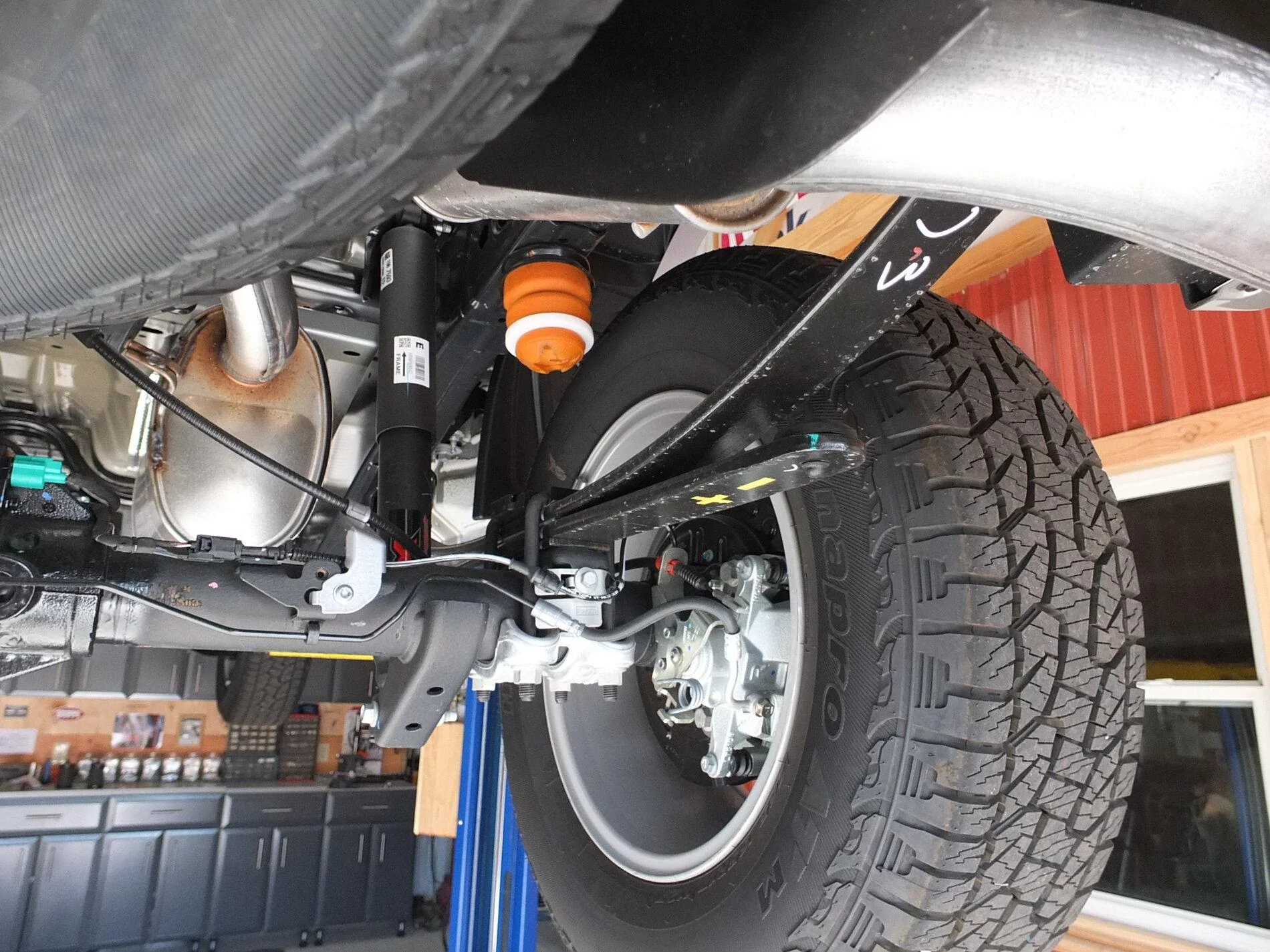

Sorry, missed the question: Yes, absolutely an easy driveway job. Hard part was finding the 3 1/8 spring perches (Eastern Gear), the shorter shocks (Early 2000's Nissan Fronteer). U-bolts and spring plates were easy. Careful cutting of new front shock spring seat retainers was the one tricky bit.
For some, finding a spring shop to add 3" of arch is likely the hardest bit.
