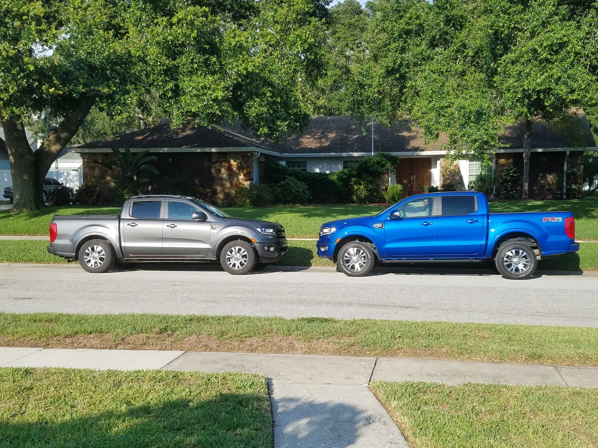

I had my springs re-arched to add some lift, then flipped the axle over the spring to drop the back end.
End result is my tailgate is about 10" lower than my wife's FX4. For me, a very worthwhile effort.

Deleted member 9836
No easy way yet, but a kit "soon" is promised.
Do you have pics posted somewhere? Sounds nice.
