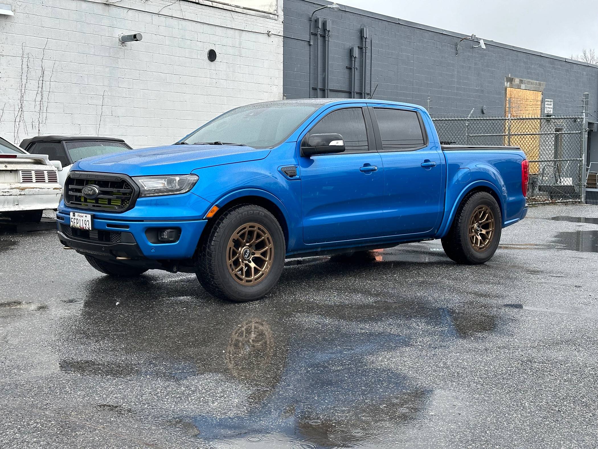

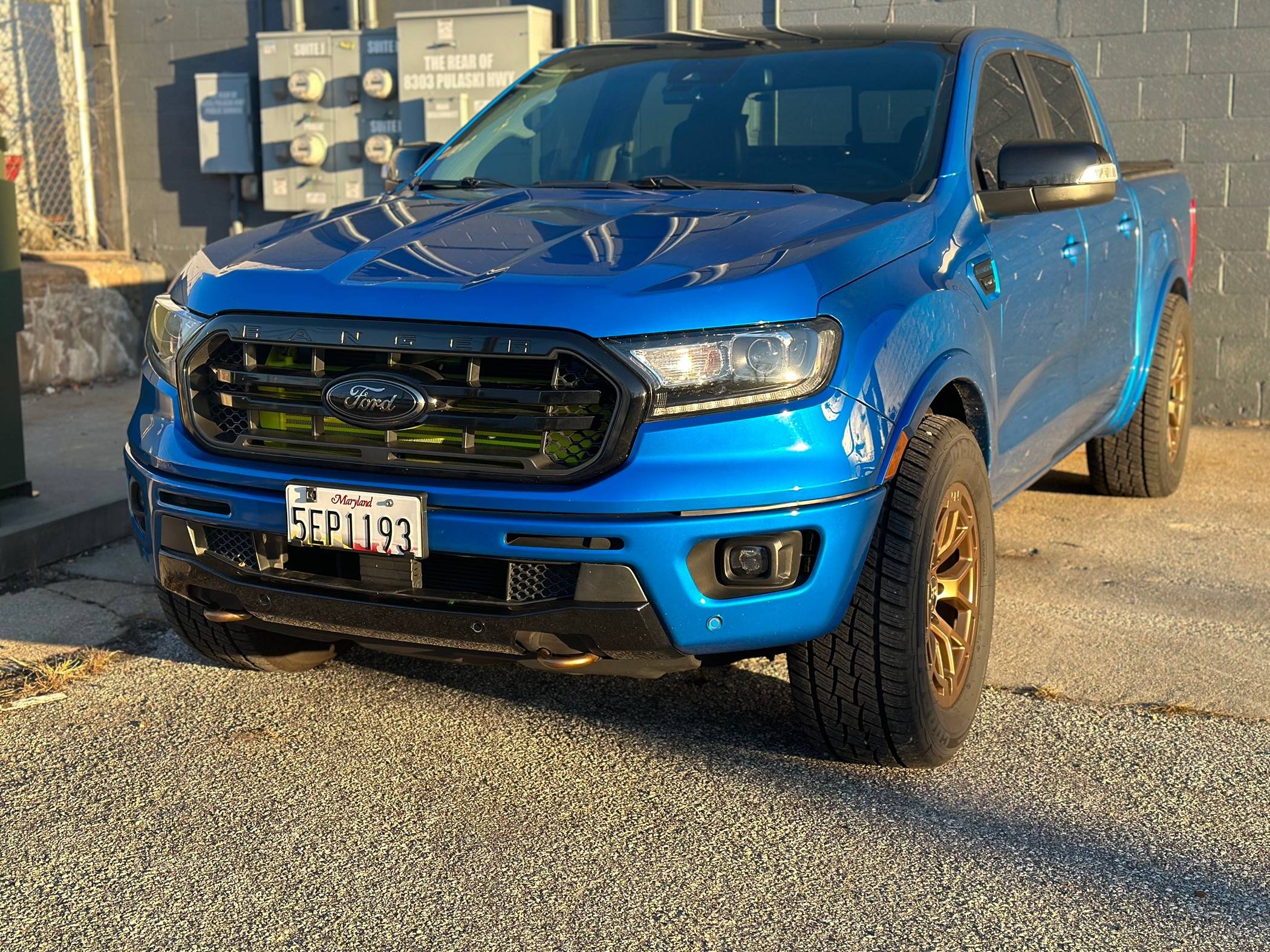

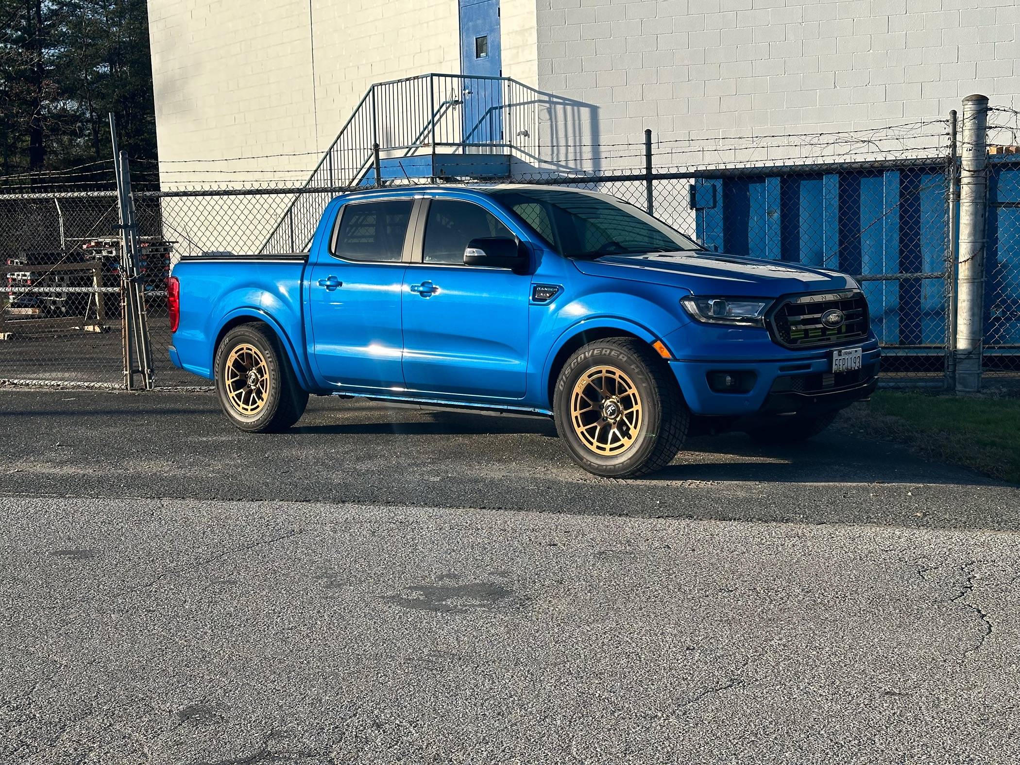

Question for all the Ranger folks who did the 2" inch Belltech drop of the front without their contriol arm replacements. Since I dont have aluminum knuckles and Belltech does not support iron knuckles, How far out is your front alignment ( or how close to spec) can you get your front alignment?
My truck is lowered 2.5 ish
I have about -2 degrees of camber. I could have probably gotten it closer to -1.75 or so but I would have lost what little caster angle I had. If you are only looking for a 2” drop I would expect that you could get near -1.5 to -1.75 degrees while still having enough caster. My tires get rotated every 6-9k and last a reasonable amount of time with my current alignment but I would like to trade some camber for caster with a set of correctly made upper control arms.
Mine is lowered 2.5” ish. I managed to get around -2 degrees of camber and like 3 degrees of caster with stock arms. The ball joint angle is terrible though.
I could have gotten a little less camber but I didn’t want to sacrifice what little caster I had.
If you’re planning on only 2” drop I would think you could get around -1.5 to -2 degrees camber.
I rotate my tires every 6-9k and they wear decent. It handles great even in the rain. I still plan on installing proper control arms, I’d like to be closer to -1 to -1.5 degrees camber and as much caster as I can get equally.

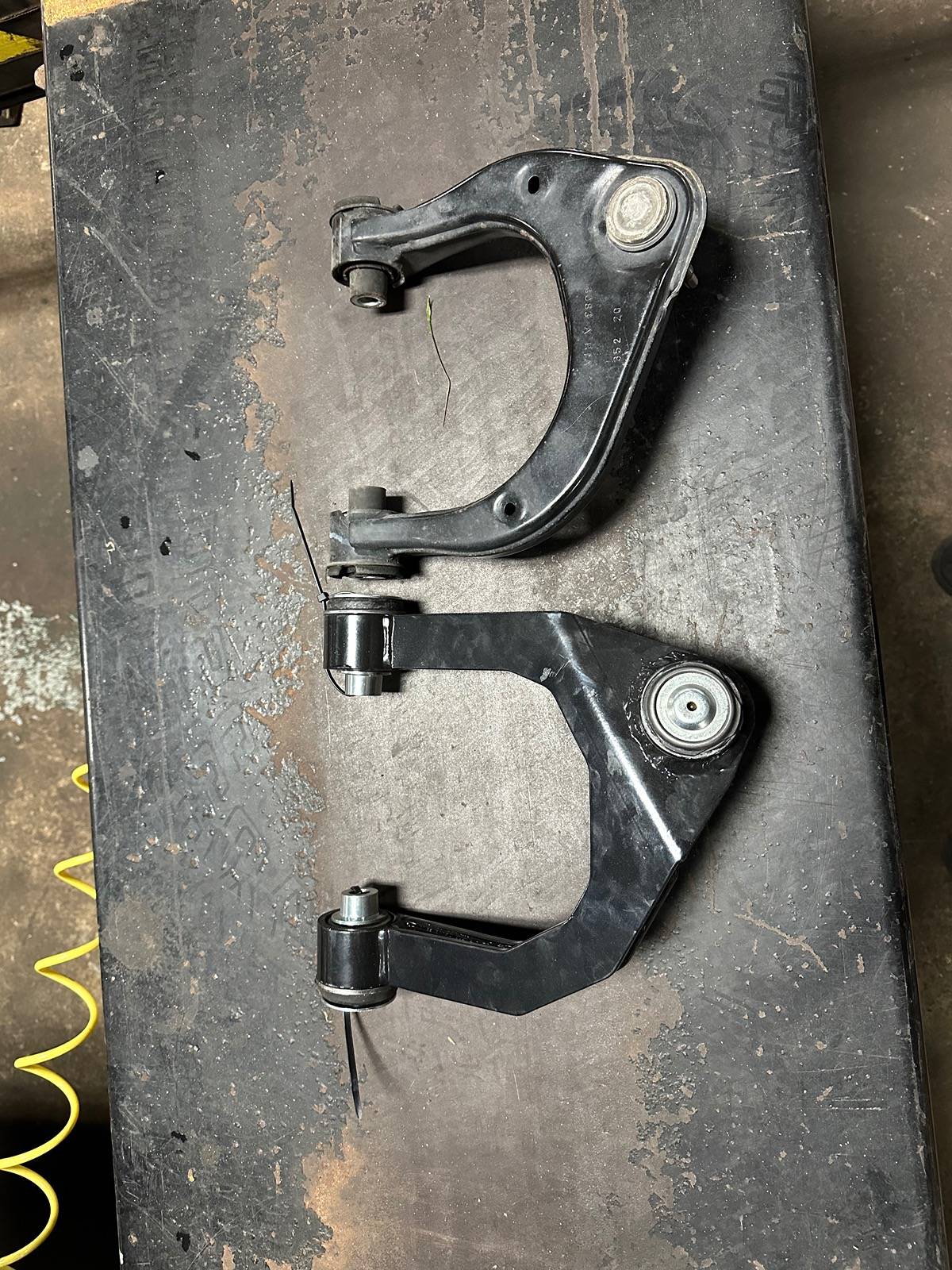

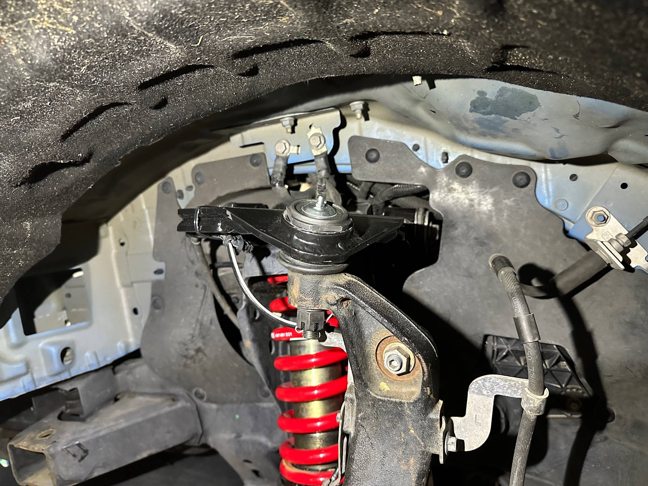

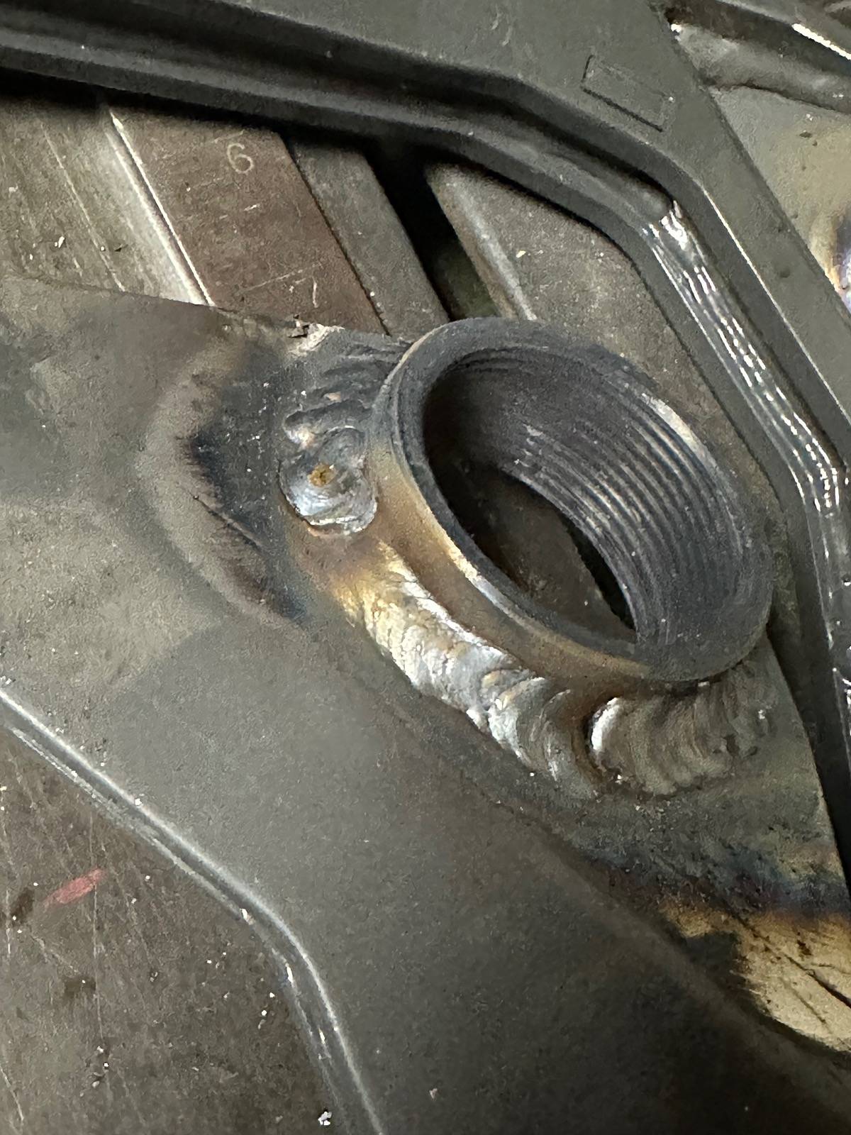

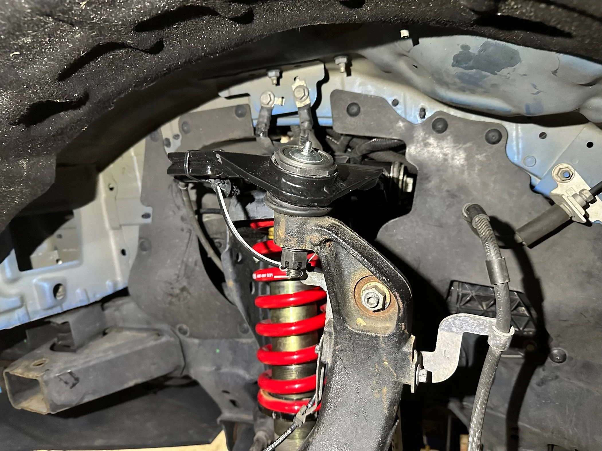

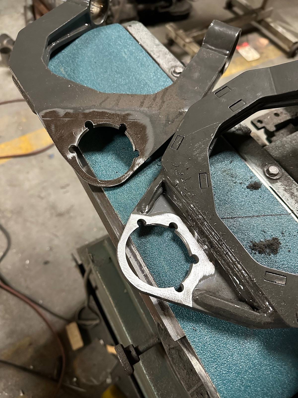

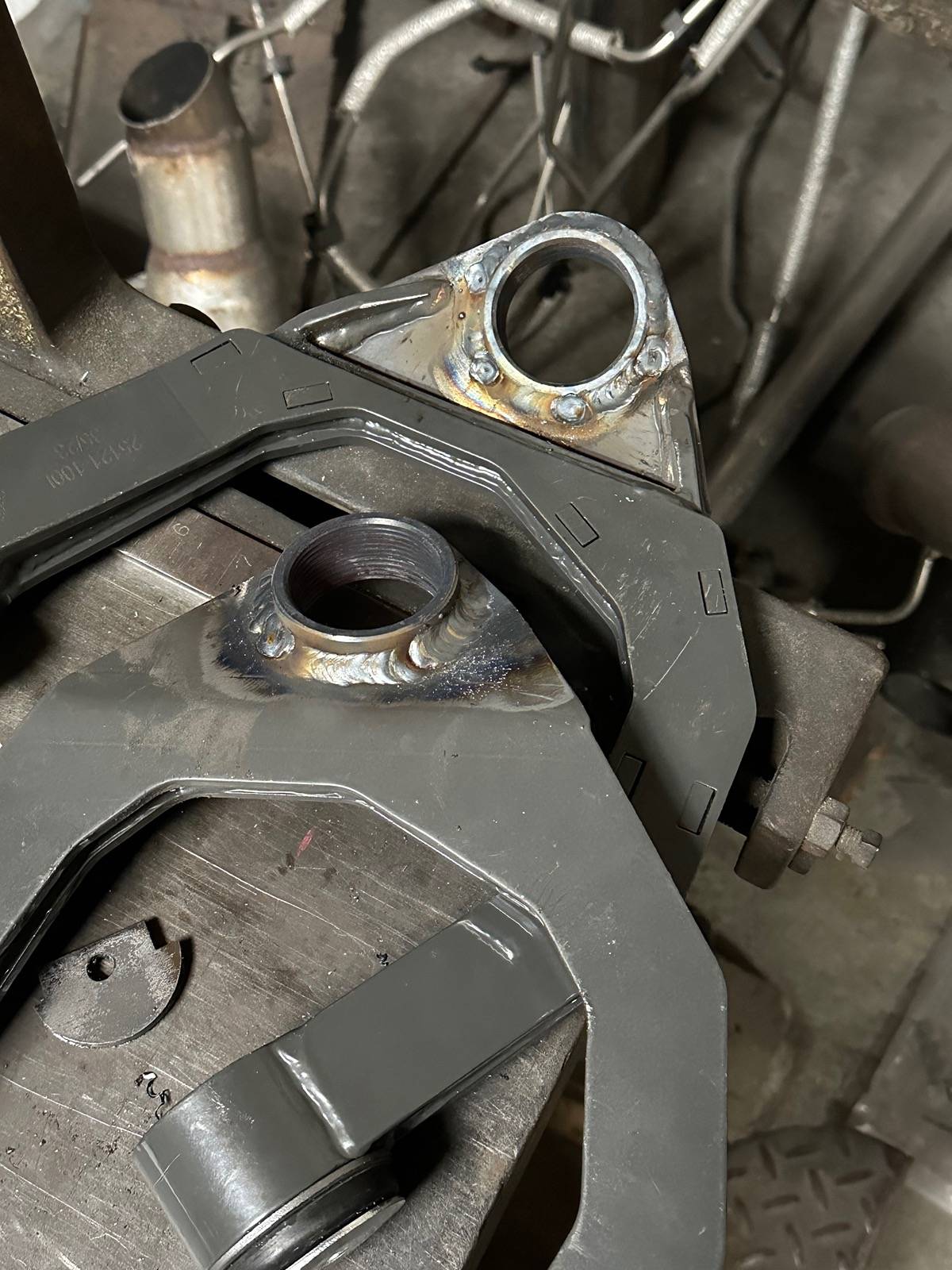

I welded threaded collars into mine to accept Mopar screw in ball joints, they fit steel knuckles perfectly and are cheap as shit. You just have to weld and fabricate a little ?
Mine now fit pretty well. I’m low enough that they slap the sheet metal above but otherwise they are great.
Thanks you for the pictures. Looks like you found the fix for Belltech arms. Unfortunately, outside my current skill level. I am more at 2 wrenches level and that looks to be 4.
It’s my area of expertise fortunately.
as bad as these hit the body I would say that the SPC ones would be worse. They also do nothing to correct the ball joint angle which is super bad as is.

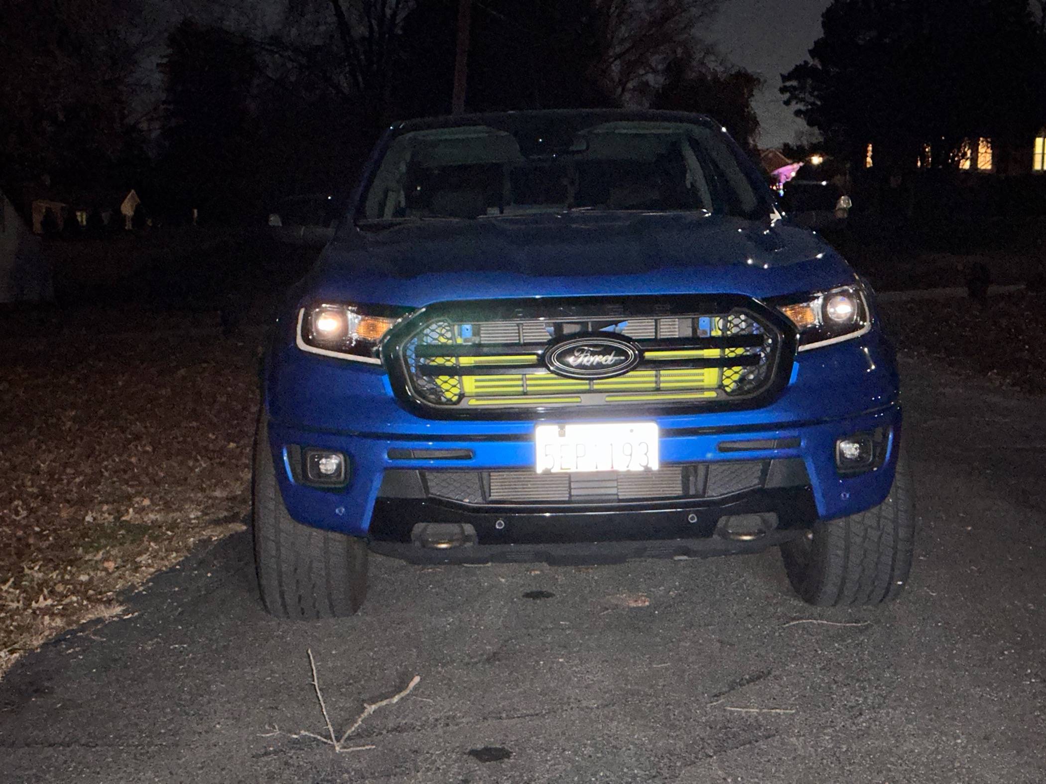

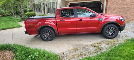

I did get my Ranger
lowered 2/5. My alignment shop was not able to get the truck with-in factory spec alignment. My camber is at -1.9” and my caster is at +4.8”. I was able to contact the Belltech Brand Manager and all she would commit was that they have plans on developing the UCA with the correct ball joint for the steel knuckles.

I did get my Ranger
Good luck with Belltech. Their customer service is terrible. I can't speak for other brands or models of truck, but they do not care about Ranger owners.

I did get my Ranger
That looks pretty good. I have had over-2 degrees of camber for a while and still managed to keep my tires wearing evenly. I now have-1 degree with the Belltech arms modified to fit but they are so noisy when they hit the fender liners on bumps! I almost want to put my stock arms back on.

Very Good !
