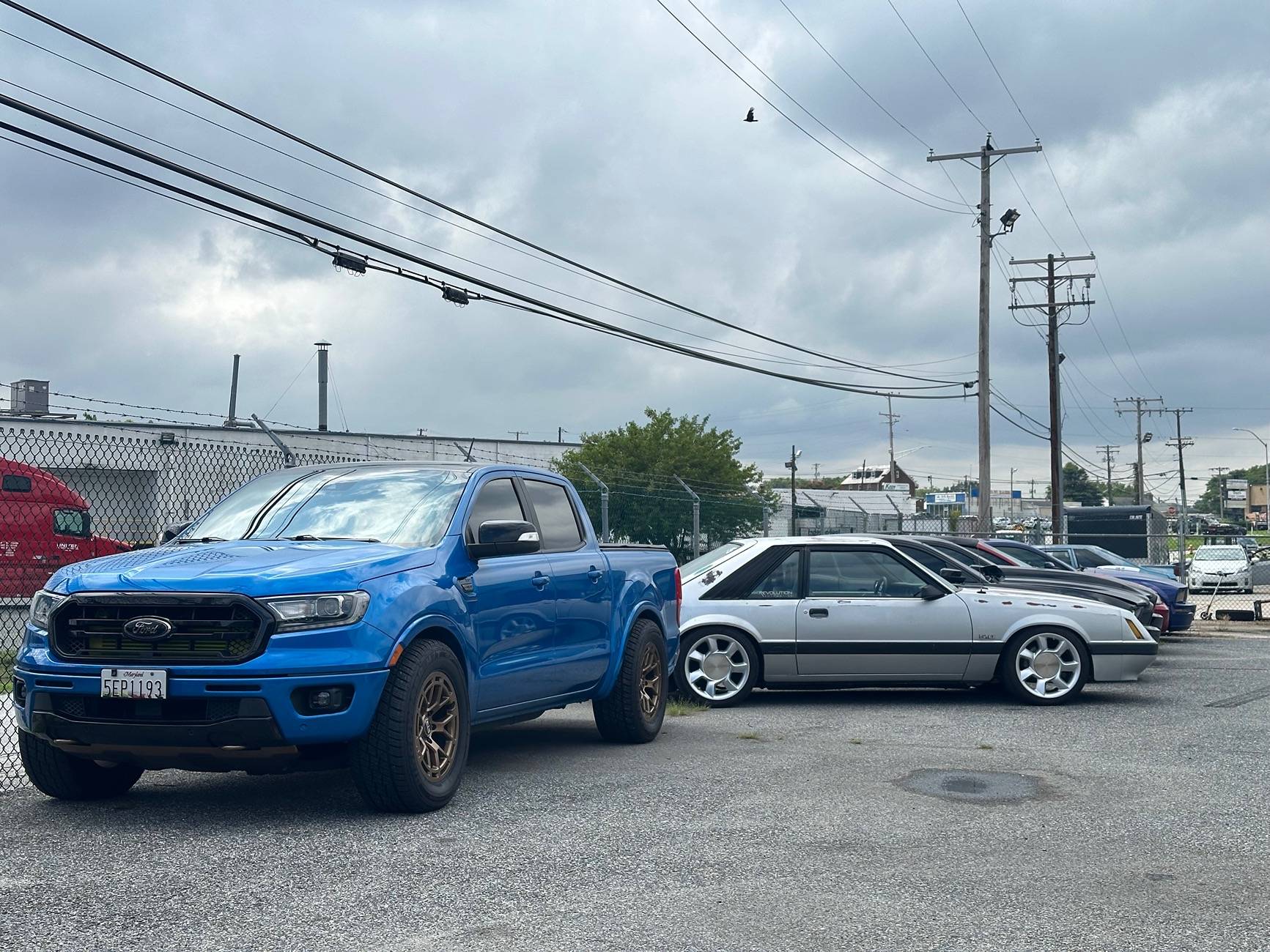

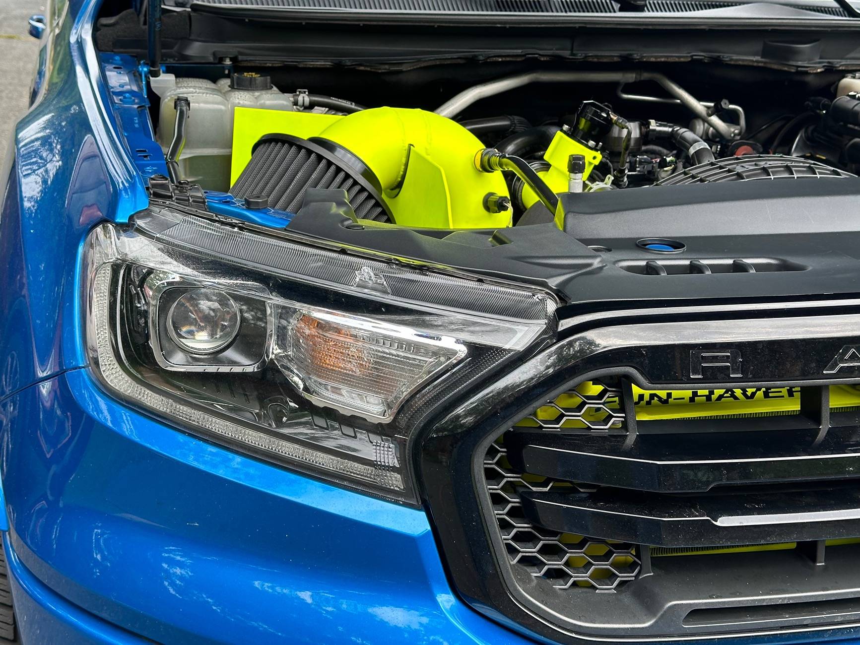

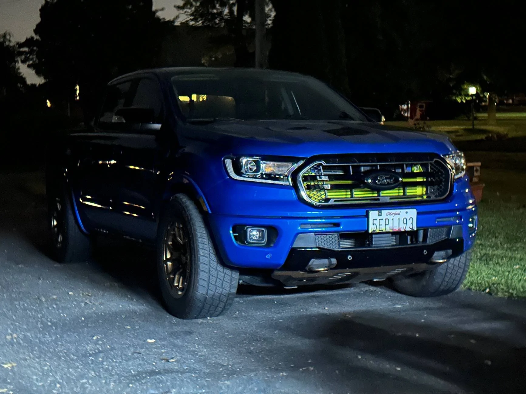

I have a lowered FX4 super crew with a little more than a tune.
Dude that thing looks cool. Little more than a tune huh? Is that a custom fab intake?
