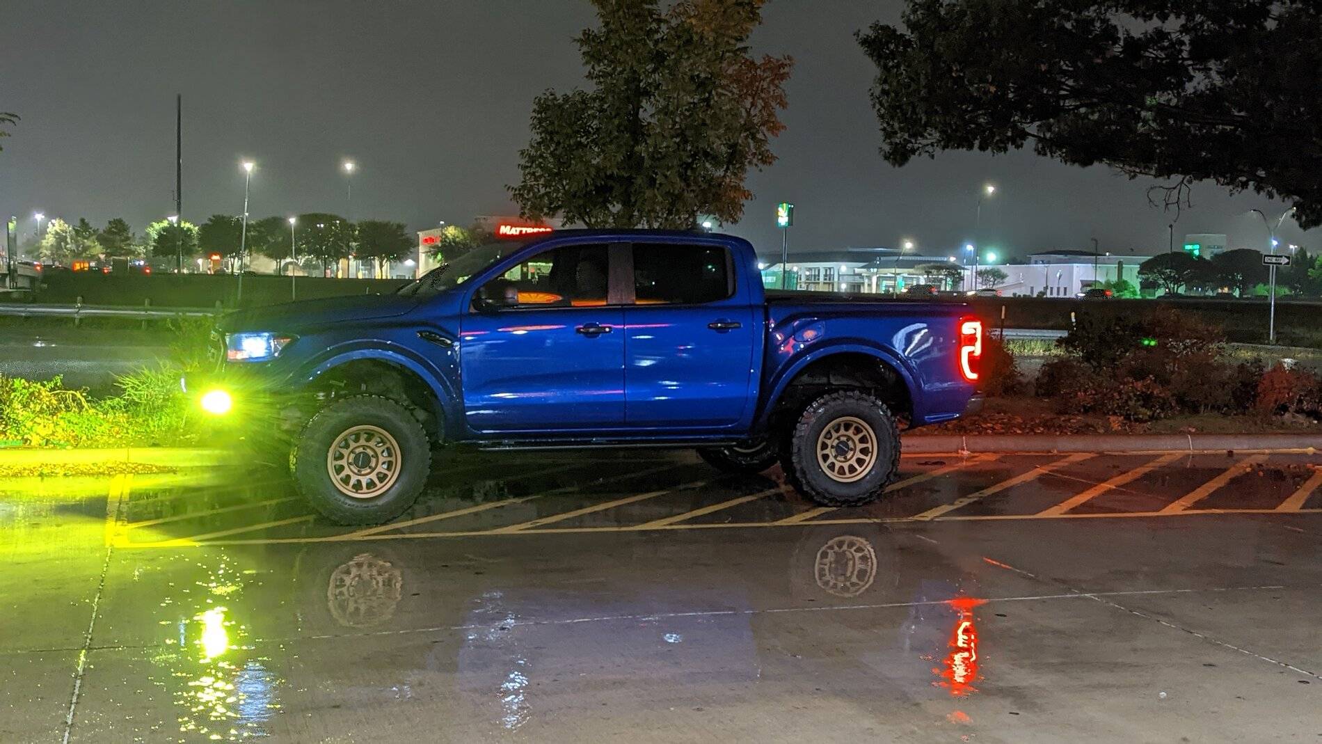

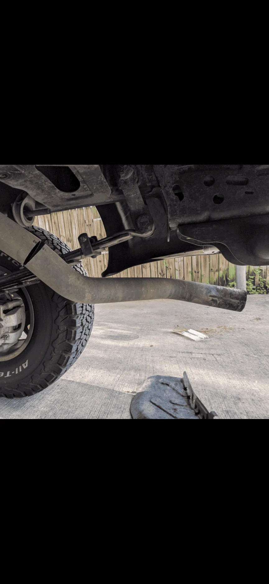

I raised my front end 2 inches by turning the collar on my coilovers, only because I didn't like the look of my rear end up so high. This is how it sits now.
I would like to put the front back down and only lower the rear what do you guys think about a longer shackle that is placed more back on the frame? Of course I would have to trim away behind where the shackle sits now but is that how it works?

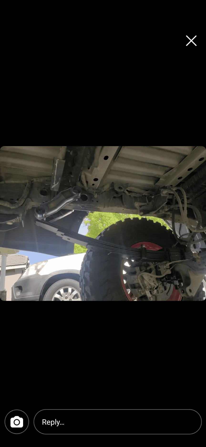

Ok so I finally read the whole thread I started this morning and it's now passed midnight. I noticed that I chimed in a few times without reading because I was probably somewhere and hopped on the site so forgive me for not reading from the top at first.
Has anyone done the 4 inch drop in the rear with the deavers?
It looks like the axle flip being referred is what I'm used to being call a spring under.
Anyway, I would like to lower the rear of my truck but I wouldn't want to compromise my travel, in fact even with leaf springs I could build a bed cage and utilize 18" of travel strapped at 17" with a 16" stroke bypass shock and a longer shackle. Like this guy.
Usually I'm used to a spring under using longer springs for even more travel with a bed cage.
I'm all about speed, but on and off-road so I need travel. Unfortunately I haven't seen a solution that fits me until I remove the bed and cut the frame from behind the cab and tube the back half and put some trailing arms which will be about 2 years, I'll set my ride height then.

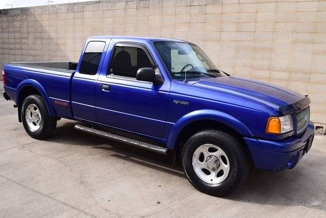

It's a bummer that market focus is on lifting and Jeeps. Not everyone wants a lift. Rangers seems to be a red head stepchild for some things, F150 or Silverado parts a plenty but Ranger is a lot slimmer of options or none at all.
Lifting seems to be the "in" thing right now, but I've never cared for lifted trucks and I live in the south, LOL! I much prefer to lower my Ranger and it won't be the first truck in my life, that's been lowered either.
What I really enjoy hearing is all my coworkers, (that act like they're helping with my payments), why are you going to lower it, you won't be able to haul anything in it? LOL! Like the trucks that are lifted 15" higher can haul anything in them? Like this monstrosity with this spoiled ass rich kid, in my town... I've seen it 3 times since August and it's just awful looking and it's pulling a ghost trailer, sitting still, to boot....
But anyway, I do prefer the lowered look of certain, not all trucks. My old '03 Ranger was a 4x4 and all I did to it was a 2" shackle/2" torsion bar lift, just to make it look like a 4x4, since I actually thought it was a 2wd, when I went to look at it...
I'm stepping down off my soapbox now...

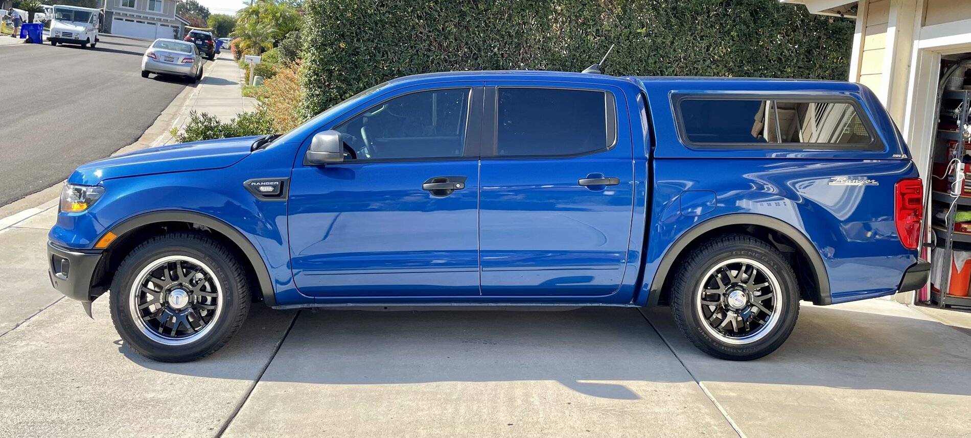

You dropped it 2.5" front and 5" rear, correct? Are your new wheels & tires a different size than your stock wheels & tires?
I preordered the new 3"/6" Belltech kit and I'm planning on doing that exact drop front and rear to mine.
Yours looks like it's lower in the rear than the front or is it an illusion?

Yeah, the topper makes it look that way.

Yea, I was wondering about that? I've actually been wondering if I should drop it 5 in the rear and leave it 3 in the front? I don't want it looking like it's squatting in the back, when I'm moving...

correct, 3” and 5”. New wheels and tires are different size than stock 255/65r17. New wheels are 18x8 +38mm offset with 255/55 tires. Went from 30 inch tire to 29 inch tire.
On the driver side the rear is about 1/4” lower (factory lean). As was pointed out, the shell(cap, topper) does make the rear end look lower because it is lower than the cab.

How did you drop it 3" in the front? I thought 2.5" was the most you achieved because of the stock control arms? Belltech doesn't have anything like that available, (well, they do, but it's not released yet) and most people aren't buying the CF drop kit?
Also, you smaller tire choice might be throwing me off a little bit too?
My truck has stock 265/60/18's +55mm offset on it. Planning to do the full 3/6 drop on mine, with 20x10 -24mm offset and 265/50 tires. I was messing around with tape last week to see where that drop would put my fender lips and on my truck, it looks like it'll still be slightly raked in the rear, by a whole 7/8" higher over the front end :)

Correction, 2.5” in the front. I went with the lowest setting available with this kit.

Cool! I'm wondering if .5" on mine will be enough to make it look any lower? Does your bed topper weigh the back of the truck down a lot or do you have anything in the back of it, in those pics, as it does look like it's squatting more in the back, despite what @Doc said last night, LOL!
Like I said last night, I just don't want mine to look like it's lower than the front, while it's moving, since it was sitting still when I mocked up everything with the tape last week and it was almost 1" high in the rear, over the front, assuming I got all my measurement correct?
