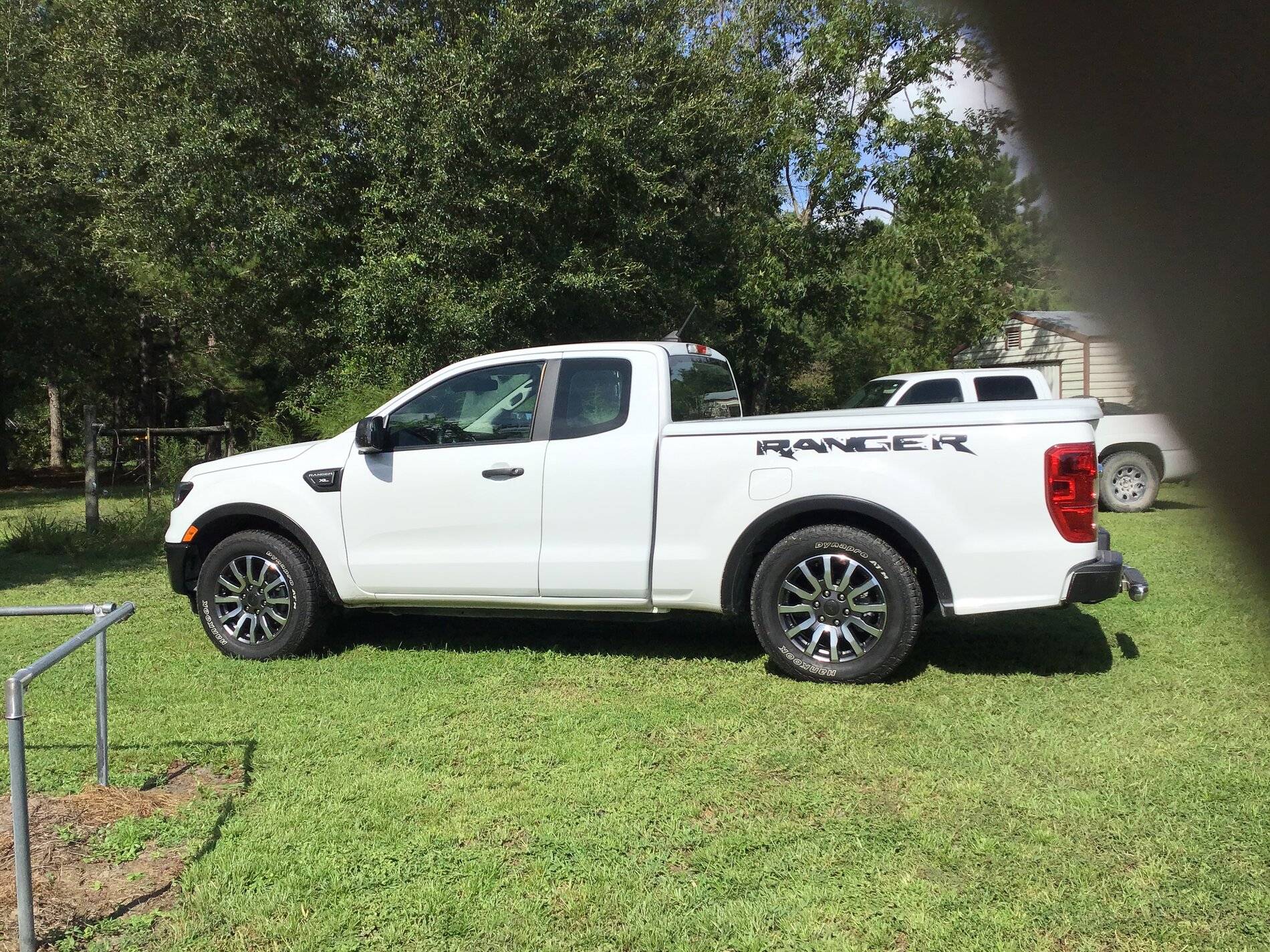

Finally got my wheel and tire experiment done! I am very happy with how the setup turned out. The wheels are 2014 F150 FX4 20" Wheels painted Magnetic Gray to match. I am running 1" thick BORA adapters to make them fit. The tires are 265/50R20 BFG Advantage T/A Sport LT. So far everything has ran well except for a bit of rubbing on the front crash bar at full lock. I may try aftermarket crash bars.
I have decided that I will do an inch lower in the front when Belltech releases their UCA. That project will have to wait until spring. Hoping the extra drop will fix the rubbing at the front.
Just ordered a LUND Elite roll-up tonneau cover and bed mat. Planning to tint the windows soon.
What did you do for your exhaust after lowering? Just cut off the tip or one of the dump exhausts?
You can see his exhaust in the 2nd pic, yes, it looks like he just removed the tip and put a dump pipe there :)
I cut the tip off right after the resonator. Planning to get a cat-back at some point. I will go with something short that dumps out in front of the rear wheel.

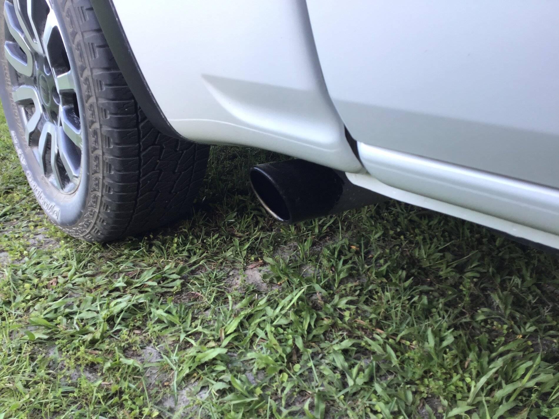

Thanks, thats 66F100 ! The exhaust tip is mine…
but mine is the dirty one in my icon picture ..:)
Thanks for the correction...you guys threw me off with the same white trucks...?
