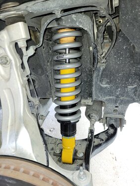

The ride is always going to suffer when you lower a vehicle. Five inch drop in the rear feels ok, but the 2.5” drop in the front is abrupt and somewhat bouncy. I am hoping someone will offer a drop spindle.
Not sure I agree with that. My DIY drop profoundly improved the front end.
Longer and softer front coils mounted lower on yellow Bilsteins.
Yea, drop spindles would be nice but there are other paths to the same goal.
That's nifty! How much lower were you able to go with that coilover?
Eibach springs!!! Are those stock height? I’m here to tell you the stock springs on Belltech lowering struts makes for an interesting ride. Wayyyy better than a lowered import car ride, but still not great.
They are 14", 550 lbs/in coils, just a half inch or so longer than stock, but nearly 20% softer.
Not quite as low as I'd like. I'm out of adjustment for caster & camber, have some adjustable upper control arms to cure that issue.
And, I'm looking for shorter front struts. With the softer springs, I land on the jounce dampers pretty hard at harsh railway crossings and the like when past 40mph or so. There are F150 and GM 1500 struts that might do the trick, but QA1 and Helix have adjustables that are on my radar.
I’m jealous. You need to post the final formula when you get it sorted.
